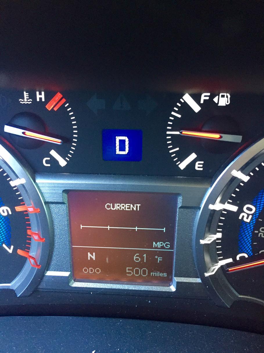

Today in my 2016 T4R I had the odometer hit 500 miles!

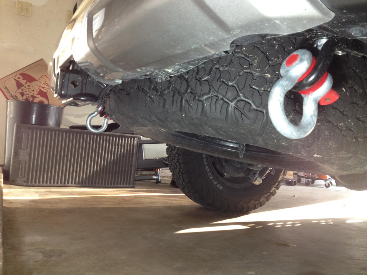

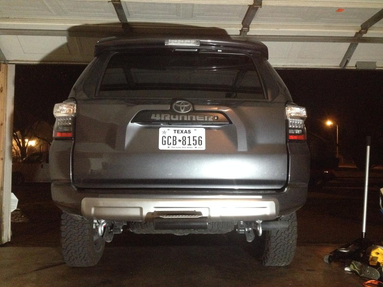

I ordered a 2nd recovery point from Toyota for the right rear corner of the frame. It's the same piece used for the left rear recovery/anchor point. The threaded holes are already there above the tailpipe. Cost is $139 with 2 bolts and 9% CA sales tax. The exhaust tailpipe will have to be rerouted to clear anything I put on the recovery loop. I may shorten the tailpipe or turn it sideways behind the rear tire.
did this a few weeks back, if it's not too late check partznet.com, they have the loop (51095-60030) for $72.72 and 2 bolts (91642-81235) for $3.52. i think all in it's about $90

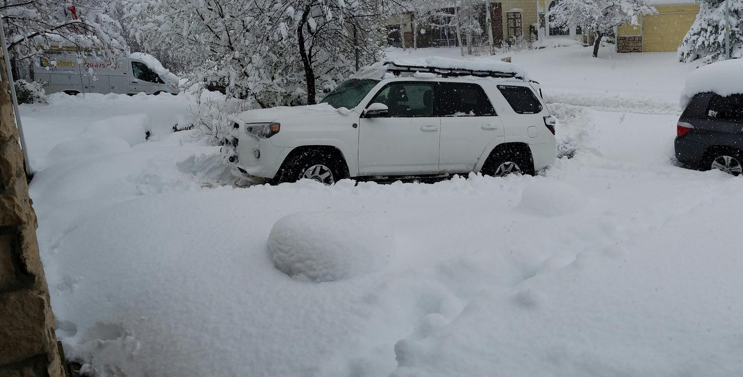

Watched the snow pile up and a Corvette try and drive through it.
