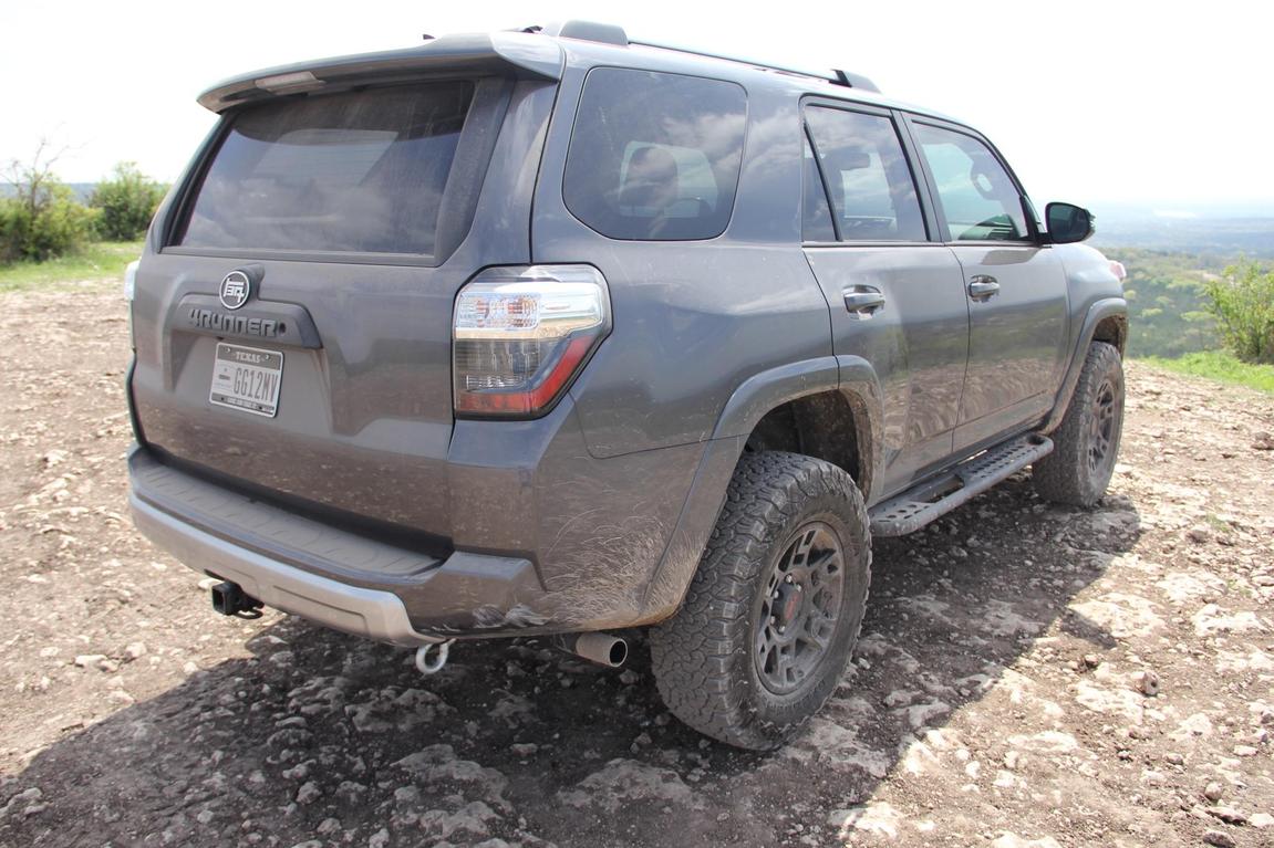

got my first trail rash on Saturday! (lower pass corner of rear bumper cover)

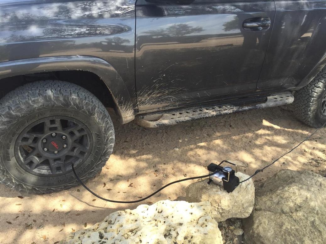

got some funny looks from this 2nd pic, I call this The Little Compressor That Could (Viair 70P). Since Hidden Falls compressor was down i had no alternative but to spend 5+min a tire just to get from 24 to 38 psi. i was afraid if i dropped too much lower than that going in i might burn the compressor out
