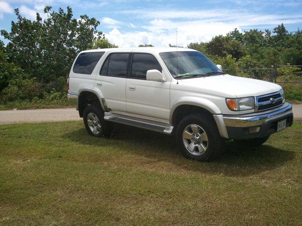

Today - Used a clay bar and wax cleaner to remove all the dirt, debris and finish from the paint.
This week - Will be wet sanding and buffing the rougher areas of the paint before polishing and waxing later in the week.
Also want to refinish the roof rack, but haven't decided how best to do that yet. Suggestions are welcome.
You really should have clayed, cleaned, and waxed all in the same day. Over the course of this week the paint is going to pick up some dirt.
I just painted my rack today. I used Dupli-Color Trim Black. I got it at AutoZone for about $7. I would highly recommend taking the entire rack off before you wax. If you don't then wax is going to end up all over the rack and stain it white.
To remove the rack you simple remove the end caps (four) by removing four screws. Then you can slide the cross bars out. Then there are three more screws per rail to remove. You will be amazed at how dirty it is under the rack.
When you go to install the rack again make sure you put some clear silicon in the holes and on the threads of the bolts.
I would say from start to finish it will take about 2.5-3 hours including letting the paint dry.
