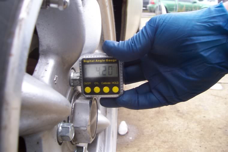

Camber gauge TOOL thread: What accuracy needed to DIY alignment & what tool at ~$250?
To check camber before & after taking the vehicle to the shop to be aligned:
Q: What accuracy is needed in a home DIY camber tool?
Q: What tools are available that achieve that accuracy at home?
And would you recommend the camber gauge shown in the FSM?

If you are looking for something to actually set your alignment perfectly, they do make specific tools for that but I have never used them myself to recommend one over another.
I used a piece of wood across the wheel and an angle finder

I saw many camber DIYs similar to what you suggest, where the user measures the offset of the 12 o'clock & 6 o'clock positions of the wheel with respect to a line perpendicular to the ground, and then uses trig to calculate the angle based on the distance delta.
The good news is that available measurement technology is constantly improving. For example, just as you described, this camber DIY used a block of wood & an iPhone as the measuring device.
The key question is what accuracy is needed ... and what accuracy can be obtained?

For example, this camber measuring tool mounts on the wheel:
And, this camber measuring tool mounts on the rotor:
With or without new tires, this thread is posed to ask what camber tool is available today that will do a good enough job at a decent enough price.

The camber spec for my 4Runner is - ¼° ± ¾° which indicates, I think, that all we need is roughly about ½° accuracy in the home alignment camber tool. (Is my math correct?)
In fact, I think that's why a plumb bob worked in the Yodatech home alignment DIY (i.e., 0°).
Since you bring up the great point about accuracy, may I ask:
Q: What accuracy do we need for camber measurements on our 3rd-generation 4Runners?
Q: Does at least ½° accuracy seem reasonable to you?

The good news is that we can use the camber gauge again and again and again, which makes its ultimate cost about 1/10<sup>th</sup> the original cost, which is roughly about $25 per use over time.
you're probably not going to get it measured correctly down to .25 degree
Accuracy is definitely relevant.
What 'accuracy' do you think we need, given the spec is - ¼° ± ¾° (and given that one wheel may be grossly out of spec)?

I) Accurate enough (how much accuracy do we need given Toyota specs are ±¾°)?
II) Cheap enough, i.e., roughly under around $250 (which means the cost per alignment is about $25 assuming it will be used ten times in my lifetime)
buy 2 new tires and then align.
That's a different issue than what tool to use. That information will eventually be useful for the upcoming first-ever Toyota-4Runner.org 3rd-gen garage alignment diy. :)
find a shop that specializes in frame repair.
The point of this thread is the tool. May I ask if these are the key specs we should strive to satisfy?
a) Somewhere around ½° accuracy?
b) Somwhere less than about $250 in cost?

There are lots of ways you can measure camber, you have to decide which way is best for you at home (meaning which can you get the most accurate, reliable measurement with)
Don't assume this is possible. Less than 1° accuracy is decently tight. it's nothing for porfessional equipment, but that is way out of the price range, and since not many people do their own alignments (like nearly no one), there isn't much market for at home tools for it.

1/2° is probably acceptable, but I doubt that you can really achieve that in your driveway. You may be able to "measure" within 1/2°, but that will be with an unverifiable, un-calibrated measurement system.

b) About $250 in cost?
You cannot meet the 1/2° accuracy because you cannot verify it. You may be able to get it acceptably aligned, but you cannot make any statements about X° accuracy. If you understand wheel alignment, your measurement system, etc. then you can take the risk upon yourself to do your own alignment in your own way, but you cannot write up a DIY saying that your method works, and gets the vehicle within spec.
you need guide plates to allow the tire to set in a neutral position.
aswell as a way to properly connect the caster/camber gauge to the wheel. generally a wheel clamp is used. these parts are very expensive. i think the wheel clamps are around $250 each.
for the price of the correct tools, you would be able to purchase a dozen alignments. not to mention, even with the tools, if you dont know what you're doing, how do you know the ends results will be what you want?
Hmmmmm, that was a much more succinct way of saying what I said... I think I wasted 15 minutes of my life typing...
also, having a tool with 1/2* of accuracy wont help. it needs to be correct.
if you have a 1/2 to play with, and the vehicle allows 1/2 for its specificed range, you could be a FULL degree out, if they both end up being "off" the same direction.
or you could have one side off 1 degree to the positive, and the other side could be off 1 degree to the negative.
this is BAD, and will likely cause a bad pull, aswell as excessive tire wear.
a driveway alignment is a bad idea. unless its just to get you to the shop to have it done correctly.
alignments are cheap compared to tires.

i use the a string stuck to the ceiling with a bolt tied to the end. Hang it about 6" from the wheel in the center. measure the distance from the top edge of the rim to the sting then the bottom edge of the rim to the string. Use the difference combined with the distance apart. say you have a 1/4" difference and a 16 inch rim you can solve for the angle with some basic trig. after a little math your left with .89˚ and then you can adjust from there. using the alignment chart in the fsm. I just let the caster go. It only effects the recentering of the wheels not tire wear. Camber is important to me.
I did this awhile back in my garage and after a few thousand miles the tire wear looks real good.
I know! I know. Googling, I find PLENTY.
But I've never done an alignment. I prefer to take my cues from the team, many of whom must have done an alignment or two themselves. That's why I ask the question! (Note: You know as well as anyone, people get mad at me when I present 'research' on the web.)
Hmmm... That sentiment does confuse me. For example, if I set my camber to 0° with a plumb bob, that's probably good enough (because it's within specs). Of course, I'd like to do better ... ... and I'd also have to check other alignment criteria ... but it sure seems 'possible' to me to get the camber within spec.
I'm assuming some of the tools give me at least ½° accuracy & repeatability. But, again, I want to hear from others first before buying the tool and finding out for myself.

So far, we've established an accuracy goal of ±½°.
As you point out, it is 2012. We have the internet. Opinions on businesses are so readily available, that you can probably fine reviews of just about every business out there. You know this. Start there, and find a shop that has mostly good reviews, and give them a shot.
The other thing you can do to make sure the work is done right is to request the print out of your before and after measurements. Marking is fine, but you don't know if either the old and new is within spec unless you have the printout. And it makes sure that they at least have to adjust it to an in-spec measurement.
As far as the accuracy, no, measurement technology hasn't gotten so much better in the last 20 years that you can accurately do at-home alignments. Rulers, angle gauges, and plumb lines are pretty much the same as they have been for a long time
My whole point on the accuracy is that you don't have a measurement system that can give you any kind of gauging of accuracy, so just stop talking about it. And on top of that, when you say that you can watch them do your alignment and not really know if they are doing it wrong, that just emphasizes the fact that you don't have the expertise to do this properly on your own. Again, that's not an insult, there's no reason for you to know this stuff, but again, please listen to the guys here that are experienced in automotive work, and are engineers. If their consensus is that it is a much better option to have a shop do it, then be open to that. I won't tell you to just heed our advice and give up on it, but actually consider it, and if you are going to continue with it, be sure that you fully understand the issue.
