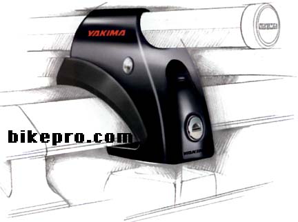

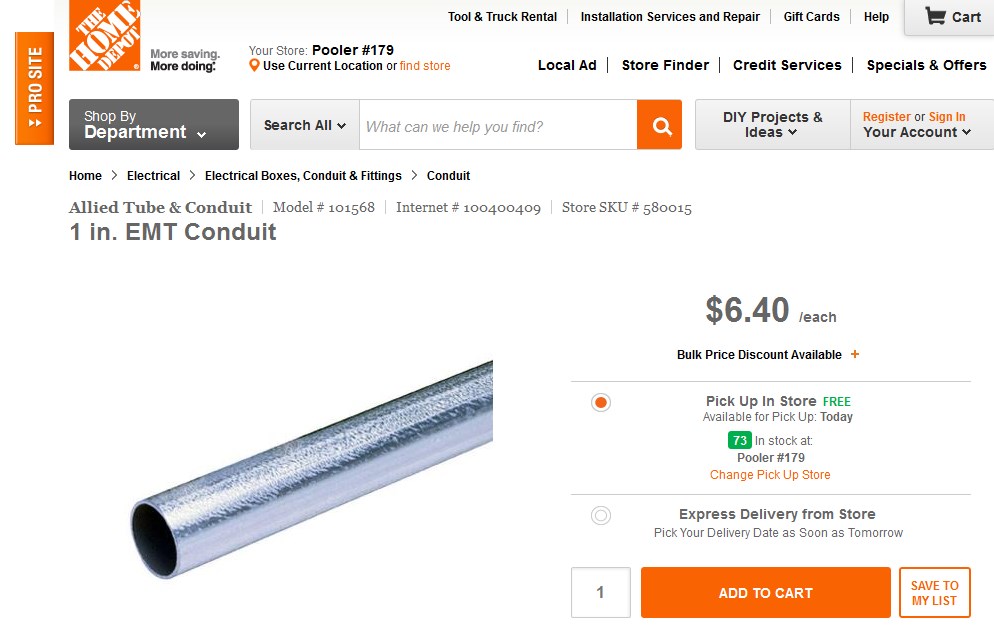

This seems like a no-brainer, but I would like to know if anyone has tried this.
Get the Yakima doublecross towers, used for about $80. Head to Lowe's and get a couple sticks of conduit (EMT).....
Bam! You've got kayak racks of whatever size width you decide for less than $100.
My ultimate goal here is to haul two Lifetime Payette 116s face down on top of my rig.
And to be a tightwad about it. :thumb3:
Seems bueno if nobody else will say it ! I'd wrap it with black duct tape just my IMO
Thanks man. I've actually given that some thought too. I went ahead and bought the towers online. As soon as they get here I will test fit the conduit and report back. If everything goes well, I'll also post some pics up. If not, I probably won't. :peep:

My load bars have a diameter of 1.11" and EMT OD is 1.16" according to any of the charts that you can find online. So, with tolerances these might fit, but will they be strong enough...

Where did you find this conduit at a thicker guage, if you don't mind me asking?
Home Depot... It's the same stuff you are looking at. The thickness is the same as WMW was using for his racks. I bought some mounting feet from him to build my rack.
Ok, thanks. We don't have a HD here, but our Lowe's should have the same thing.
I've read where some people use gas line piping that's a little thicker. I would have to ask around to see where I might find something like that locally. I'm pretty open to possibilities since it will probably be a couple months before we take them out again, I'm sure. Thanks again for the info.
Having Fun mentioned he used IMC in his build thread which is a larger diameter and thicker wall than thin-wall EMT. You may have a hard time with 1" IMC fitting in the Yakima mounts.
You could try 3/4" IMC which has an OD of around an inch and would have a thicker wall than 1" EMT.
Still don't recommend it (my disclaimer :hatsoff: ) but be sure and take a caliper with you to the store to measure the OD of whatever you purchase.
