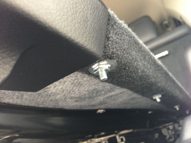

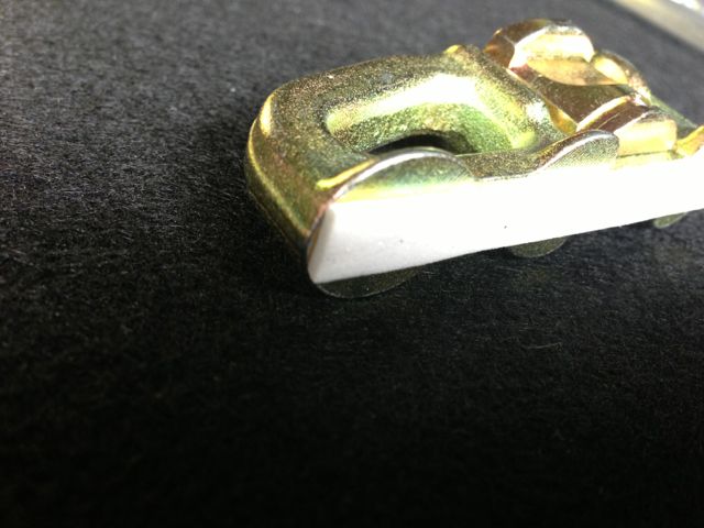

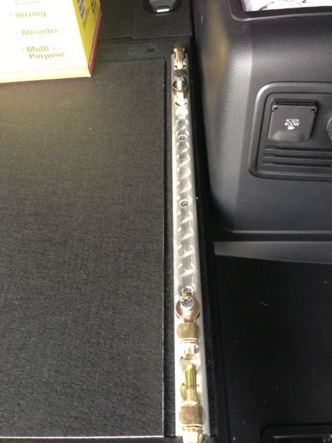

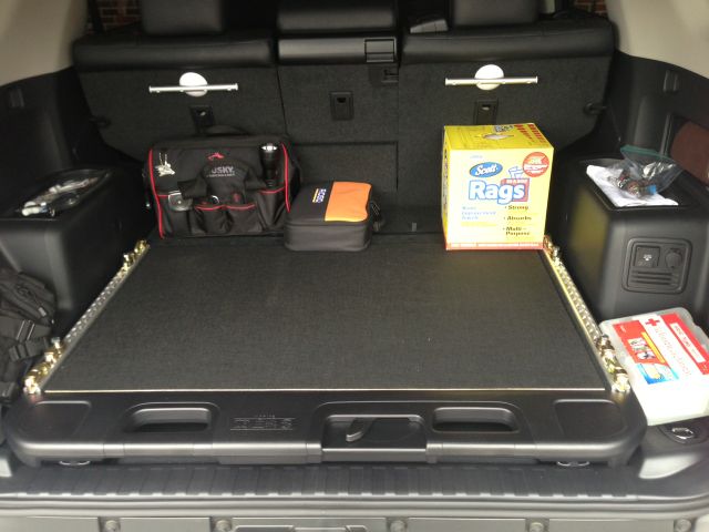

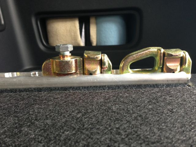

Just another cargo mod.
Got the L-Tracks from US Cargo Control.
a.) 24" L-Track (2)(AT24AL)
b.) Double Stud Fitting with Large Opening (4)(1519-DSR)
c.) Double Stud Fittings w/Bolt Thread (4)(1519-EBF)
Went to Homie Depot and got three packs of #10-32 x 1-1/2" Machine Screws with nuts (5 per pack)and got the washers separately (aaa)(12). Made sure to put some foam on the bottom of the stud fittings to stop the rattle. http://www.toyota-4runner.org/images/smilies/smile.gif
