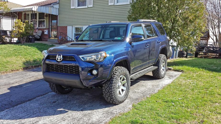

Just did same thing with tires. Swapped out stock for duratracs and really haven't noticed any big difference in the weight of tires. Truck really does still drive the same. After pushing in the liner I had to trim about 1/2" of the very end of the fender. the edge of the lug just hit it on full lock in reverse

That looks AWESOME. Nice job. What lift did you go with?

Dang, really have me second guessing getting the white!! That blue is dead on. Not too bright, light, dark etc. On a sunny day, wow.
