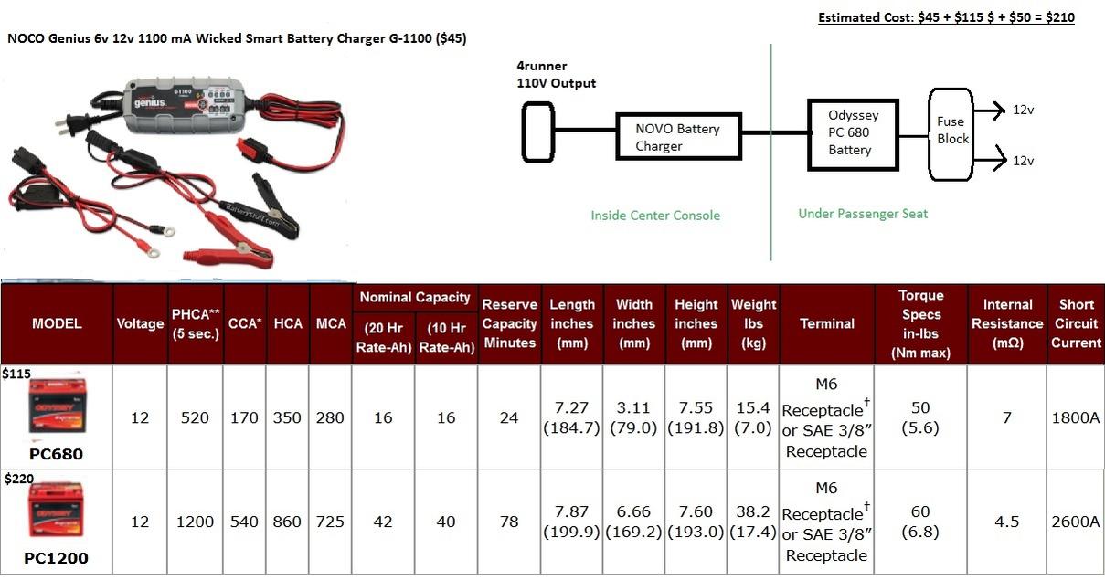

Dual Battery Alternative Solution
Hi,
This is not a perfect solution but it could be an alternative solution. There are so many smart battery charger in the market, meanwhile, our 4runner can provide 110V AC power inside the vehicle.
Would the following diagram provide an alternative solution (not a very good solution but very simple setup and cheaper) ?
Please comment about this.
p.s. Known constraints are : (under passenger seat storage for battery fuse box are not good)

No offense but this seems like the worst idea yet. You can't just have the battery and fuse box just loose in the truck. Also you can't count on the clamps holding onto the terminals with normal vehicle vibrations. Those things will be flopping off all the time. You need to put that battery in a box so other loose item in the vehicle don't hit the terminals.
With plenty of room under the hood why wouldn't you just put the battery and fuse box there?
In my opinion, this solution (cheapest & easiest) is not worth doing at all. It's not safe and will probably cause more problems and inconvenience than its worth.
Edit: Do you really need a second battery at this point? There are plenty of people getting by just fine with one. Maybe consider just installing a fuse block on your single battery and wire it so it's only getting power when the ignition is on. Pick up one of those portable jump starter packs for emergencies.
Dual Battery Setup
Thank You thank you.
The reasons why I need the dual battery is to power LED lights, small accessories (cell phone, dvd player, laptop...). Those are the things for camping/road trip for 3-5 hrs usage (engine off) a day when I stay in campsite. Certainly, the aux battery can be a back up for the main battery in case of emergency.
With you guys valuable ideas and practical on the road experience, I will go for battery, isolator and fuse box installation inside engine compartment!
