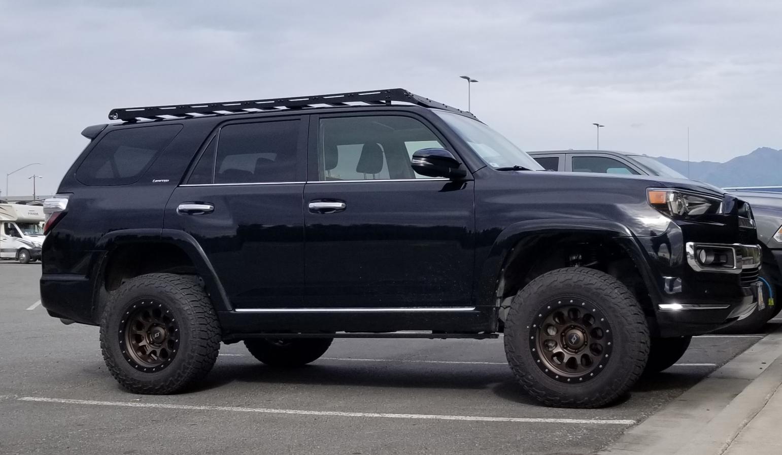

Any 5th gens on here running the new(ish) Kenda Klever 35x10.5x17? Good reviews so far, plus Walmart has them for like $750 out the door after tax and some Tacoma guys seem to like them.
Would love to see some pictures if anyone has them.

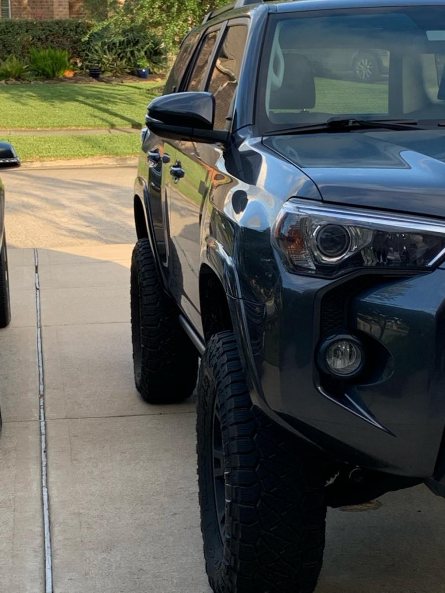

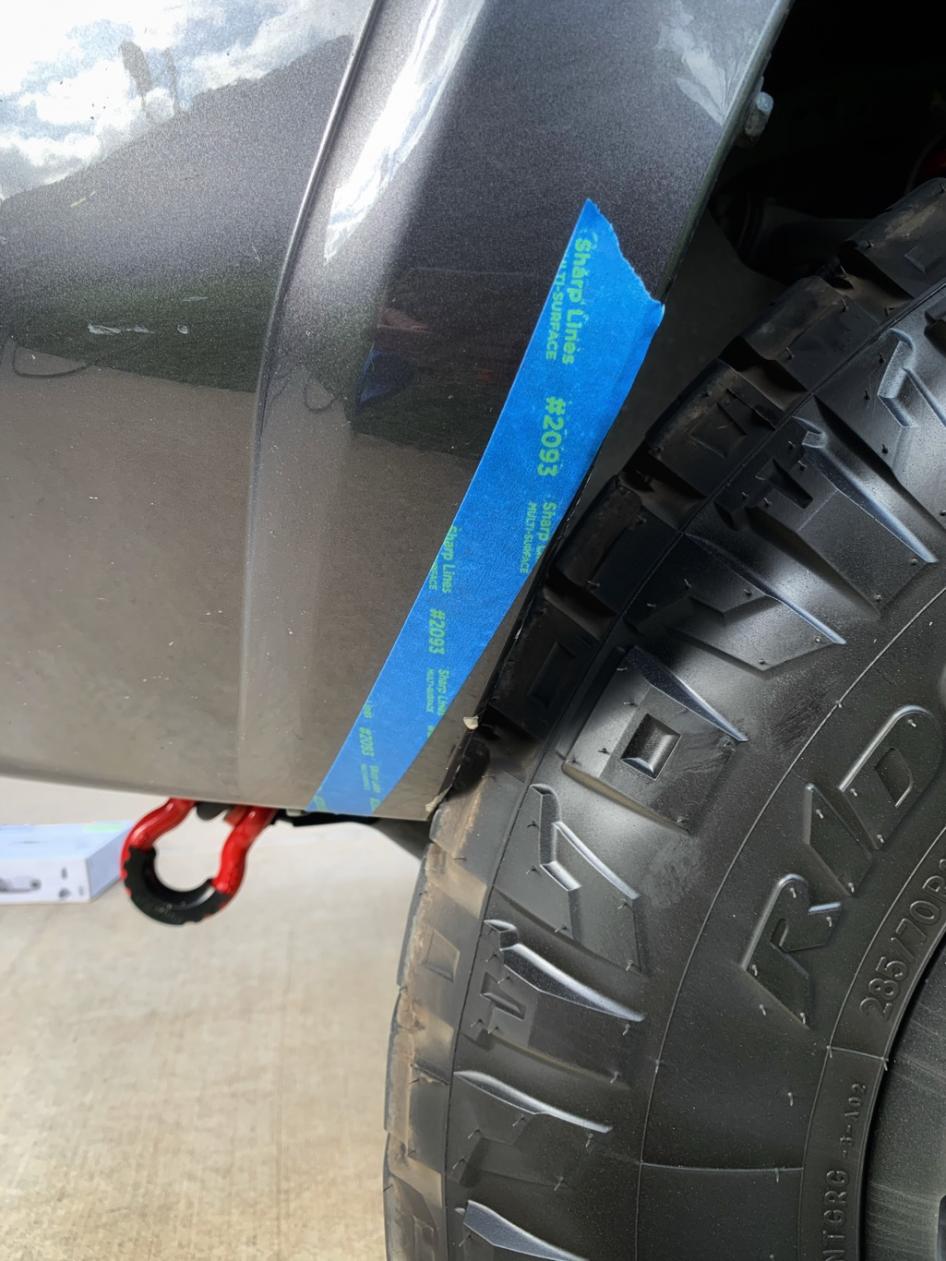

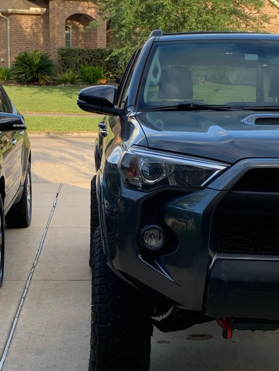

hey, by any chance, do you have a front or rear photo that shows how far the tires stick out from the sides with the -38 SCS wheels?
2019 TRD ORP Non-KDSS
Wheels: Stock 17” TRD Pro wheels with 1.25” G2 spacers
Tires: Nitto Ridge Grapplers 285/70/17
Speed Rating: 116Q
Load Range: SL
Suspension: Front = Bilstein 6112 with medium duty springs, 3” lift / Rear = Bilstein 5100 with Bilstein heavy duty springs, 2” lift
Body Mount Chop: None
Tire rub: Before installing the wheel spacers, it only rubbed when backing up at a hard turn. With wheel spacers no trimming wasn’t an option.
Front Bumper: Trimmed about 1/2" on the lower corner.
Fender Well: slotted the bolt holes and pushed forward about 1.5”.
