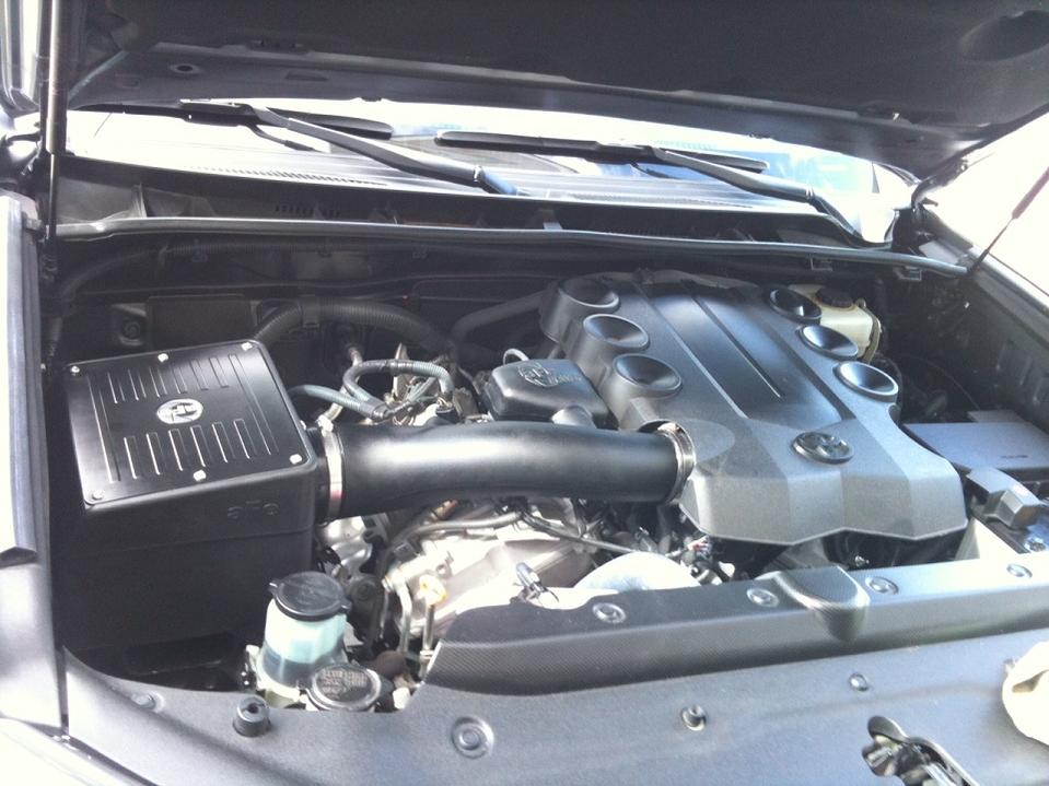

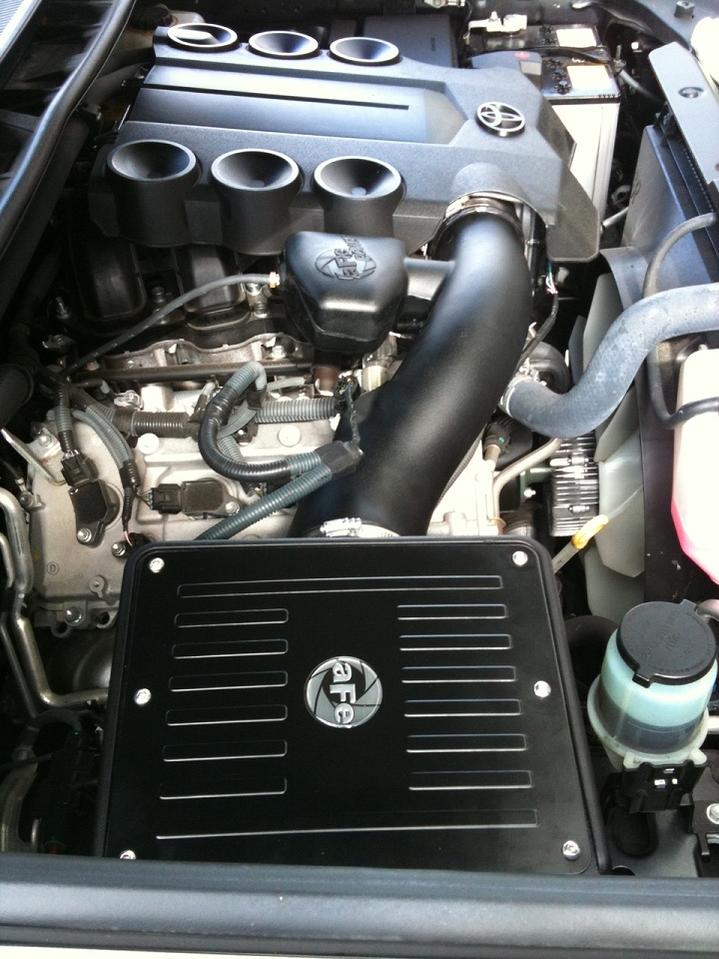

Installed my aFe CAI today...
So I just finished up installing my aFe CAI. I am most certainly no mechanic, but confident in my ability to turn a screwdriver.
The install is not difficult. I took my time, read the instructions etc and it took a little over an hour.
The two things that caused me the most grief:
#1: getting the box to line up with the holes in the frame. Had to move my stock horn (easy) so that the box could fit properly. (this is noted in the instructions) (Next mod...replace the horn!)
#2 installing the MAF sensor on the tube. Had to break out the dremel to make the hole just a little bigger so that the sensor sits flush next to the foam gasket.
Other than that, it was quite easy and the instructions were right on the money.
Took it for a quick spin. Not much different at slow speeds (didn't expect anything here), but can definitely hear the deep sound when you hit the gas.
MPGs - too early to tell and not counting on any improvement
More HPs - still too early to tell. Need to get it out on the hwy and open it up
Worth the $$$...well for the new sound YES...but I also had some $$ burning a hole in my pocket and wanted to do something under the hood that I felt capable of doing.
Will report back after a few tanks of gas with performance and MPGs.

Sorry for the stupid question, but I see in these pics that the seal at the bottom of the box is not installed. My question is...should the seal be installed if you don't have a snorkel? If it's not installed, doesn't this draw warm air from the engine compartment?
Thanks for any help.
