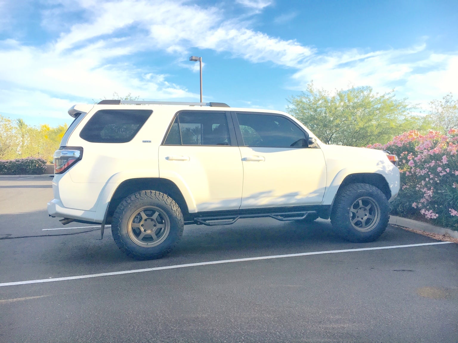

Installed 5100's all around yesterday with fronts set to 1.75. Couldn't be happier with the setup and the improvement over the stock setup. Also - I now have 0 rubbing whereas before I would have some rubbing at full lock in reverse
Is that white or concrete color?

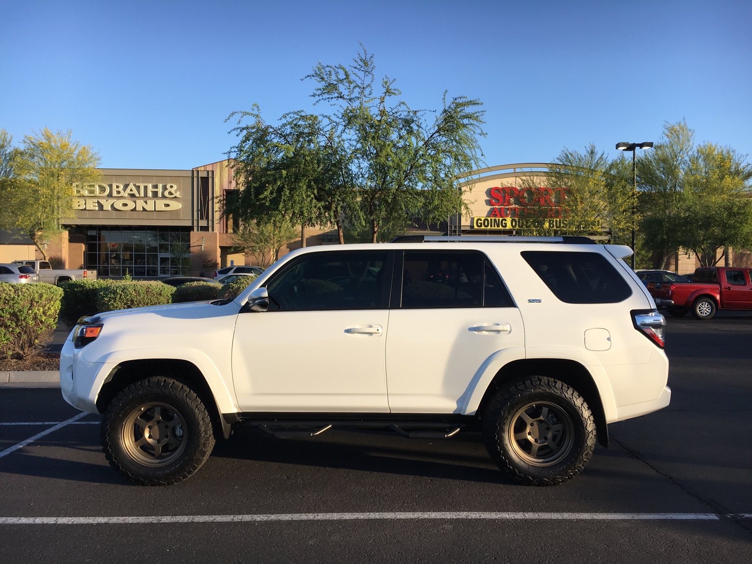

you got more pics?.....sideview?

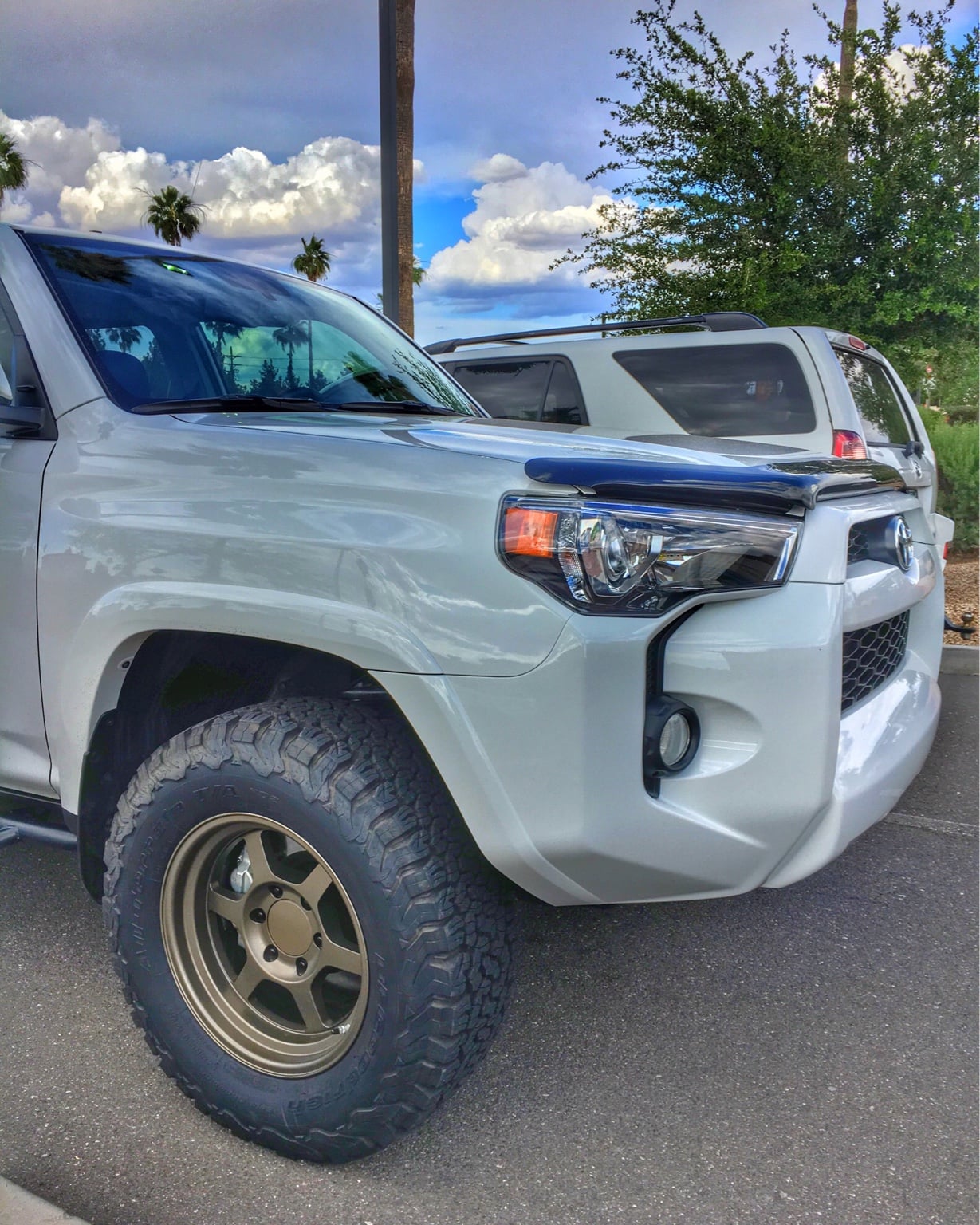

A better sideview
2016 SR5P 4wd - FN wheels countersteer X - 265/70 BFG KO2 - Bilstein 5100 (1.75 setting) - NFab side steps - TRS Morimoto 4300k HID kit - NOKYA yellow fogs & DRLs
