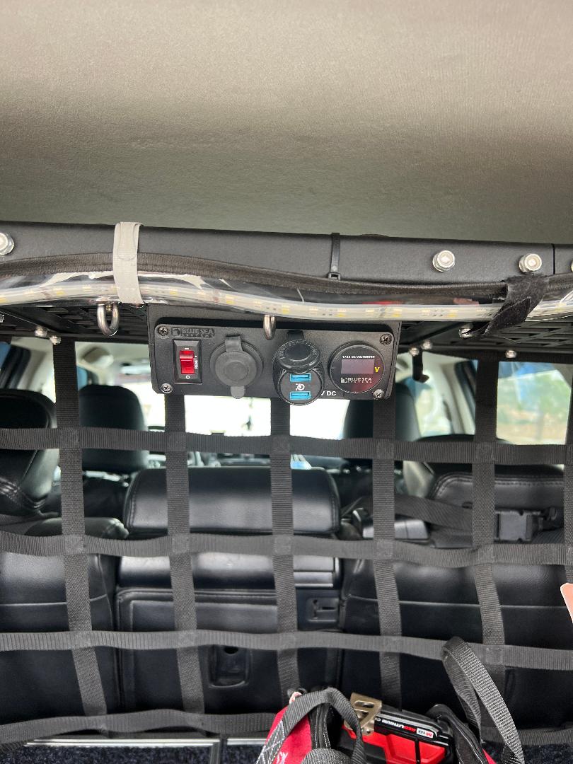

easiest way for me to do this was run the ARB fridge wiring kit from battery to a marine socket panel (kill switch, 12 volt meter, USB, and cigarette plug).
Using the ARB fridge wiring kit made it really easy, no splicing, no guess work on fuse placement, all wiring and fuses included, etc.
Then attach whatever accessory socket panel you want to it. You can go super fancy or super simple. Again no splicing or anything.
Here is the pic of mine, but yeah all i needed was the ARB wiring kit and a panel.
I did not wanna hack into existing vehicle wiring.
This is awesome! This is what I want. Thanks for sharing!

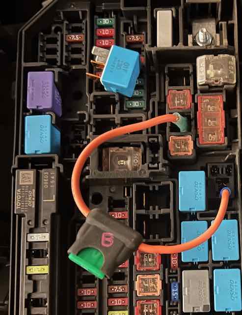

This is what I did, Cig lighters and USB power all the time
Hey Turbo, can you please explain what you did here in that pic. Looks like you pulled a diode from the fuse box, what is it for and did you replace it after?....Thanks Jim
I found it online somewhere searching how to have constant power, I’ve had it for about 4 months with zero issues.
Basically built jumper from hot source to dc power circuit.
So you don't know what that blue diode is for in the top center of your picture? assumed you pulled that to use the power source for the jumper?
Am going to have to look at my manual now to see if can figure out what that is.
