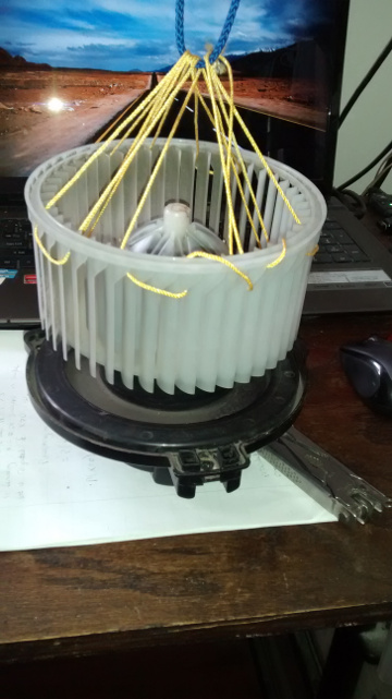

The other day my AC started to make a grinding sound, which progressed to a high pitched shriek, so following the instructions in this thread I removed the blower assembly. There was a buildup of grime on the fan, but otherwise it was empty. Unfortunately this meant the problem was internal, I suspect a bearing, so I could either 1) buy a new one, 2) try to fix it, fail, and then buy a new one.
What I did was weave a piece of string around the circumference of the fan, alternating between the inner and outer radius every 2-3 blades. For each "stitch" on the inner radius, instead of pulling it tight I created a loop of slack that reached to approximately the other side. By then joining together each of these loops at their apex, it created something of a cradle underneath the upper rim of the fan.
I took the attached picture right after I successfully removed the fan. I don't have access to a sufficiently large vise to hold things in place, so I sat in a chair and held it between my feet. The housing has a lip that extends beyond the edge of the fan, so by placing my feet on this lip and pulling the strings towards myself I was pulling the fan off of its spindle. The blue rope in the top of the photo bundled together all of the lines to provide a better hand hold.
As I started pulling I adjusted the slack to make sure the force was evenly distributed around perimeter, and then I gradually increased the tension. I had to pull pretty hard to get things moving, but eventually it started to slip, first a few mm, than a cm, and then it popped right off.
With the fan off you can see inside the fan motor, and unfortunately mine had a fair amount of rust (I live near the ocean, and the salt air wreaks havoc with hvac). The rust had basically fused the motor to the black plastic housing, but at least removing the fan exposes the innards of the motor. I cleaned out the insides with compressed air and lubricated all the moving parts in sight.
After that I reassembled, reinstalled, and fired it up. The squeal is gone, although it does seem a bit louder. Considering all the rust it will probably fail again soon, but at least for today things are working again.
****While this worked for me the standard disclaimer applies: I make no guarantees and assume no liability if you try this yourself.

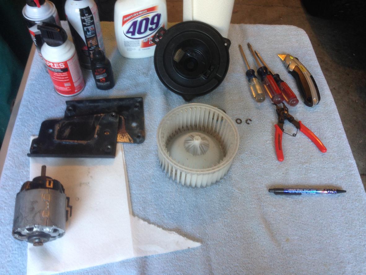

I removed the blower from my parts truck a couple weeks ago and I couldn't get the fan blades to come off after removing the clip you have the arrow pointing to. I'm going to try again since its just the parts truck anyway and I'll post up if I'm successful.
Well don't bang on the shaft cause that will ruin your motor. Not that anyone would do that.
Well, I did.
But I'm an idiot, because if I'd just read past the first few posts I would have seen that someone else already tried that with the same results. :ybrick:

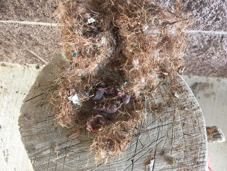

I got mine done. It was the most disgusting moment when I looked inside my blower. Guess what, a mouse in it! And it was alive. No wonder my blower got stuck. :spider:
Woah that's gross. Good thing you found him before he died in there... Then it would really start stinking up.
