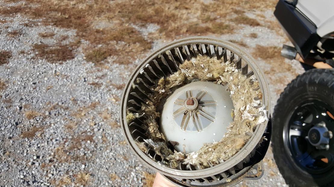

I had to park my rig in the shop for most of a year, but took it out for a drive now and then to keep everything loose. Turned the AC on the other day to check it and heard the noise when I turned the fan up past the 1st setting. Took it apart today to see why...mouse family had moved in! All cleaned up now. Thanks for all the pics and advice!

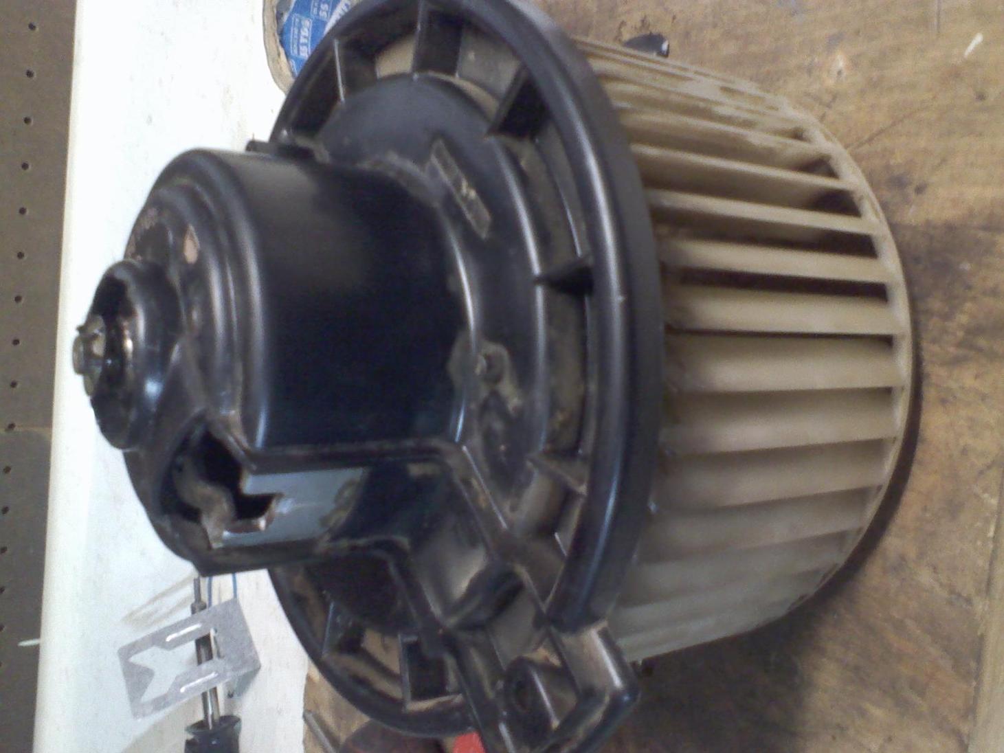

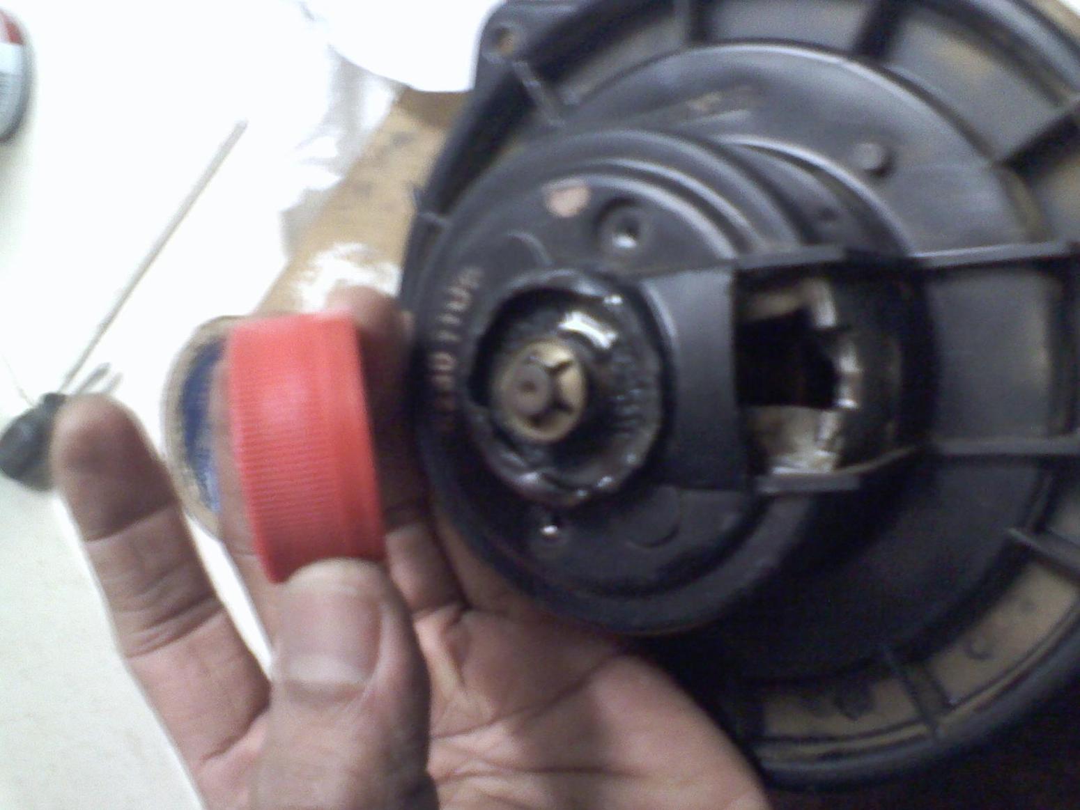

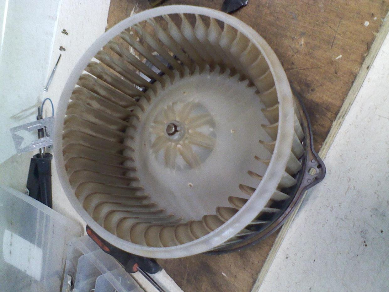

This 4R blower looks like (or almost identical to a land cruiser 100 series- year 2000). Attached are the pictures from the cruiser.
NOTE: When I tap the shaft to disconnect it from the blower blades, The armature slide out from the bottom of the housing (see picture). I had to manually reset the copper bushing into its location, which took a good amount of time)
The felt padding has to be oiled to keep the copper bushing lubed. I am not sure what is at the top. It was in place with a sealed cap so I didn't bother to remove it, but I did add some oil to the shaft.
Finally attached a coolant bottle cap to cover the bottom of the housing. All workes well.
