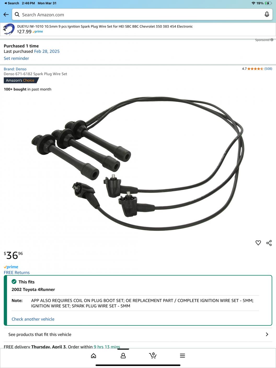

Thanks Charlie. I didn’t see this before replacing the near OEMMAF same issues. I will take it back off and get some MAF cleaner …attaching picture of what I thought were OEM wires.
OEM wires were likely Yazaki, not NGK or Denso. (fun fact, most 3rd gen 4Runners came from the factory with 3 NGK and 3 Denso plugs) Also, trust NOTHING on Amazon or eBay if it is branded Denso or NGK. Way to many fakes to know you got the right parts.
Genuine NGK or Denso wires will likely work. Source from a local auto parts store, RockAuto, etc.

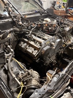

Thanks again for all help. I ended up accepting that there is some sort of internal damage n if I don’t stop pushing it I will have total engine failure
in the process of replacing with used motor this weekend… removed the oil pan saw a little bit of milky very little. Forgot to take a picture of that.Can’t wait to tear the old engine apart and see what happened?
