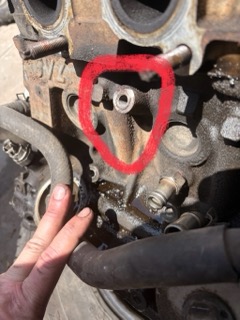

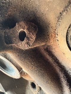

Hey Jon, did you see the used (New to me) motor where the block broke off a bolt sleeve? I noticed yesterday it looked like the freeze plug was leaking…
What would you do?
I was thinking about getting JB welder marine and boat and call it good. Really would like to rebuild my 02 motor. The 99 one is in horrible shape-mpics a following

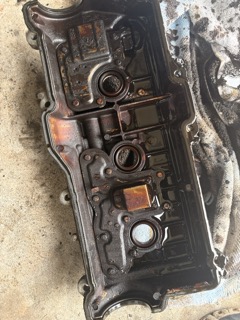

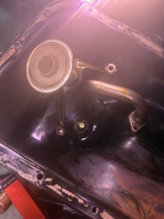

The used motor is in and I am back on the streets. Found some metal sparklers in the oil pan in somewhat milky but not really that bad. I don’t know. I think it was a lifter failure and small pieces were damaging the spark plug. So things far are good. It runs great.
Now wanting to tear the top end off to find out what the failure is for sure and possibly rebuild, sell or use as a back up?
There really shouldn't be any way pieces of a broken lifter could make their way to a spark plug. They're inside the valve covers, and while there is crankcase ventilation between it and the intake system, there's no way a piece of metal big enough to notice could make it's way through the PCV valve.
It will be interesting to see what you find when you take it apart.
