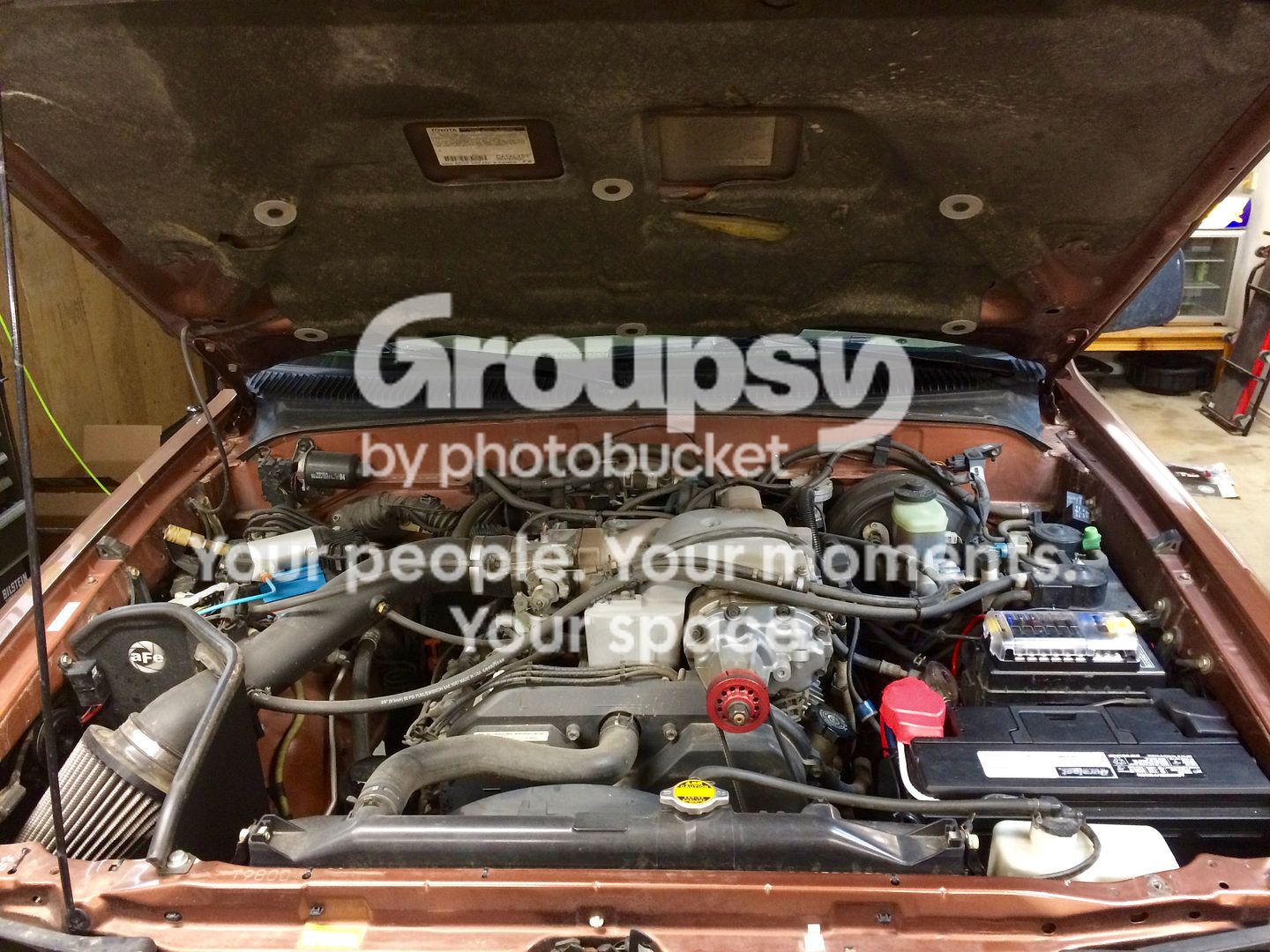

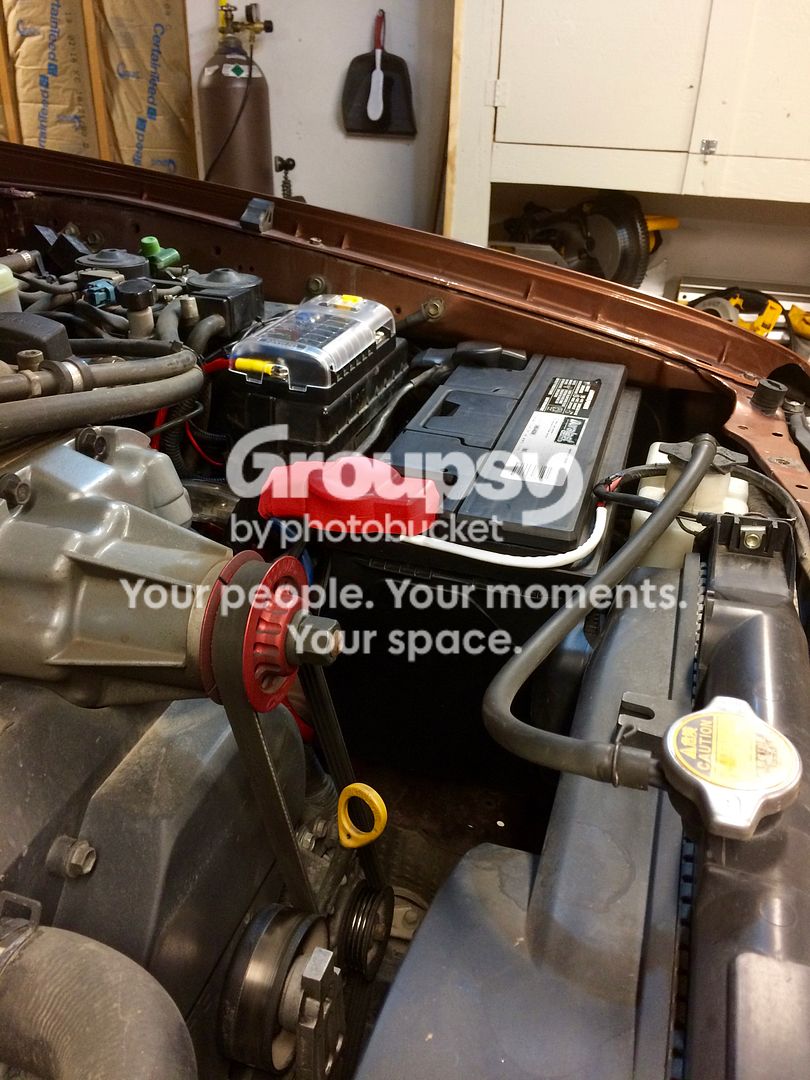

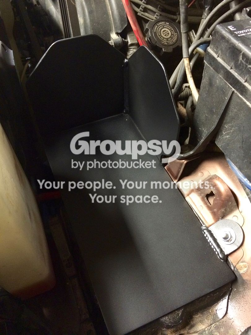

I had to build a custom battery tray to hold the battery in place.
It's a tight fit but I'm happy with the outcome. I also installed some new battery terminals, and a power distribution box to clean up the wiring and add some available circuits.

Nice. That is a huge battery. Kinda glad you are running single battery. The cost of two batteries every 5-7 years can get expensive.
Do you carry a jumper pack? If not. It be a good investment.

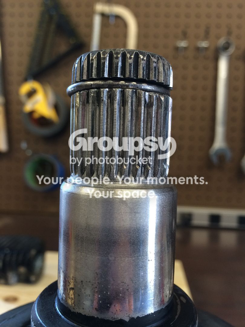

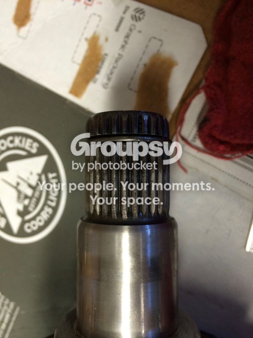

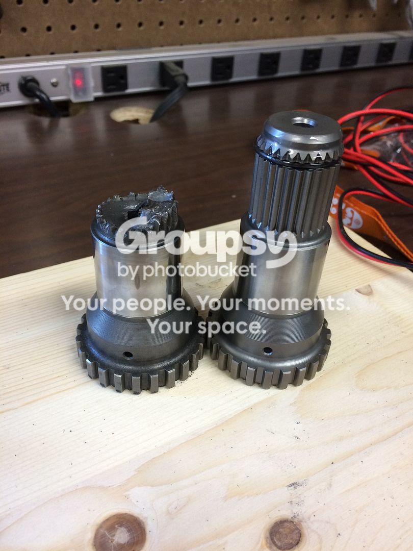

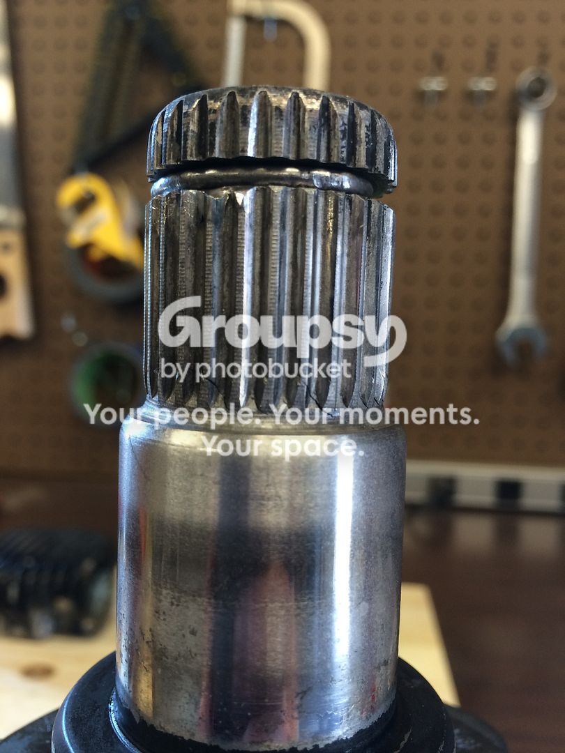

I started reassembling the passenger side CV (I tore it apart to inspect for damage) when I came across this. The splines on the inner CV joint were twisted and cracked, I’m just glad I caught it before it snapped inside the ADD tube! I had another inner joint, so I rebuilt the CV with it. I will need to pull the driver side and check for damage before I button the 4Runner back together.
What it should look like, the replacement
Broken and twisted
I also ordered the replacement stub shaft from Camelback Toyota, here is the part number for anyone curious, and future reference.

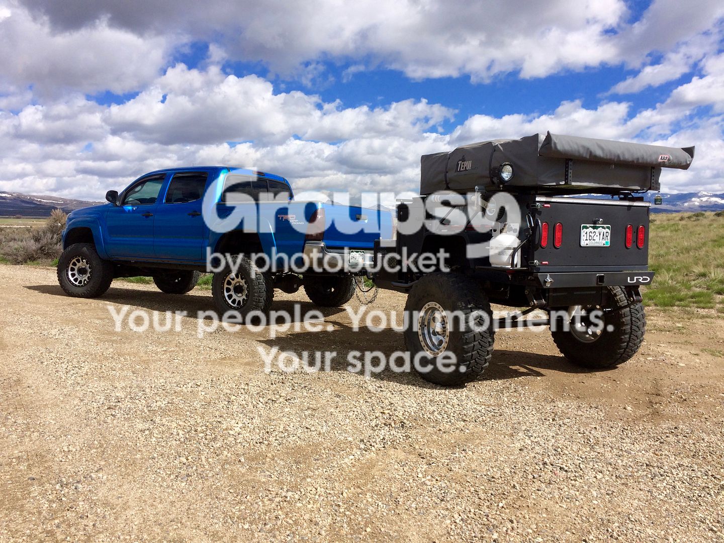

I rewired the trailer earlier this year so I could tow it behind the Tacoma. It's better for non-wheeling family camping trips; it's faster, gets better fuel economy and has a bed for extra "family" camping gear.
For the most part the trailer will be behind the 4Runner, that meant I had to rewire it to a 7way plug (like the Tacoma). It also had to be tucked up high enough that it wouldn't get damaged dragging the back of the truck through rocks and dirt.

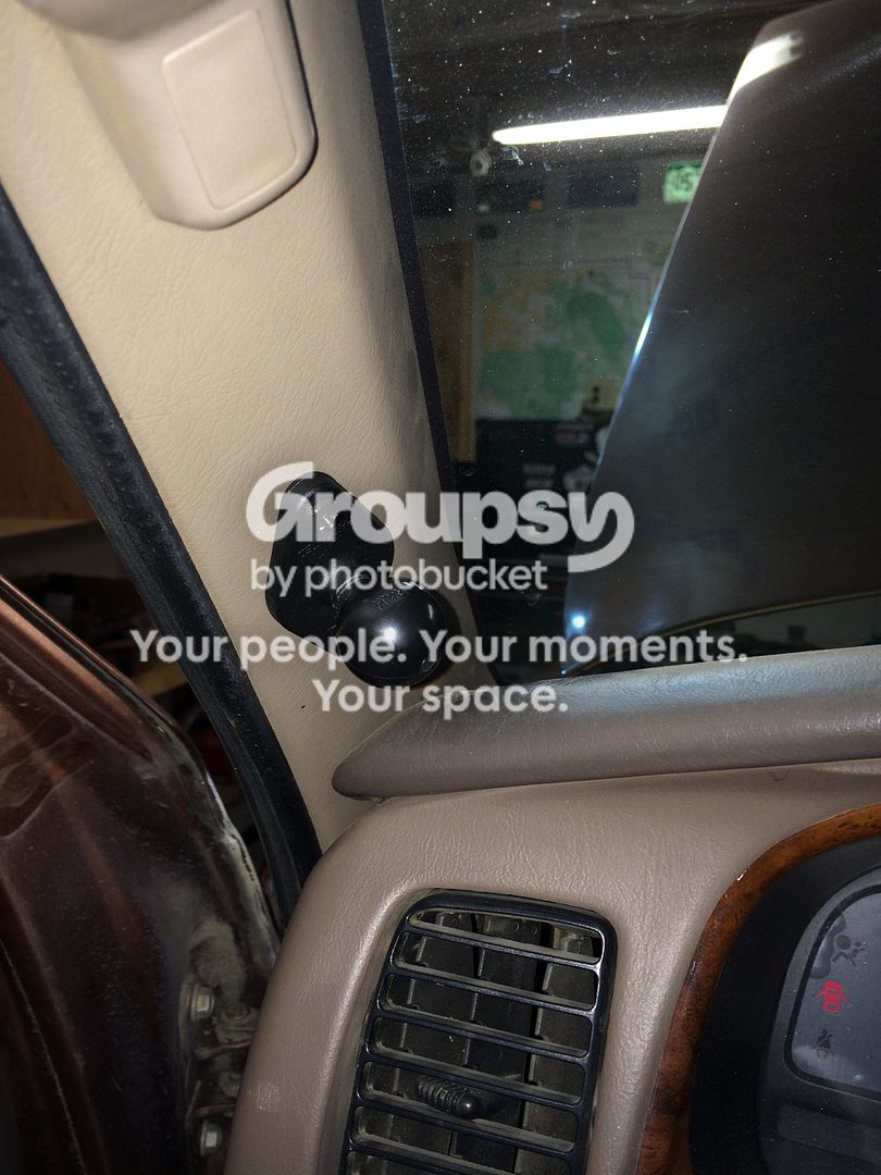

I have a couple trips coming up and I needed a spot for my handheld GPS. I wanted something that was within reach while sitting in the truck, but also removable.
Since I haven't heard you day anything about the rear axle (after trussing it), I figured I'd ask how it's holding up.
i have several ram mounts. Initially it took me a little while to get use to some of the prices but it is awesome how expandable Ram mounts are.

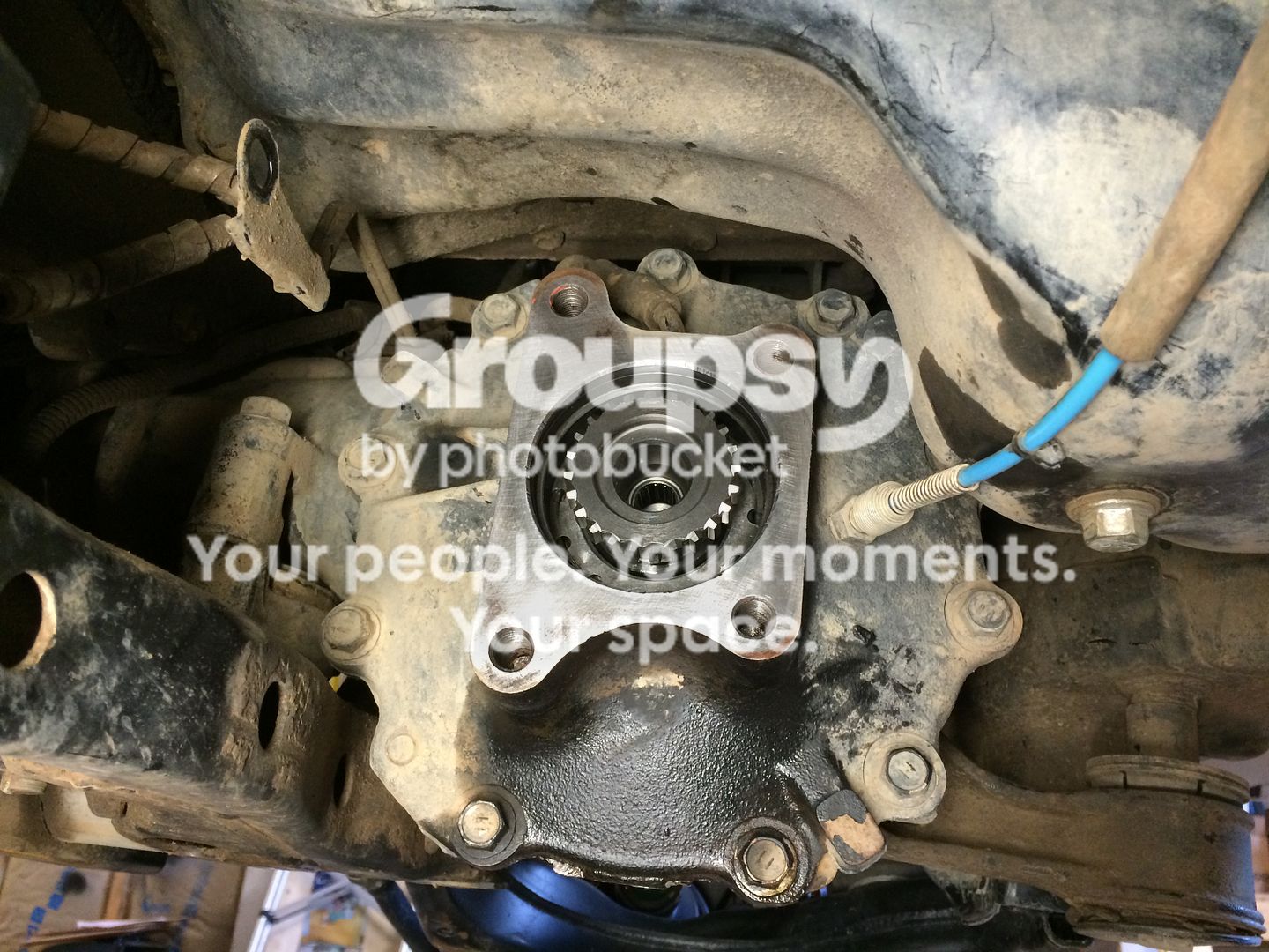

I got the A.D.D. stub shaft installed

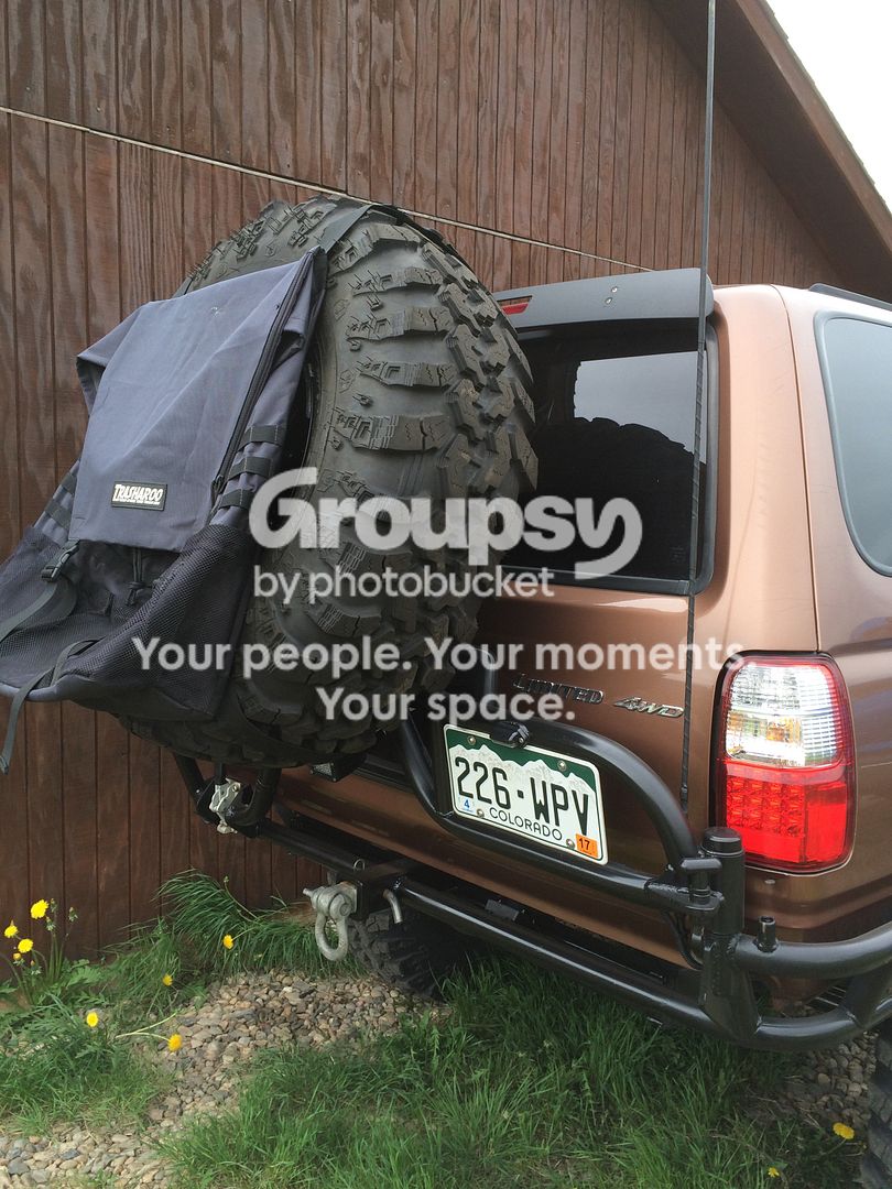

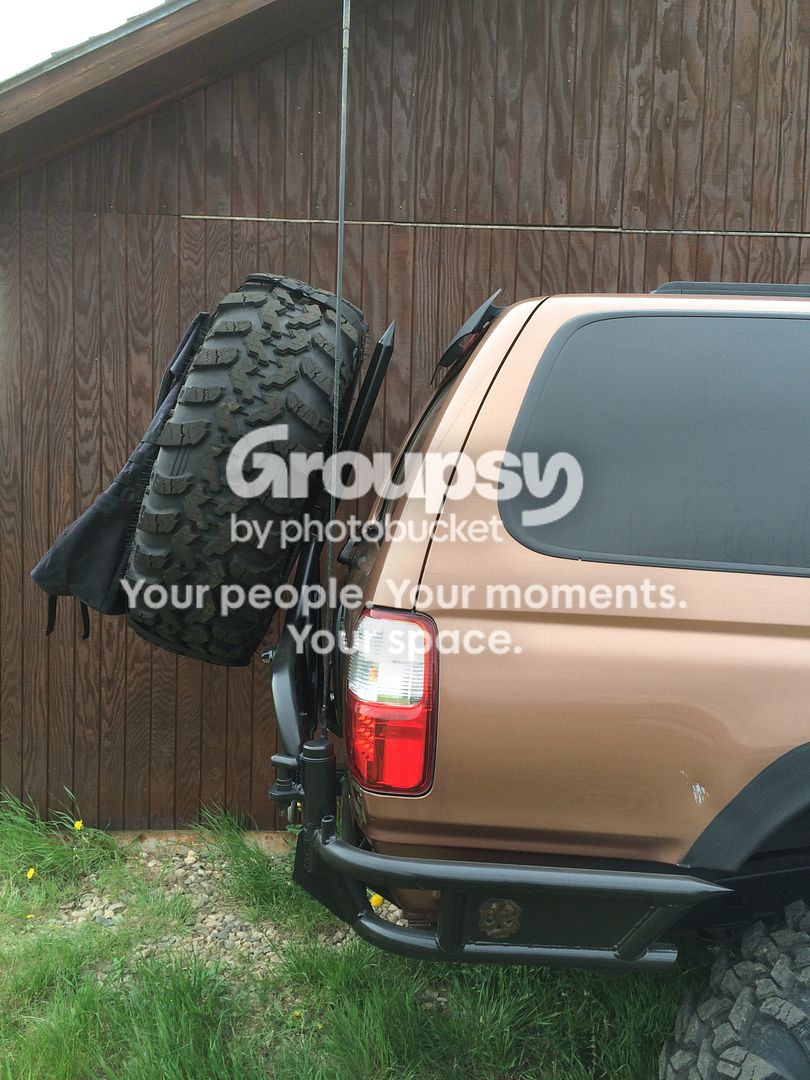

The 255 was a great spare when I had to 35’s, but its really too small to use with the 36’s. I had the old Irok that I punctured the sidewall in, so I decided to take a closer look and see what I could do. The cut was about the size of my finger, and it actually held air when I plugged it. I took the tire to work and found the largest patch we had (about 6” square) and I took my time prepping the tire for the patch, and installing it. While this is NOT a recommended repair, I feel confident enough to use it in an emergency situation and feel it’s a better option than using the 255 that was my spare. I just can’t justify spending $425 on a brand new tire that will probably never touch the ground.

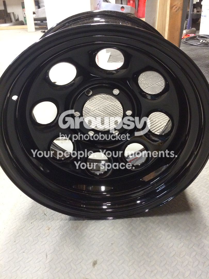

I needed a wheel to mount it on, so I bought a 17x9 3.5” backspace black steel wheel. This is the same size as my beadlock wheels, so I don’t have to worry about any clearance issues.

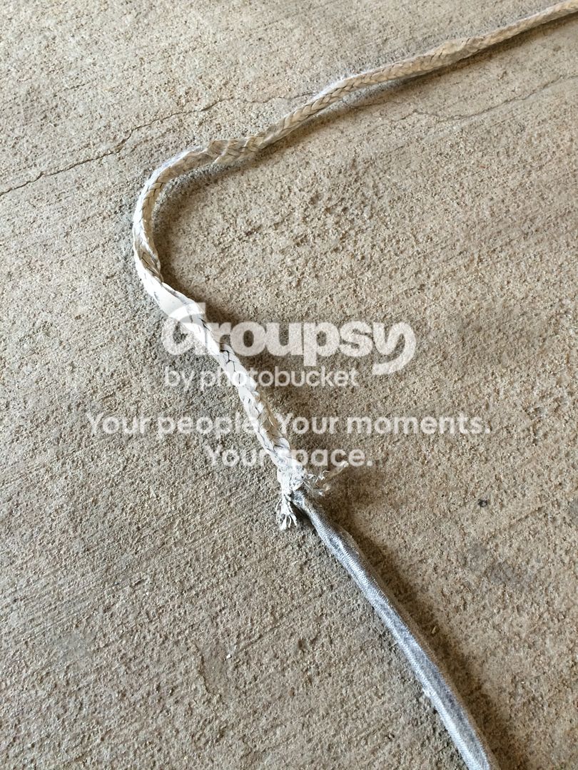

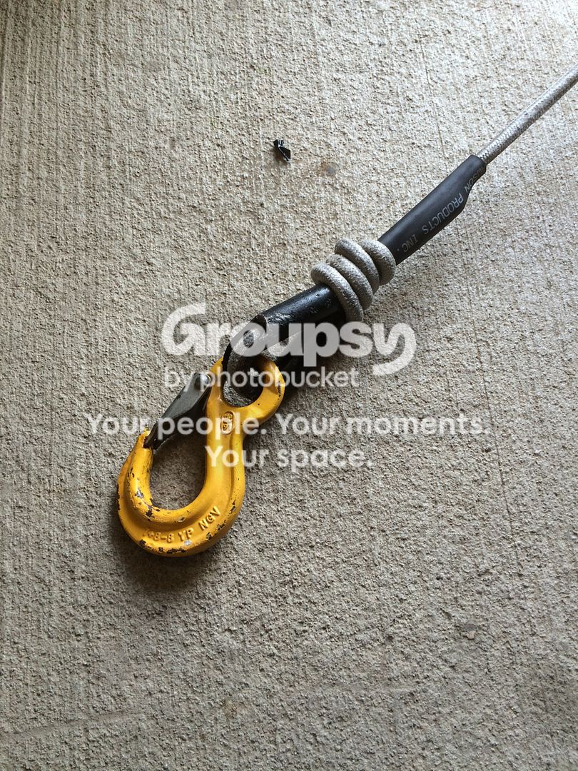

Somewhere in last couple trips I managed to rip the outer cover off my Master Pull Superline XD winch rope. This rope isn’t cheap, and you can’t splice it like regular winch rope. I cut off the damaged 20’ and repaired the rope, then built a short winch line extension. Here are the directions if anyone is interested.
Repairing MasterPull winch line - Pirate4x4.Com : 4x4 and Off-Road Forum

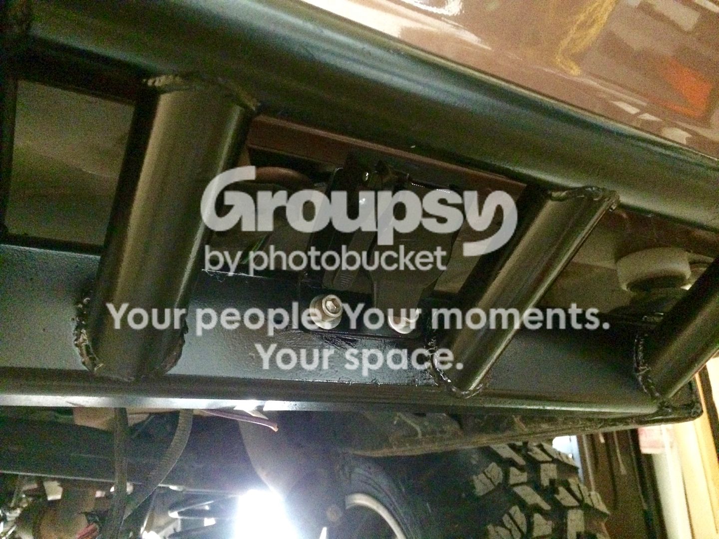

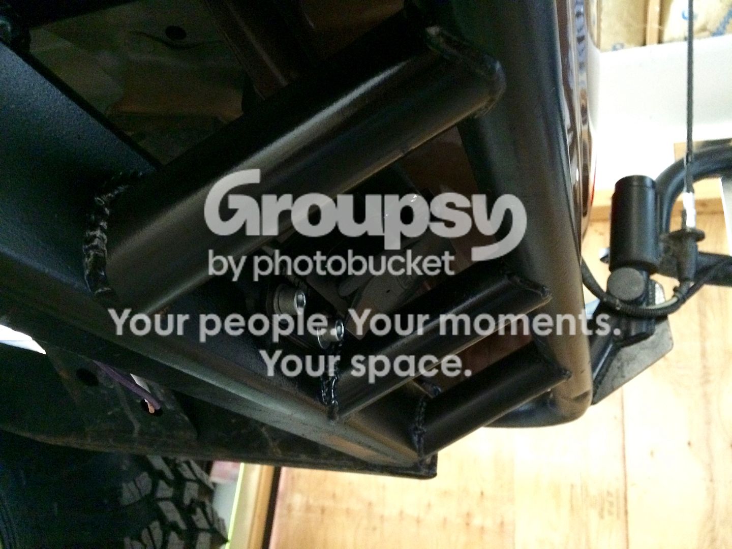

The stock fuel capacity really sucks on this generation 4Runner, so I cut the stock crossmember out in preparation of building an aux fuel tank. This is one of those projects that I’ve always wanted to do, but always gets put on the back burner. It will most likely be a winter project, but since it was in the garage and I was waiting on parts I figured what the hell.
