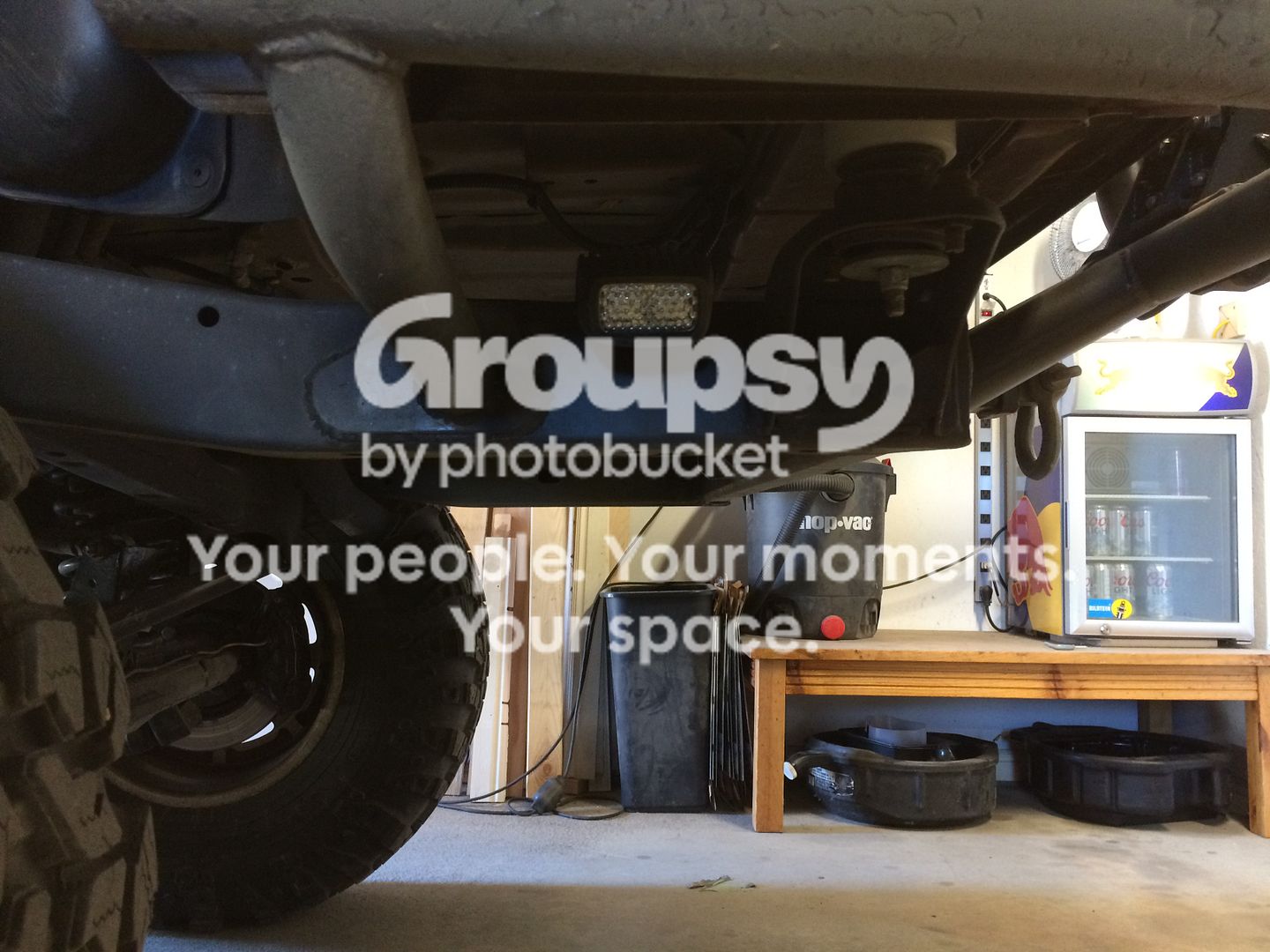

That has to be the biggest barrel of Brake Clean I have ever seen in a home shop environment. Five gallons I take it.
I think Singtoe was experimenting with using a Camry gas tank for extra fuel storage though I don't know if Rob has been on this board in some time.
I hope I never have to replace my PS pump given the price.

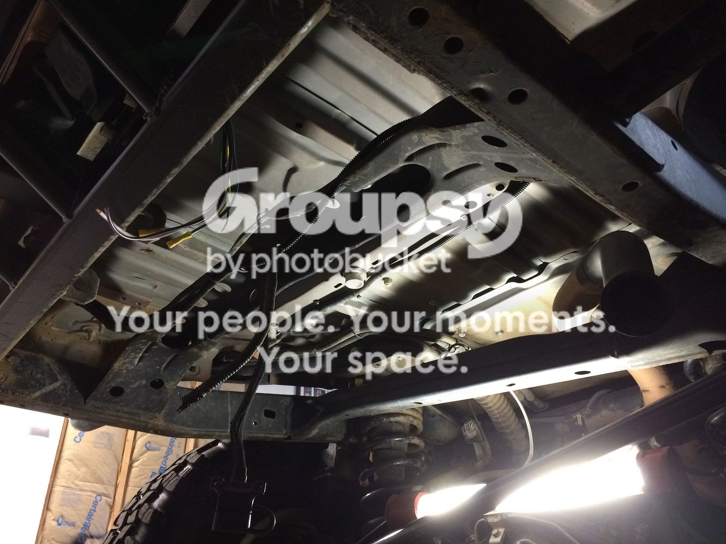

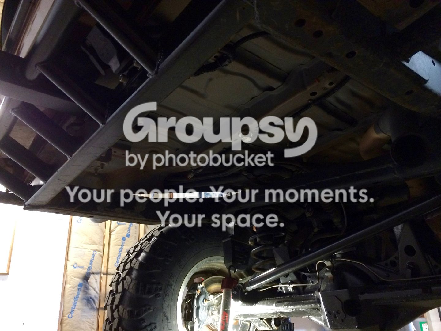

The stock fuel capacity really sucks on this generation 4Runner, so I cut the stock crossmember out in preparation of building an aux fuel tank. This is one of those projects that I’ve always wanted to do, but always gets put on the back burner. It will most likely be a winter project, but since it was in the garage and I was waiting on parts I figured what the hell.

Cool! I was thinking about making an aux tank and a tool storage in that same area.
Yes, we had it at work and I used it to transport some gas home. I plan on building the tank, I want it to be low profile and not hang down more than a couple inches (if that). I'm not concerned about capacity, if I can get 10 gallons I'll be happy. It's just wasted space, so something is better than nothing.
I've done the same thing. but I measured it out to move the main fuel tank there. I have a 2" body lift but with a bottom sump fuel cell I could fit 28-32
gallons based on the baffles or foam and precise dimensions which I wouldn't really know until I built the thing.
My measurements for a rectangular box were: 8" from body to bottom of frame rail, 27" from panhard to frame end/bumper, and 35" inside rail to inside rail. Which those numbers directly lead me to 32 gallons although they don't take into consideration any clearance between the frame rails.
You could probably stick an air tank back there with a fuel cell if you only wanted 10 gallons and keep it above the bottom frame rails.
I know I can get more than 10 gallons, I just figured if I could get at least that much I would be happy. I would like it to set flush with the frame, and I want to leave more than enough room for the suspension, exhaust and floor. I chopped the back of my frame off when I built my rear bumper, and I want enough room to get up into the suspension for work. I comfortably have 35" wide, 6" tall and only 12" front to back (my bumper design puts my 2" receiver right in the middle of where the tank is, and I need to leave room for a random trailer ball mount to fit), that gives me 10.90 gallons. I can probably squeeze a little more out of it if I modify the shape of the tank, but I'm not going to kill myself to get another gallon or two.

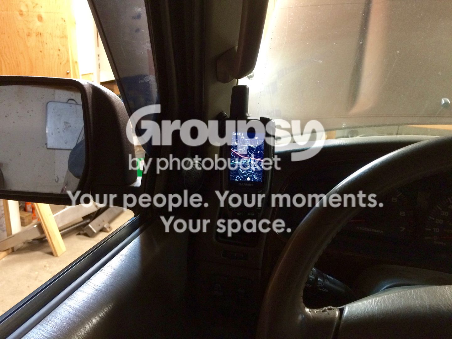

edit: meant to ask what GPS your got, is that a Garmin GPSMap 62 or 64? I recently picked up a GPSMap 64st that I am still deciding if i like it or not. It is a bit bigger than my Etrex Vista HCX (old but dependable) and my Etrex 20. I like the big screen of my Nuvi 2797 but having a handheld is nice as a back up (AA's are nice)..yep I have Gadgetitis bad:music:
