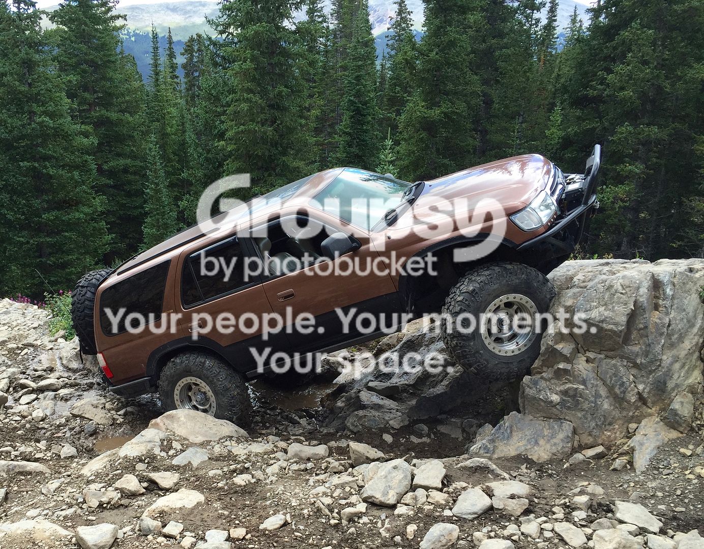

The weekend before the Colorado Toyota Jamboree I went through the process of getting the trailer hooked up and ready to go for the trip. The event started Thursday the 11th, and I had to work up to then. There had been no interest in selling it and I was really looking forward to using it. Monday I get a call from a guy who wants to look at it that night, long story short it sold, and I had two days to start from scratch.
The plan was to run Holy Cross Thursday morning, it's one of my favorite trails, but we also have a love / hate relationship. It was a little risky running it on the first day, but I thought I had the lines figured out after my last time up there.

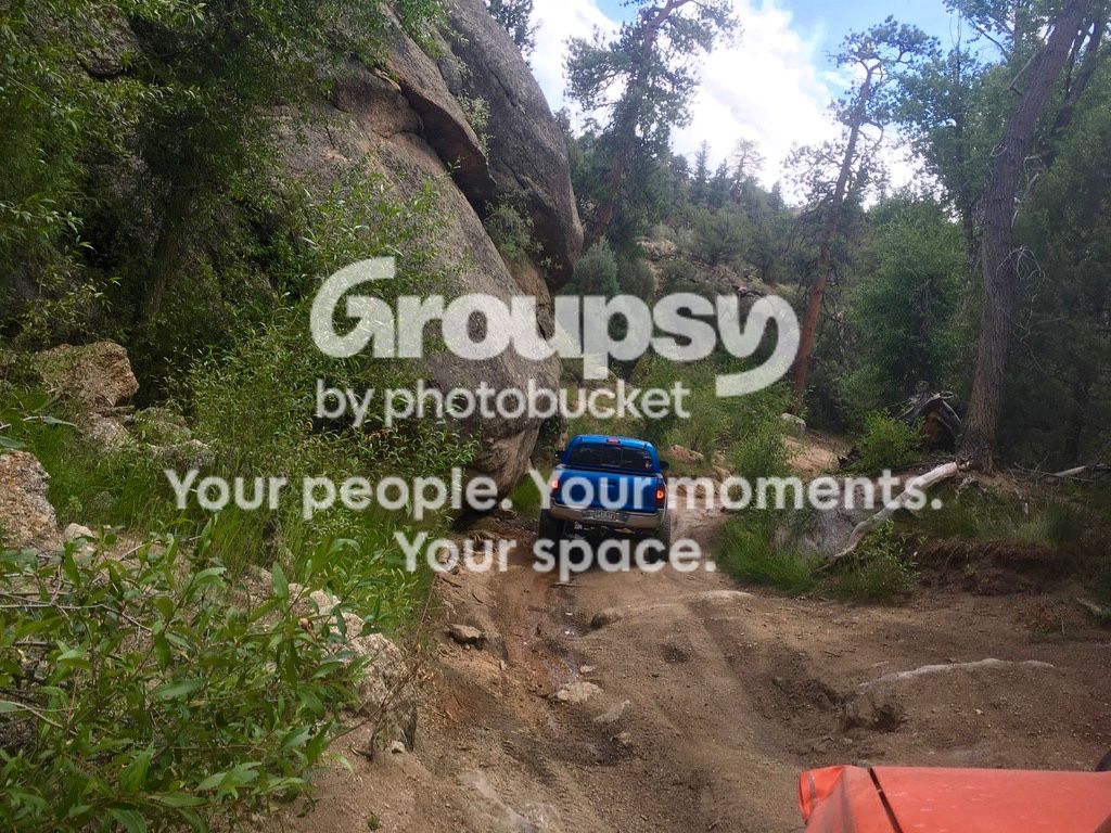

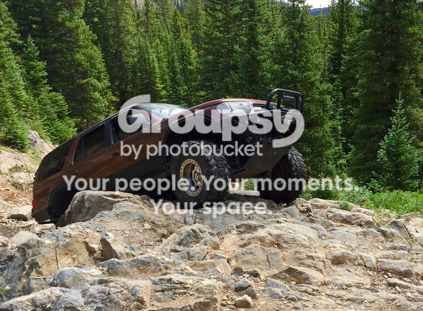

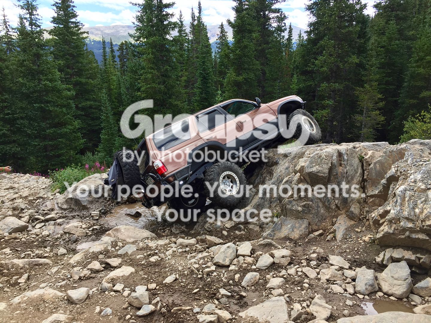

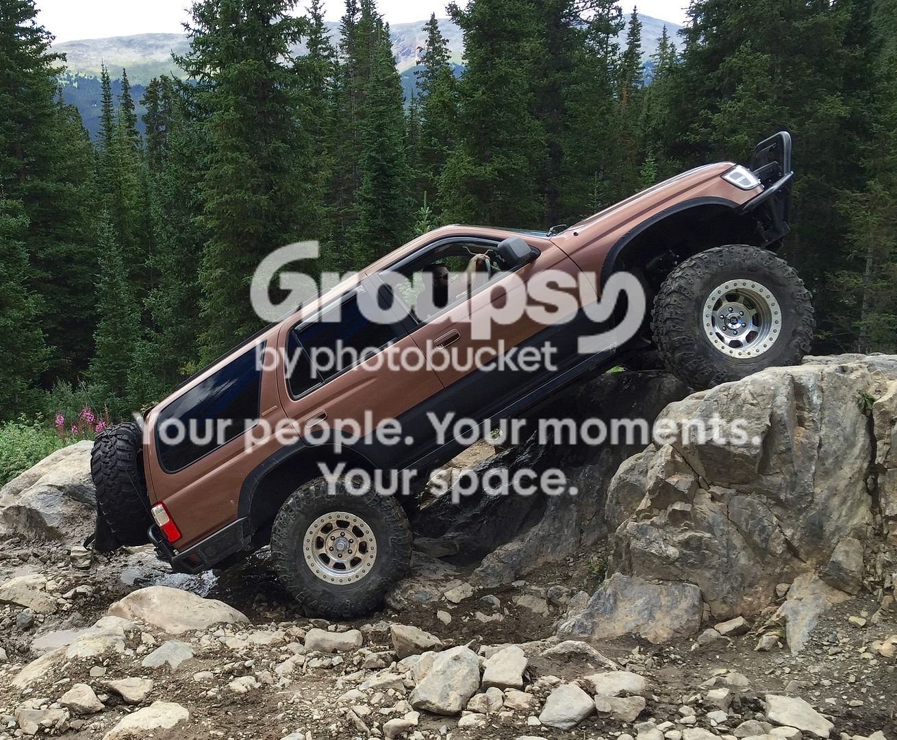

I was running late Thursday morning (since I was still trying to piece together some camping gear), so I told the group to go ahead without me and I would catch up. I met up with a couple Jeeps at the first obstacle and my group was just in front of them. At the second obstacle I was able to get out and walk up to my group. I watched a few rigs that were at the tail end go up, and then I proceeded being last in line. I wanted to take my normal line, but it wasn't going to be easy since it was wet form all the other rigs going up. My first try I slid off the side and got pretty tippy, and I decided to give it one more try. I got the front end all the way up but the rear didn't want to follow, I gave it a little bump and the rear shifted over. I backed down and Aaron noticed I was leaking something, we looked under the 4Runner and saw that one of the steering rack lines had broke. We were all confused as to how it broke, but that didn't matter at the time. I cut the belt to the p/s steering pump and proceeded to limp it home (not fun with 36's!:mad:).
A couple pictures before it broke
Backing off
Now here is where things go from bad to worse...

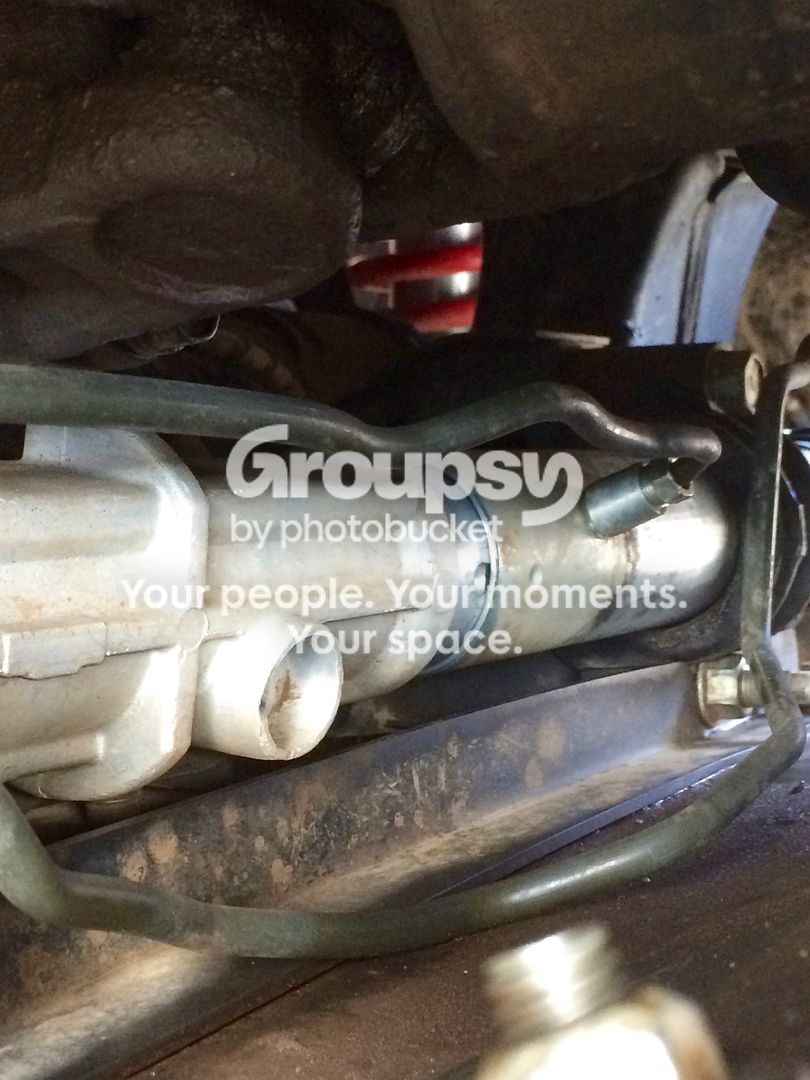

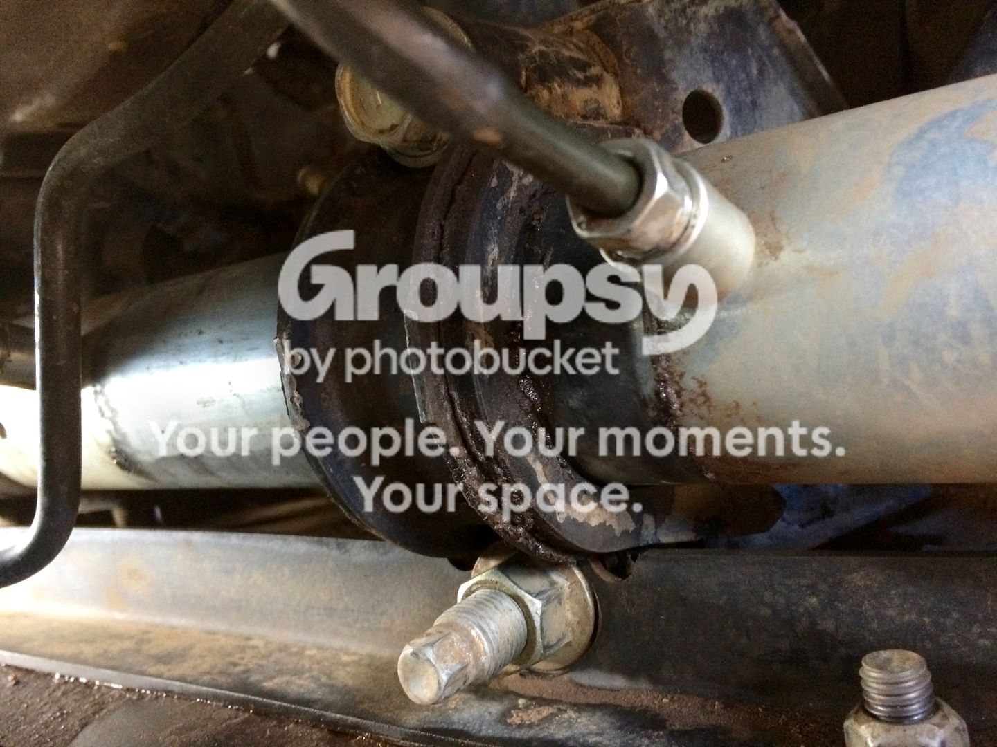

I crawl under the 4Runner to replace the line and I find that the whole steering rack is broken in half! That's what broke the line, if you look close at the bushing you can see how far the broken piece would move. The only thing keeping it together are the two line fittings.
It's a Safari LTD steering rack, so it should be under warranty. I didn't have time to deal with it, so I loaded up my camping gear in the Tacoma and headed down to the Jamboree for the weekend. I still had a great time hanging out with everyone, and I even ran a couple easy trails in the Tacoma with [MENTION=63986]Volcom[/MENTION].
After returning home and getting unpacked I attempted to contact Safari LTD, I pulled up their website and looked up the warranty details, 2 years unlimited mileage. Sweet, it should be covered, so I try to call them and I find out they went out of business!:censored:
So that leaves me with two options; a genuine Toyota rack, or a cheap parts store rack. Luckily I had the money from selling the trailer, otherwise the 4Runner would be setting for a while. So I went ahead and ordered a rack from Toyota at an obscured price; I don't see a parts store rack holding up, and I'm sick of replacing the same parts all the time.
