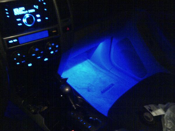

This is random, but I thought I'd share more of the LEDs I added to my truck, this time in the form of ambient lighting.
That looks fantastic emelianenkov! Share some details regarding what you did for the ambient lighting.
One other question I had regarding the HVAC controls. How did you get them to all light up like that? Mine don't light up like that. Only a couple of the lights on the knobs light up.
Thank you! I'll post details on the ambient lighting install when I'm on my computer after I get out of work tonight.
For the HVAC lights, I just swapped in NEO-3 and NEO-5 LEDs from LED Lights, Bulbs & Accessories - SUPER BRIGHT LEDS. Took a little bit of filing the circuit board to make em fit, but no real issues!

Ok, SO!
I got two of these: WFLS series Flexible Light Strips
I installed them under the dash. I routed the wiring through the center console (removing the HVAC cluster to hide the wiring). Then I just used two connectors to connect it to the + and - of the 12V cigarette lighter.
Really easy to do. Any questions, DM me and I'll give you a call. I have A.D.D. and it makes typing long thoughts a hassle... ANYWAY. That is a VERY basic how-to. Sorry for my lacking info
