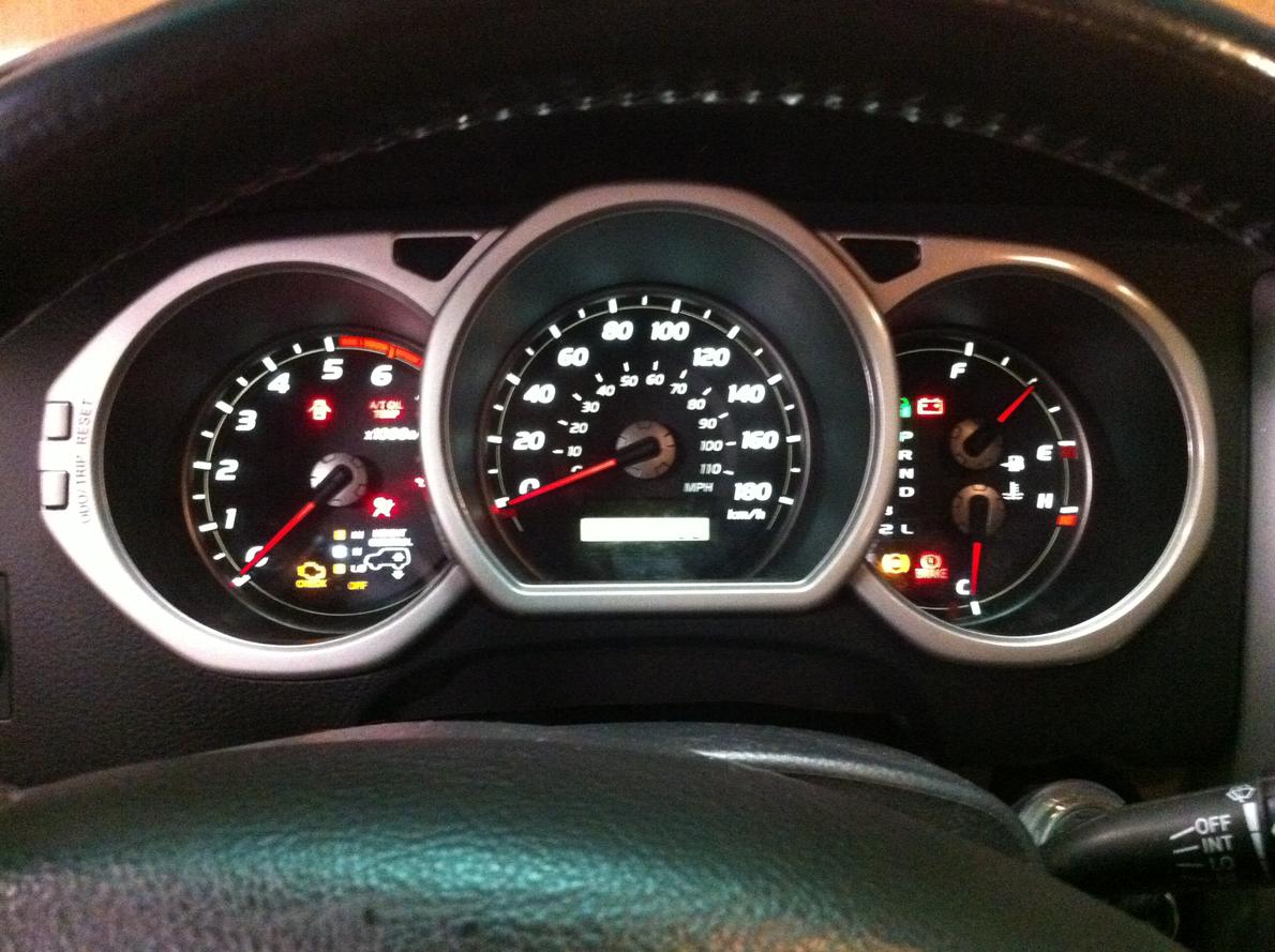

If anyone can find a way to get the instrument cluster to stay "full bright" when your lights are on, that would be awesome! All Lexus cars and my brother's RAV4 have this, but 4Runners don't (never understood why).
Lights on, instrument cluster lights dim. (on the dimmer switch, position right before it clicks for full brightness)

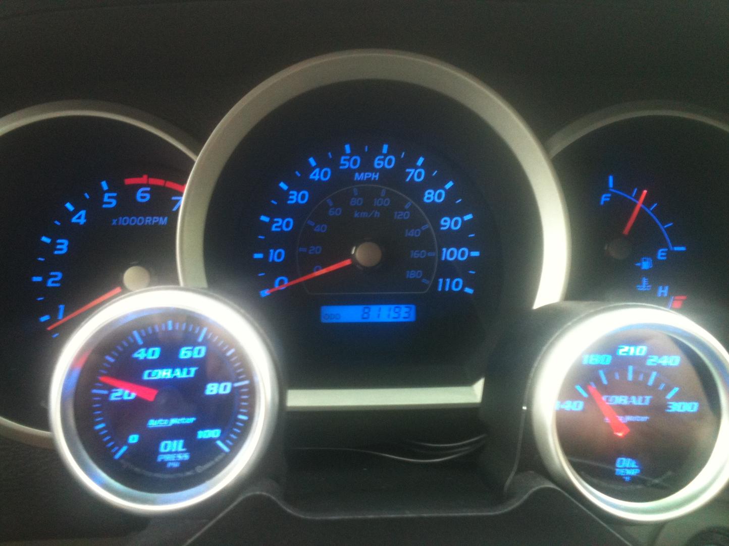

Finally got around to doing this...
I found that a 50ohm resistor worked best with the blue lights I had for the HVAC LCD.
Tried out 180, 150 and 100ohm resistors first but they all seemed just a bit too dim so settled on 50ohm. May be different though for different colour lights and how bright you want them.

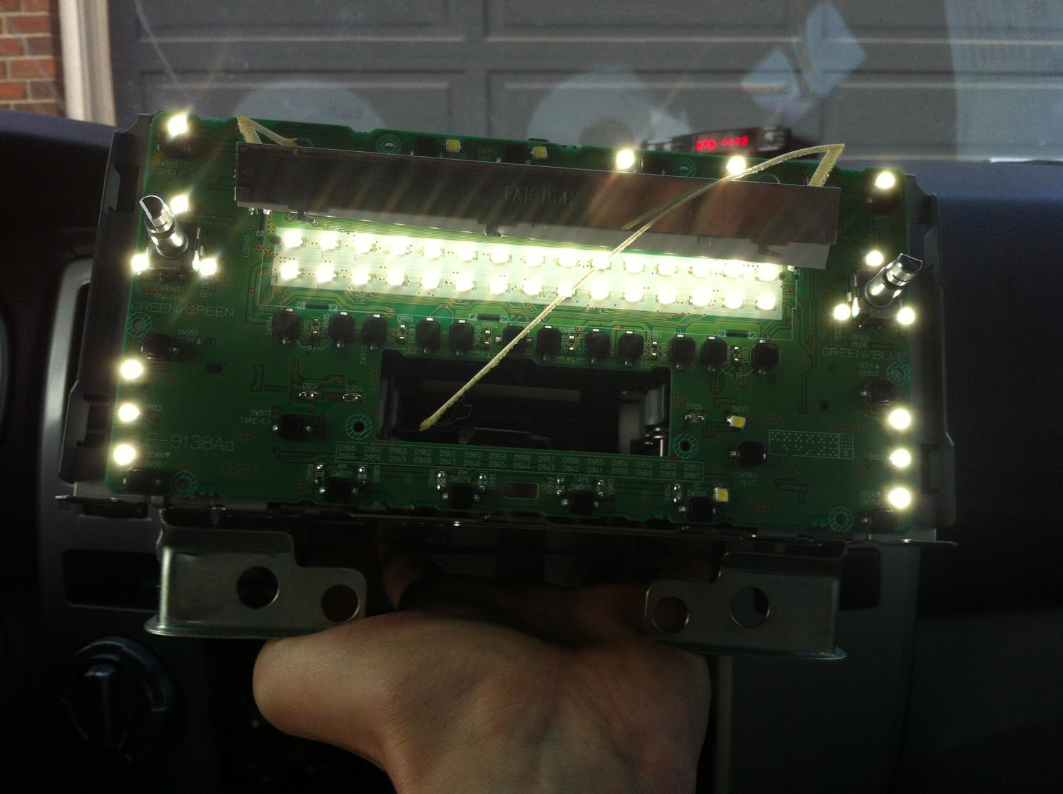

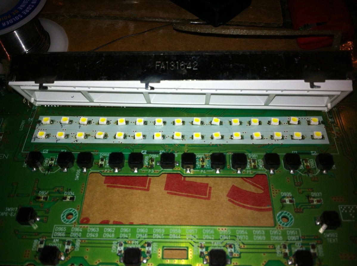

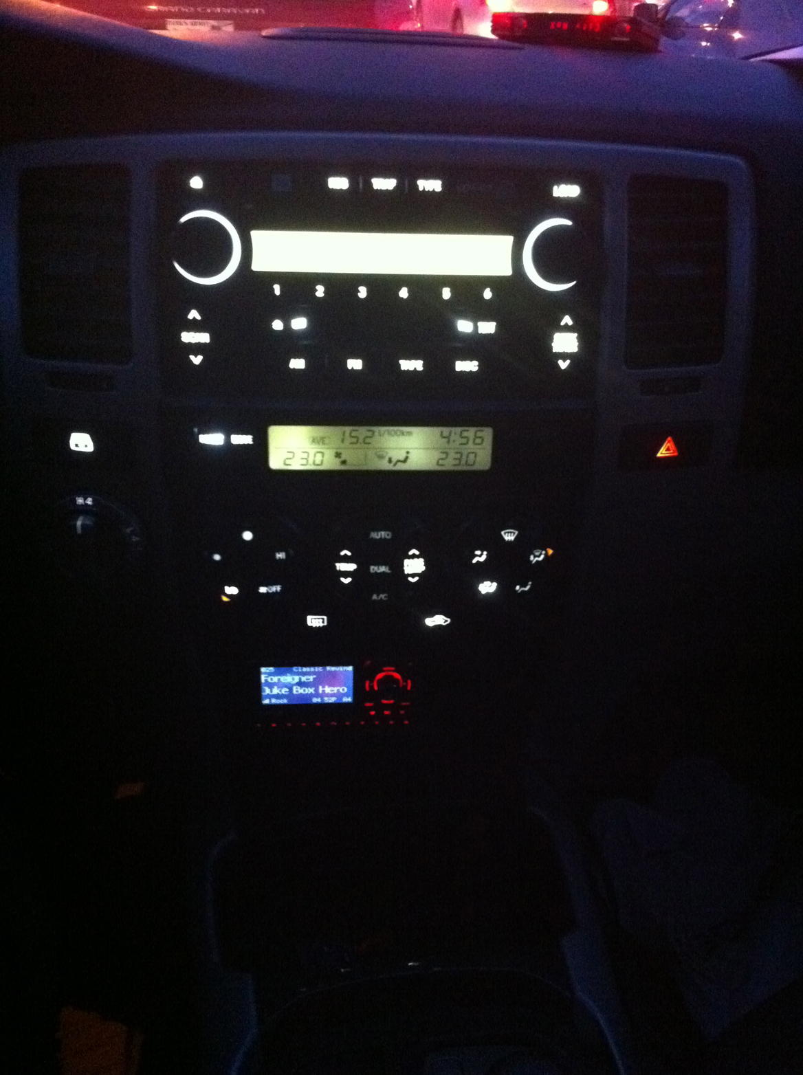

did the led swap,
i used 35 leds for the guage but wish i had about 40, 66 leds for the radio, they are smaller then the plcc2 but i used plcc2 and they worked great. heres some pics.

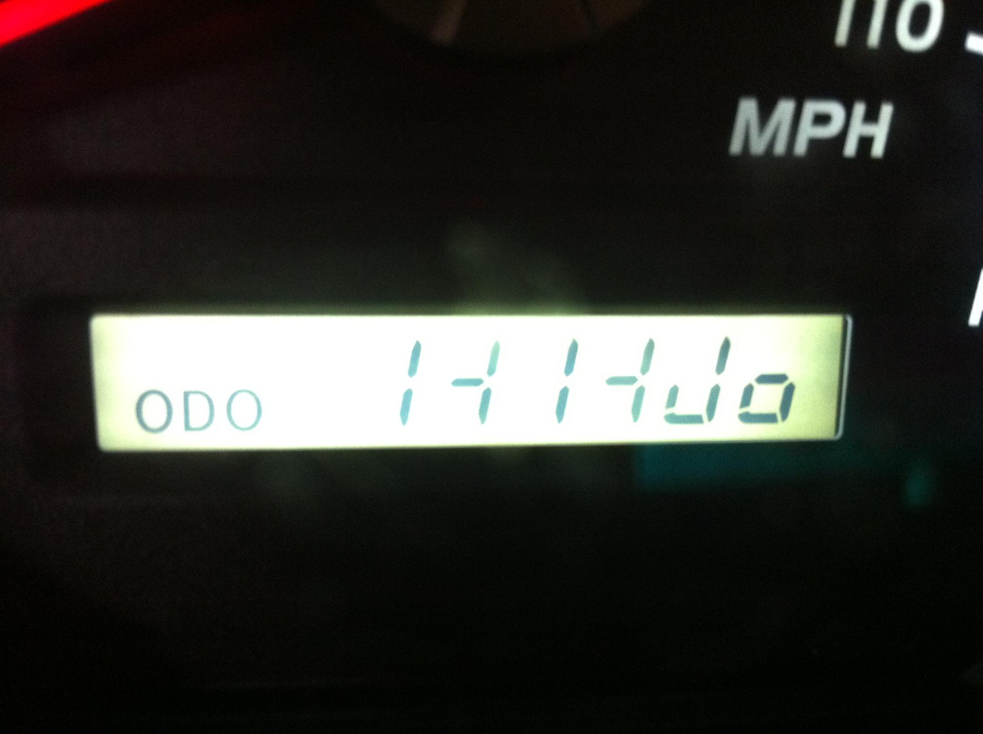

and does anyone know what i did to **** up the lcd display and how i fix it?
