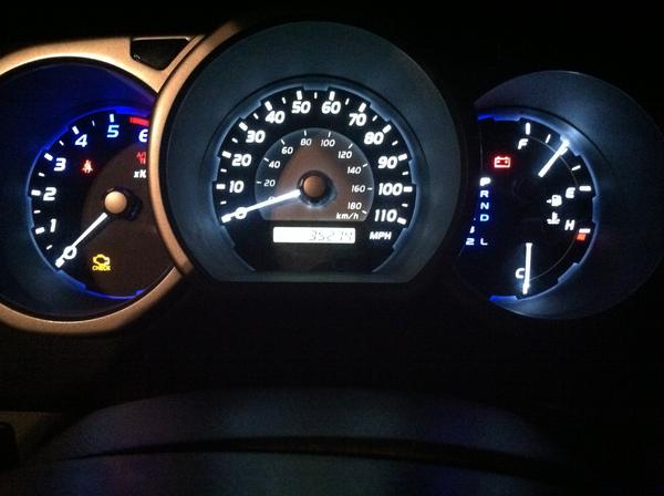

GENTLEMEN! (and maybe a lady here and there)
I give you the FIRST 4th Gen with white gauge needles! :D
Now that is tight! You got me wanting to add the white needles with my blue.
