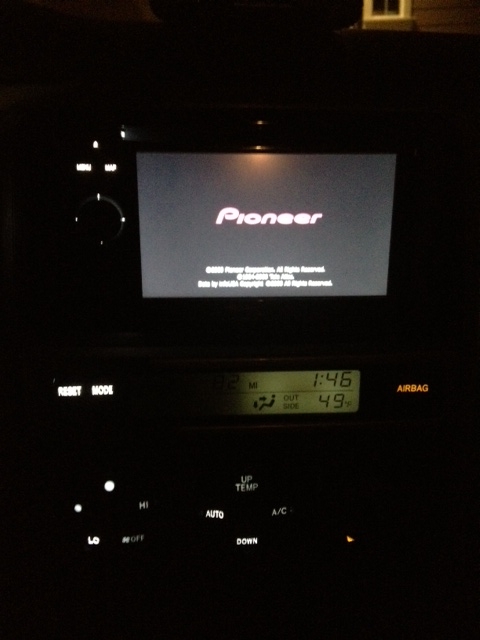

Well I'm about 1/3 done. Contrary to what Darkie said, I started with switches/ hvac first to brush up on my soldering without scrappin my gauge cluster :hello:
Got a few hotspots to try and fix but overall I love it so far!
Lookin good! :bigok: Keep up the good work!
Hey man, did you use a 5mm for the lcd screen? Trying to figure out why yours is way brighter than mine.. Cause I'm an amateur I assume but thought I'd ask.
The neo-4 is a drop in replacement. Darkie made his own bulbs by reusing the OEM bulb holder and soldering a 1.2 ohm resistor onto a 3mm flat-top LED. Though the neo bulbs are good for quick swapping, and I prefer them because of my shaky hands and short attention span, they sometimes cause hot and cold spots, especially with the white bulbs.
