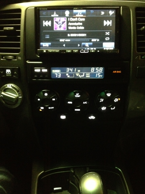

Hey guys, I just recently swapped out my hvac controls to white. I had them working and had some hot spots and was playing with ways to fix that. Anyways, I went to put the controls back in and now they wont light up at all. The cup holders don't light up the dash doesn't dim, the glove box light doesn't turn on. Its as if its not sensing that the headlights are on. What might cause this any suggestions?
Also I already looked at fuses and didn't see any blown
TAIL fuse? red, 10 amp?
10,000 percent correct. Felt stupid not finding that one. I just about pulled out every fuse. I used little pieces of paper to help diffuse the light. Helped a little bit with the hot spots, but the hp neo wedges seemed to work better. Just ordered my plcc-2's from oznium. I am getting excited for this project. here's hoping I don't bone anything on that one. For now I ll have to wait for them. Next on the to do list adding factory bluetooth controls . Thanks for the help!

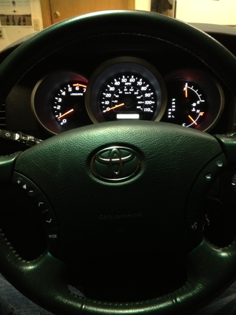

This worked perfectly. My dumbass didn't replace the gear selector back lights so I had to take it out just to change those two LED's out. Other than that it came out great. Here's a few pics for ya. This came out great and wasn't too hard. Definitely time consuming. I love it though. Everyone should do this. Now I am up for new projects to consider. Thanks for the help. Oh and I managed to loose the gromet for the trip meter button anyone know how to get a new one?

Pictures are washed out, but finished the led swaps. Only have the door window switch left. Overall pretty pleased, a few hotspots that I have to figure out in the HVAC controls and the 4wd but overall pretty easy to do.
