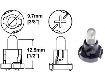

Neo bulbs have the plastic base that allows them to be screwed in.

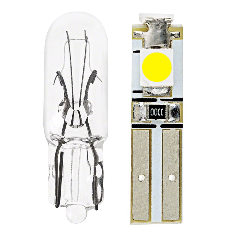

73/74 wedge are straight push in and play, usually with clear plastic squared off bottom
Cup holder and shift indicator are not neo bulbs iirc, they are 74 or 73, whatever size wedge bulb

Neo4 / T4 Neo Wedge
*2x for LCD screen. You need the low power 6v ones as the 12v LED's won't power on. Or do the 12v mod/wiring. Or order from the other site in the previous comments.
*1x for 4x4 switch. I had to grind the sides of the T4 to slide into bulb hole.
Neo3 / T3 Neo Wedge
Everything else.
*1 for each HVAC back light control (3x). The indicator tips are soldered onto the board. That's a different process.
*1x rear defrost
*1x recirc
*1x reset/mode on clock
*1x rear window switch
*1x for DAC switch
*1x for diff lock switch
*1x for hazard? I left mine alone.

Ahh yea i ordered my neo wedge from here : http://www.wardenjp.com/stores/neowedge.html
They fit pretty well, minimal tinkering to get them to fit. I got the neo wedge led, third option down, not the smd led ( second option)
The beam isn't the best, there are some hot spots, but better to have some light than not at all right?

Question...where is everyone getting their info display neo 4 (6v)?
I ordered the SMD versions from the jpwarden site people have been posting, but the info display still doesn't light up (yes, I tried switching the polarity).
Also, the neo 3 wedges I ordered from him are slightly larger than the hole (I think it's because of the PCB under the SMD).
Has anybody filed these down and gotten them to fit right?

most just do the 12v mod.. those 6v are tough to come by..

Look at your new 4 base's the led wire may not be touching your HVAC power pads. You might have to rearrange or loosen the wires to get a connection.
