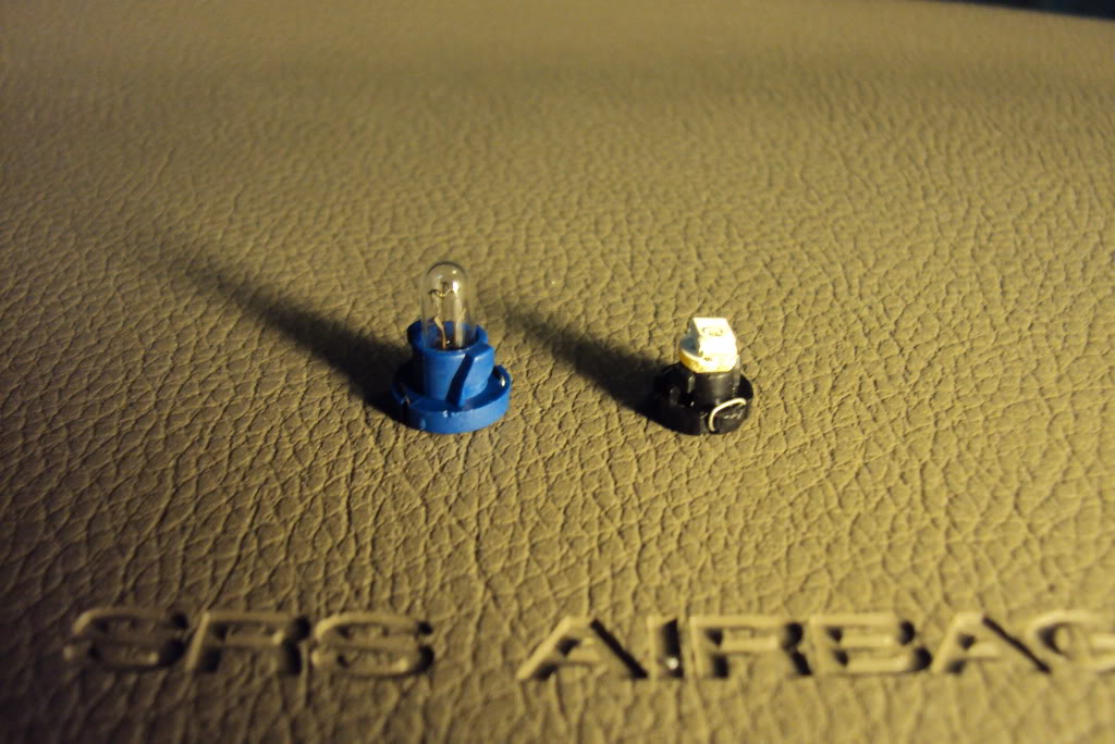

taking the plunge with replacing my LCD and cluster panel burnt out lights with the LEDs that you suggested. $16 bucks for:
2x for LCD screen
1x for 4x4 switch
3x HVAC back light control
1x rear defrost
1x recirc
1x rest/mode on clock
1x rear window switch
1x for DAC switch
1x for diff lock switch
1x center console shift indicator
1x glove box
1x cup holder
and not having to do the 12v modify sounds like a win
Thanks [MENTION=46728]magert54[/MENTION] and [MENTION=142282]ZebRuaj[/MENTION] for your posts
2x for LCD screen
1x for 4x4 switch
1x rear defrost
1x recirc
1x for DAC switch
1x glove box
1x cup holder
So my dumbass on the DAC light shorts the whole dash and rear lights. Guess who is going to get a new 10a fuse in the morning?
This dude
Otherwise the swap was going fine, until that, and when I realized that I was sent the wrong neo bulbs for the cup holder and shift indicator
