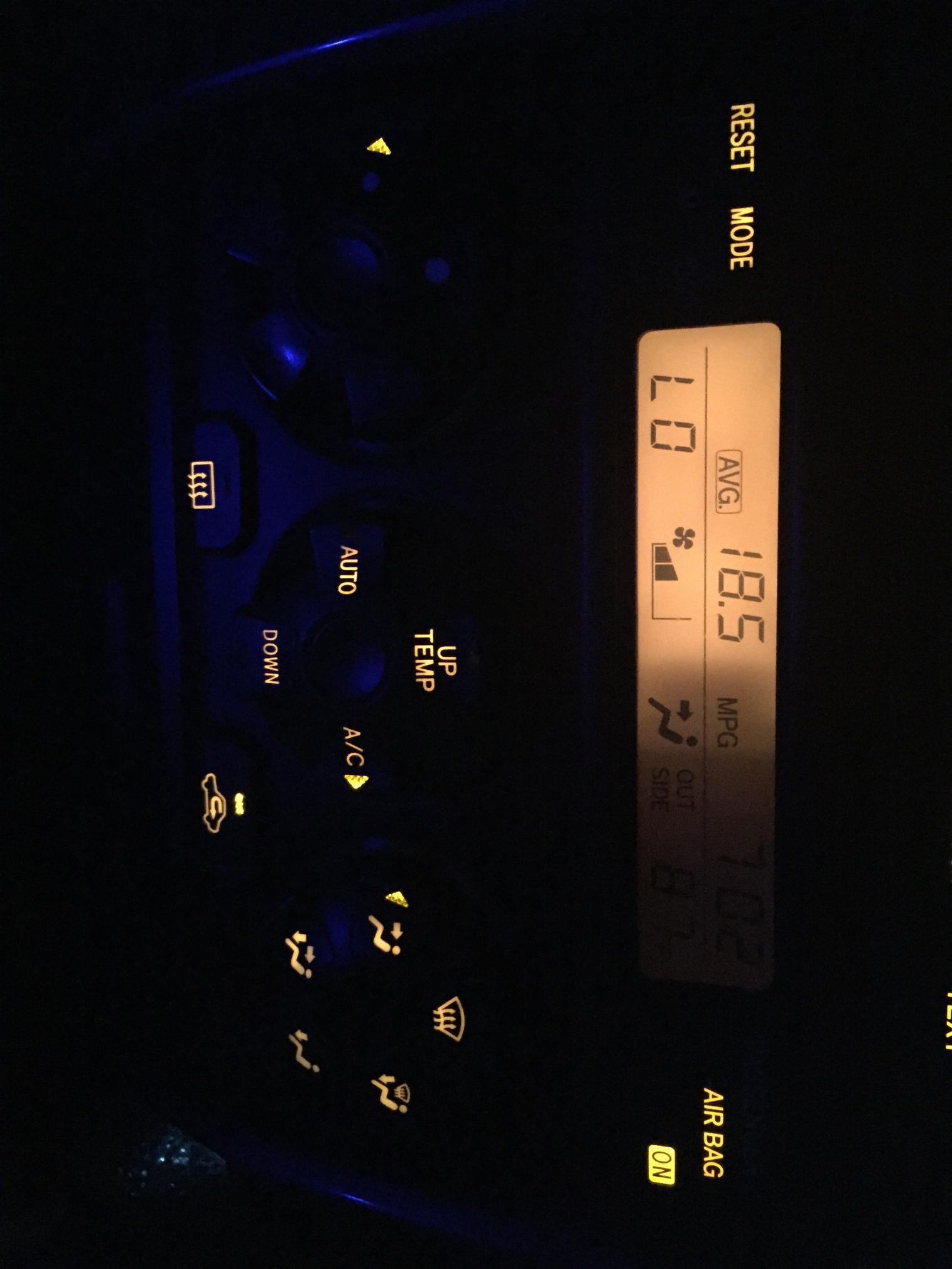

Yes those are 12v. If you have extra wire try hooking up to battery to see if the led's work
I already tested them with a 9v battery (saw it on a previous post...great idea) and they all work.
I guess I may have to do the 12v mod, I was just really trying to keep it plug and play.
I sent the guy a message through PayPal to see if he has any that are 6v (I also need one Neo 3 that came broken).
The third section or set down is the 6v (which you need) the 2nd set is the one you have which is 12v.

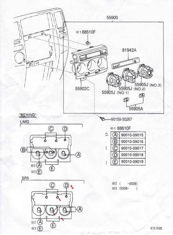

parts numbers for my HVAC lights
Hi guys, i looked at a couple of online references for HVAC bulb replacements but I was a little confused so here is a pic of what I need:
Fan speed light and clock/temp rear LCD display bulb.
Any idea on part numbers?
thanks guys!

Here's a diagram with the part numbers for all the bulbs needed, the lower section are the bulb numbers.

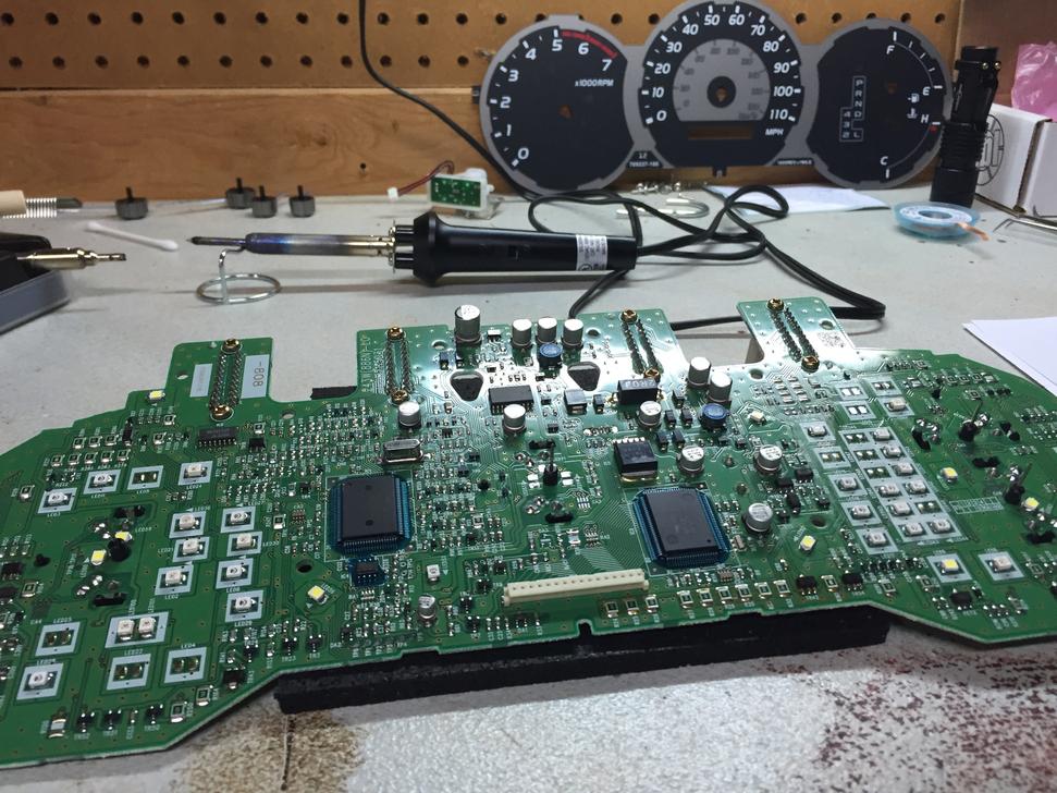

No bulbs in the cluster, SMD LEDs there. The bulbs in the HVAC can be directly swapped out EXCEPT the info display bulbs. Only some LED bulbs work there. This is because for some reason the info display area gets only 6v, whereas everything else in the HVAC gets 12v. For the info display, you must either find the right bulbs or do a 12v mod
