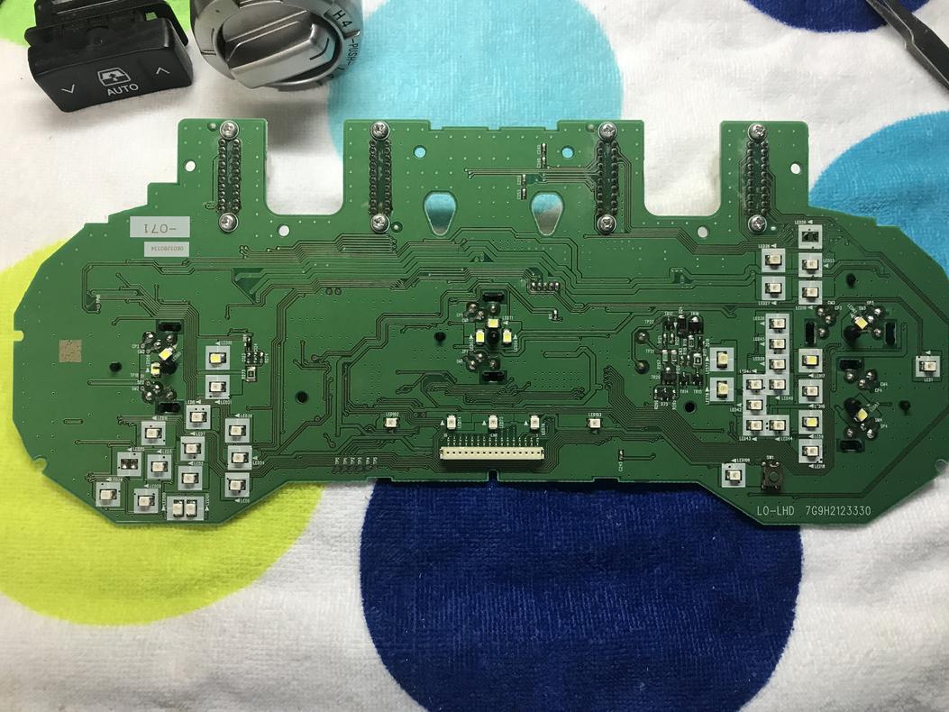

(Positive side of led's)

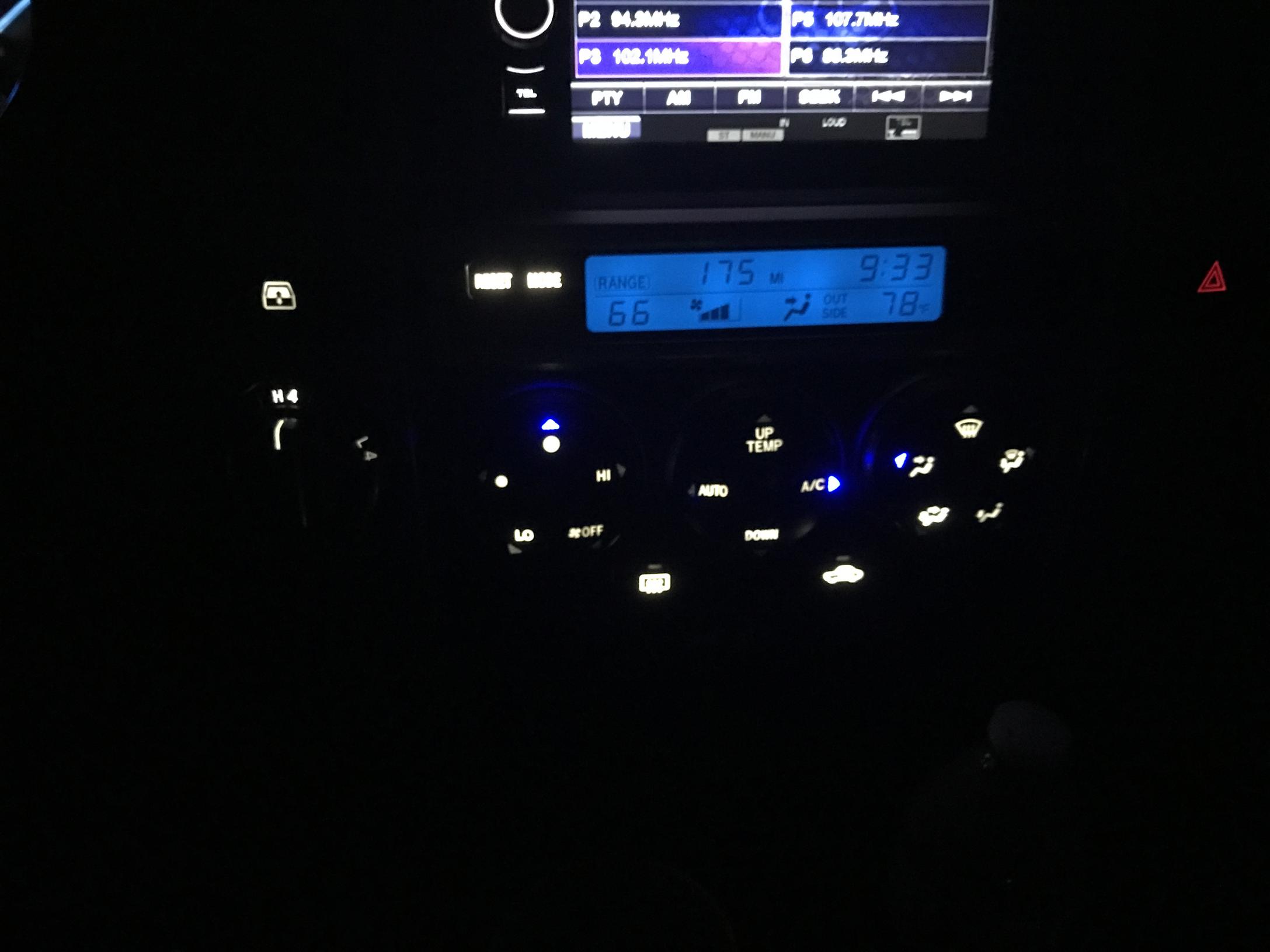

How did you get the light on the HVAC controls so even? I struggled with that one.
The above pic is my hvac, which is the worst. Last couple the lights are getting more even. I need to work on the 4x4 selector above.

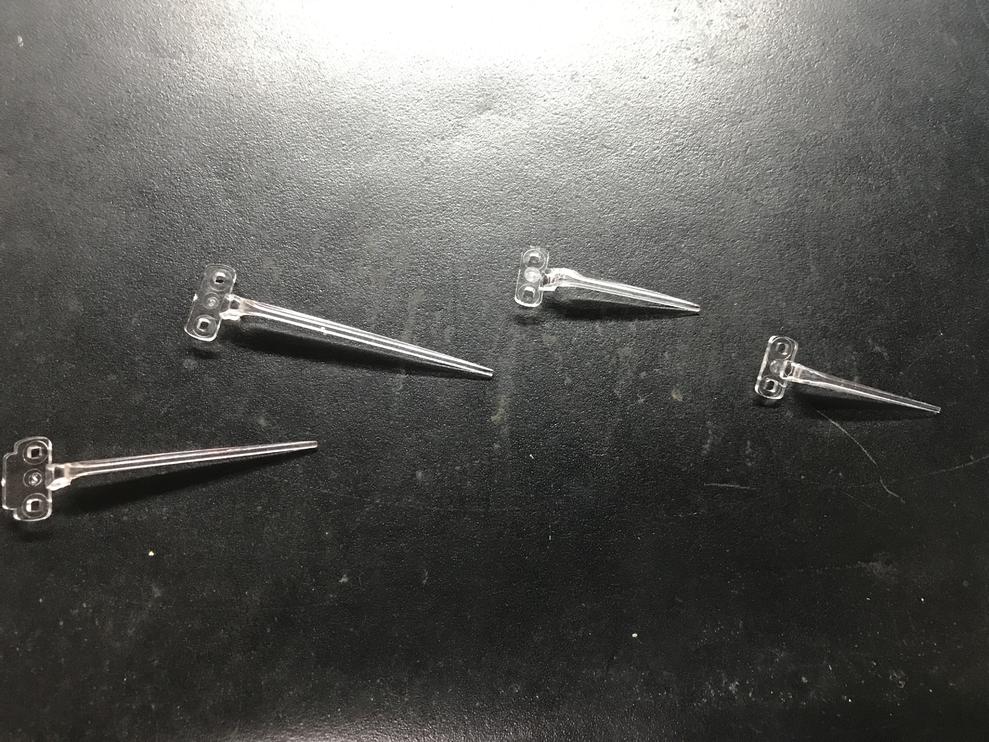

Anyway, sand the bulbs tip down it will make the light shine out instead of up. I take quiet a bit of the material off.

3rd,4th,5th led's will work. Ones with acrylic tops, sand them down some to get even light output. When you install just barely have to turn them. Here is a pic of positive sides
2 T4's for clock, white really looks almost brown. Blue looks really good
All else are t3's, including buttons, rear window etc.
