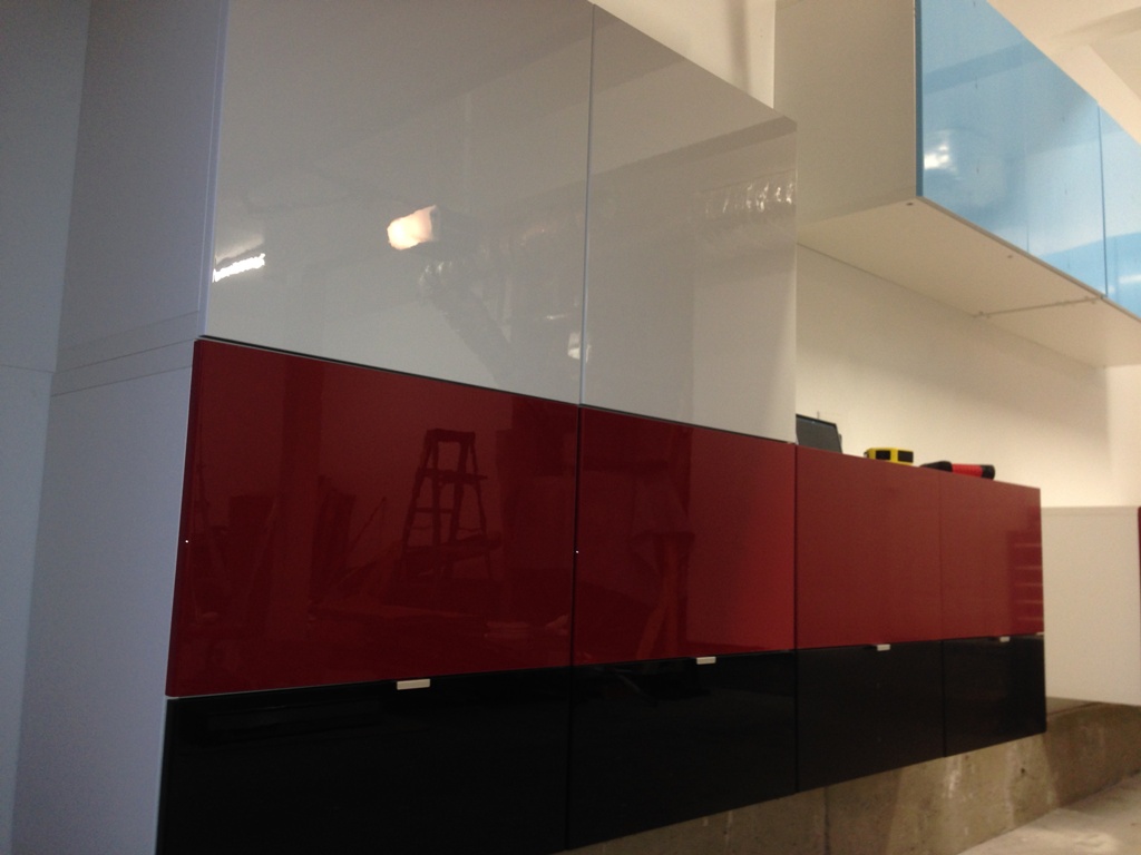

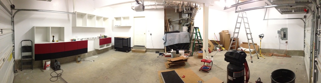

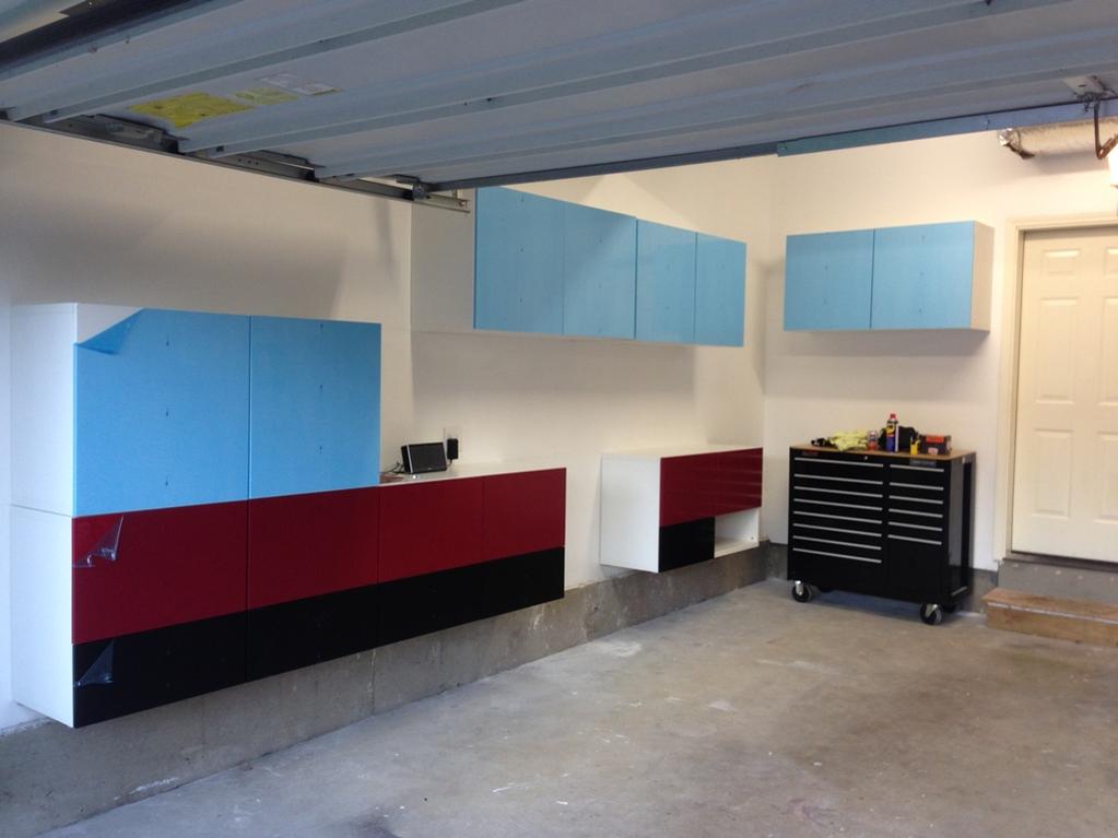

Surprisingly, the best option I found was from IKEA. Who would have thought? IKEA has a cabinet system intended for indoors. It's called the Besta. What I really liked about it is all the configurations you have to choose from. You can choose what size, color, finish are on the doors. You can add drawer systems, shelves, lights, etc. And since I had a set for our library, I was already familiar with the construction. The only challenge was to be able to mount everything on the wall and still be able to support the weight of what is in them.
So, I went to our local IKEA and spoke to one of the salesman in the dept. He was extremely helpful in how to mount them and gave me some great ideas. I originally wanted some taller cabinets but he said that I should just use a bunch of smaller ones and install them on top of each other. Effectively, making it look like one tall cabinet. That way, each cabinet is supporting itself versus only having one mount for a taller cabinet. He seemed to be just as excited about my garage as I was.
So this is what I ended up with...
Those are 7 separate units all the same size. They are about 48x25x16. You can already see the combinations you can choose from. The red doors are cabinets and the black are fully extended drawers with a soft close option. You guys know how I am about red and black. What's neat about the system is the red and black combination is the same size as the upper doors that will ultimately be white. And being able to choose your door color was the kicker. I went with all gloss so that they could easily be wiped down.
But it also looks like I'll be waxing them too!

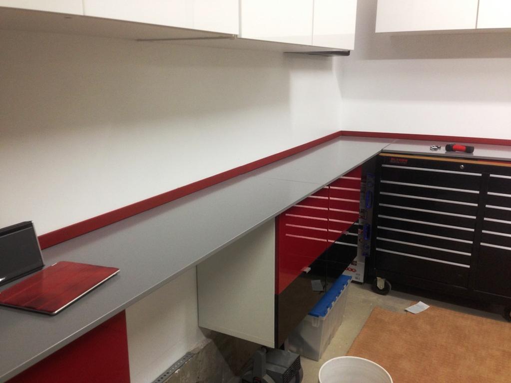

Another great find at IKEA is the "as is" section. You'll find all kinds of doors, panels, table tops, etc. Mostly from just being in their display or returns. There might me a couple of small scratches here and there but overall most of the things there are brand new.
I found two 3x8 gray panels there for $60 ea. They're pretty sturdy and I can only guess they're some sort of MDF. Easy to work with and the finish on them seems durable. I got these with the intention of making counter tops. I got them home and cut 'em all up. I used the tops of some of the cabinets to support it along with some braces on the studs. Got some cheap crown moulding, painted them red and made cheap counter tops.

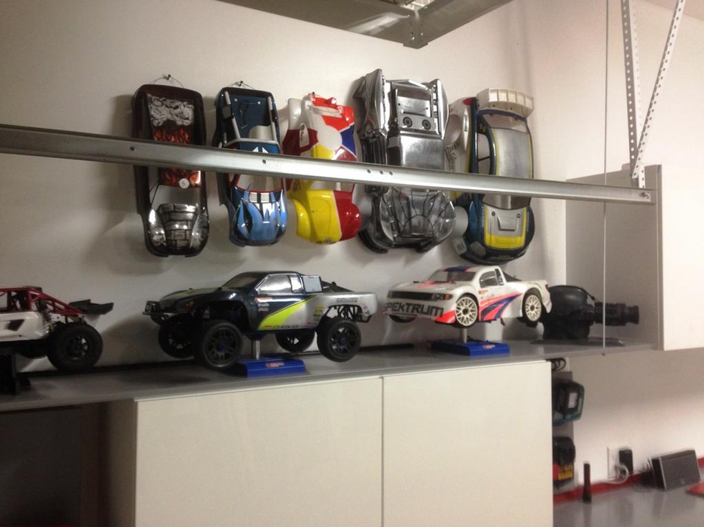

After all of the counters were done, I still had some random scraps left over. I decided to make another "shelf" above the cabinets. Used a wall bracket on one side and all thread on the other for support. I didn't want all of the weight to be on top of the cabinets. There's also some left over red trim so I used that as the rear support of the shelf.

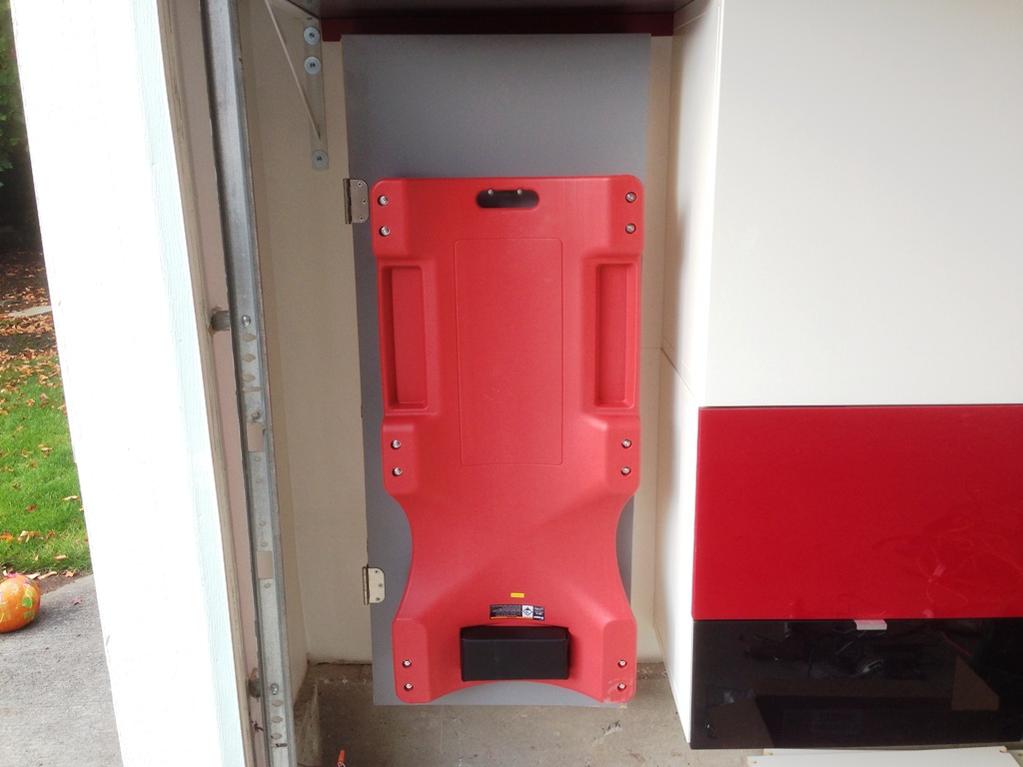

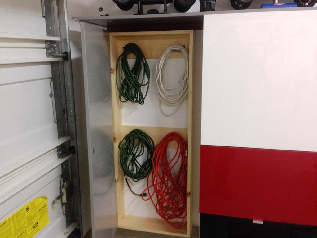

There was one more piece of counter top left. I decided to make this one a door. I fabricated a cabinet out of some plain 3/4 x 6 white wood boards. Cut them to match the size of what was left over. This cabinet is going to specifically hold my extension cords.
Then I thought, what about the front of this board? I can hang my creeper there for easy access and still open the door for the ext. cords.

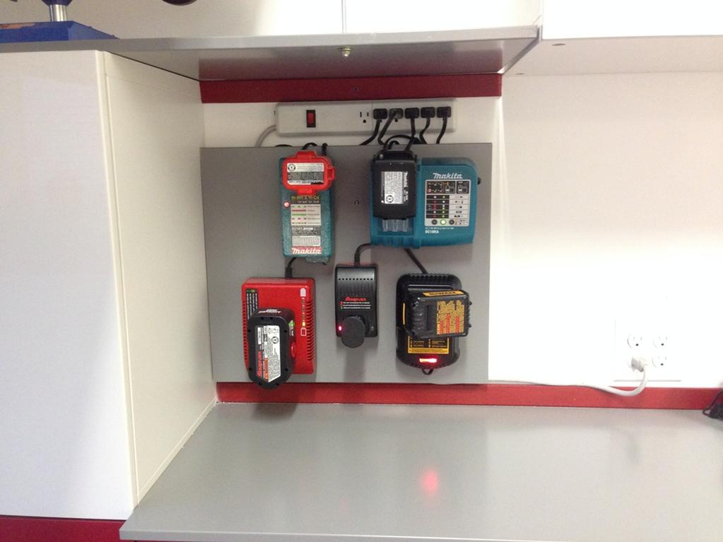

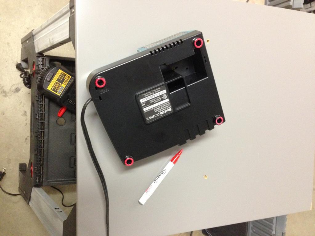

One last thing with the piece of scrap counter top left. I needed a charging station. I didn't want to use any counter space. I thought about making one of the cabinets a charging station but I was a little skeptical about the heat. So, I came up with a little charging wall.

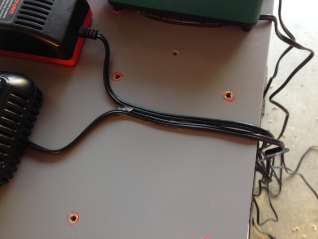

I wanted to mount all of my chargers to a specific area. I needed to mark where the "feet" of all the bases were so that I could route the wires and mount the chargers. I used a red paint pen to mark the feel and carefully "stamped" them onto the counter top. This allowed me to mark where I needed to drill.
Get them all layed out and start drilling some holes.

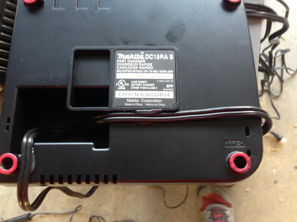

Or course I'm going to get a little anal about the wiring, so I hot glued them into place. I didn't want them flopping all over the place.
Find a stud and mount the wall up. Still have some room if I need to add another charger.

What if you need to take any of your cordless tools somewhere, and charge them there?
I've got at least 2 of each battery. If I'm going to be out of my garage to use my tools for that long, I just have to unbolt 2 screws and the whole thing can come with me. I can't really imagine a scenario that would require me to use that much battery time.
The main reason for building this charge wall are for the NiMh and still some NiCd batteries that I have. It doesn't matter so much with the Lipo and LiFe batteries. But you really have to keep the NiMh and NiCds on a charger to prevent them from retaining a "memory".

:jk: by far my favorite mod in your garage build up! May I ask you, how did you screw into the feet? Did you basically get a longer screw and removed the factory screw, and screwed directly it into that?
