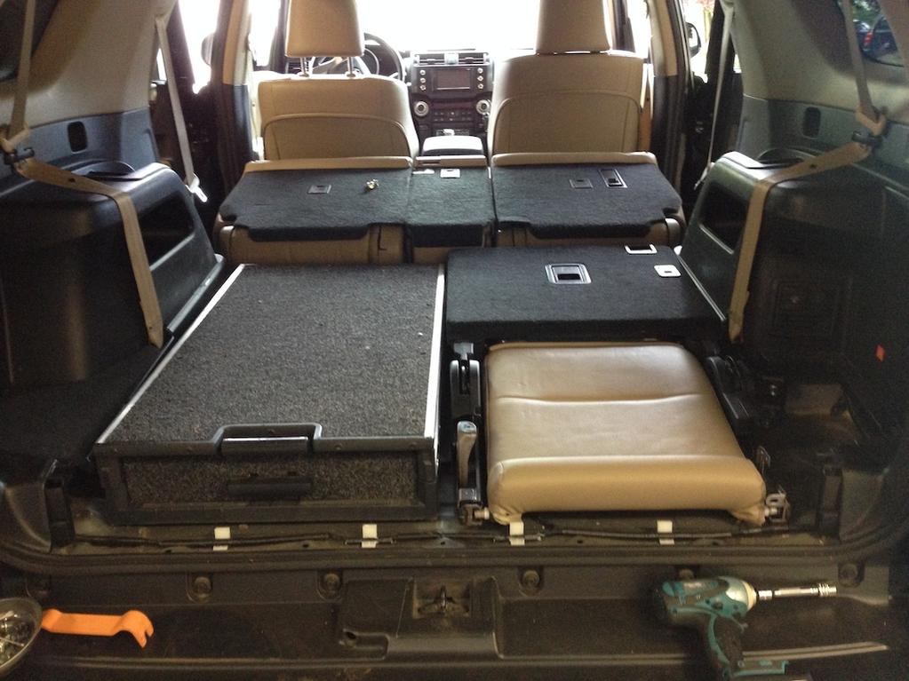

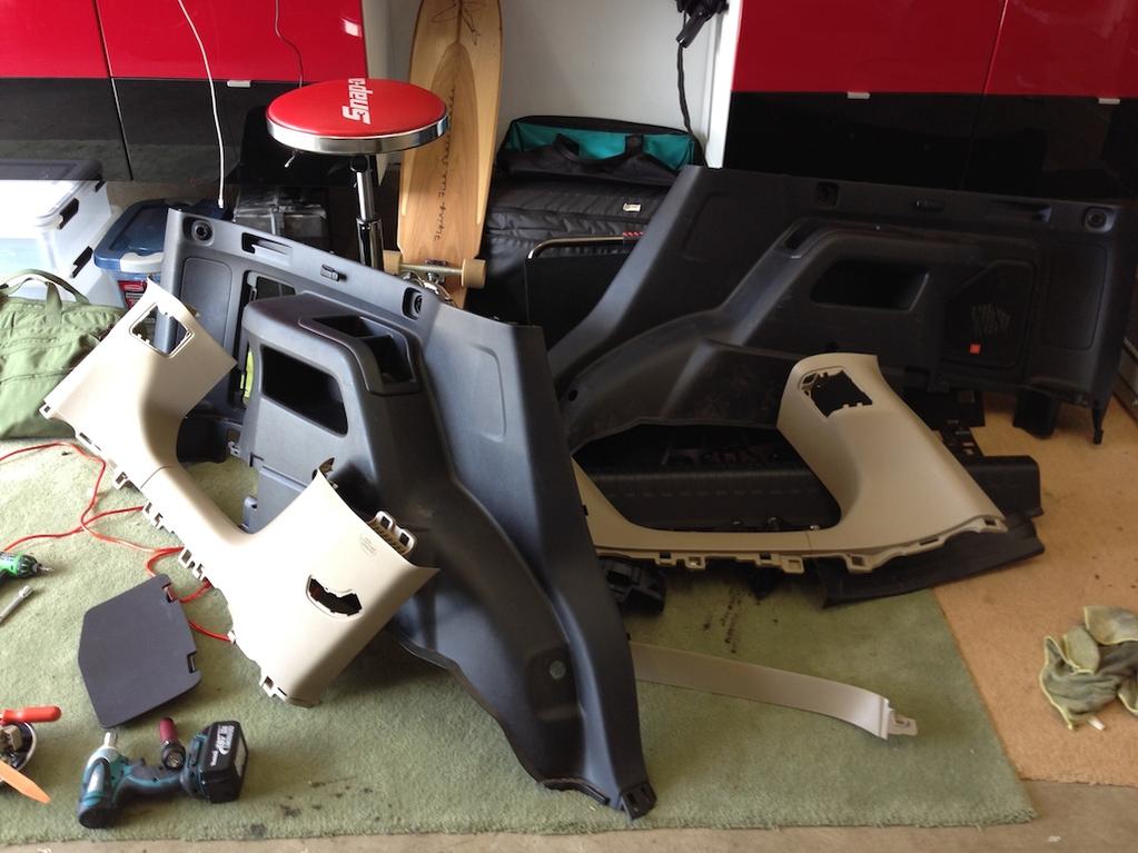

The interior of my truck has been apart for the past couple of weeks. Now that the kids are in school full time, I've got some mod time to myself.
Disclaimer: All of these are done in a 2011 LE with 3rd row. Some of the mods are geared towards that. I really use the 3rd row especially with visitors. The kids are small enough and comfortable in the back back.

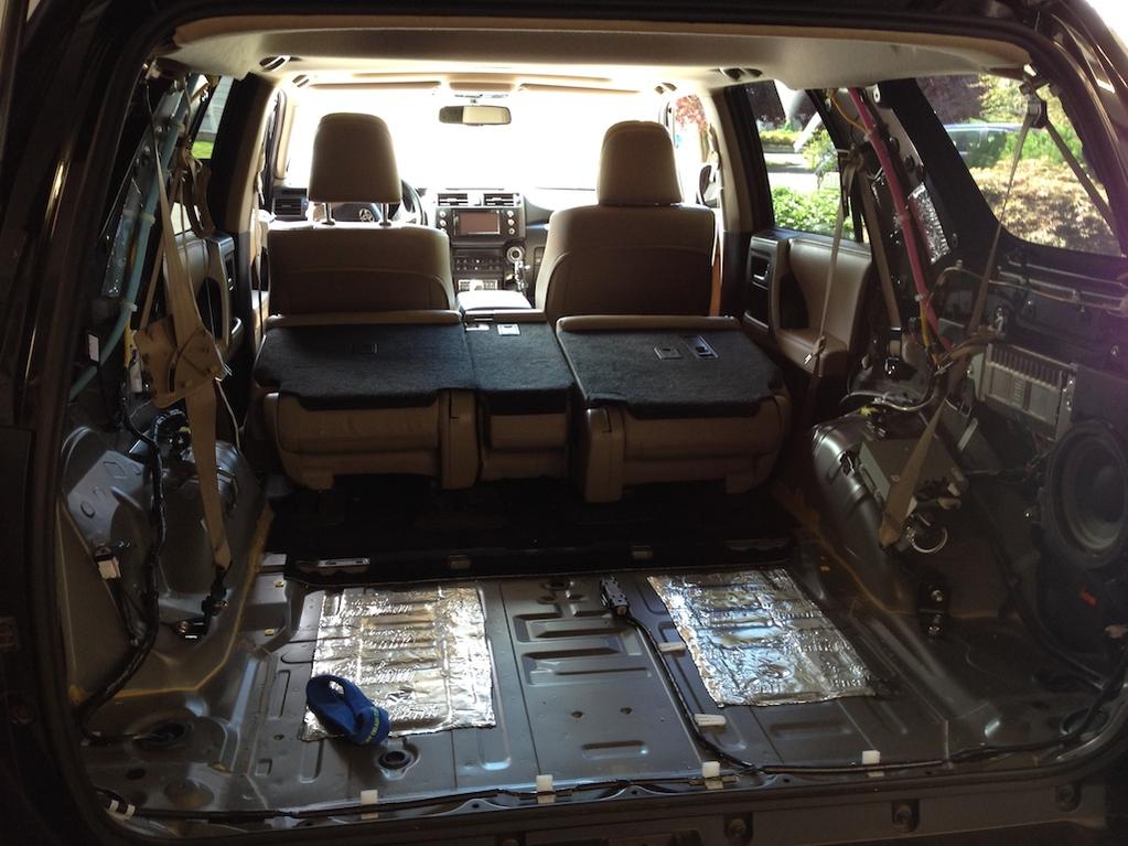

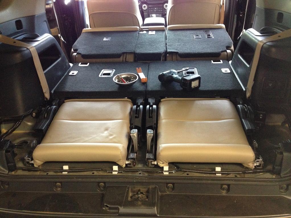

Time to rip it apart!

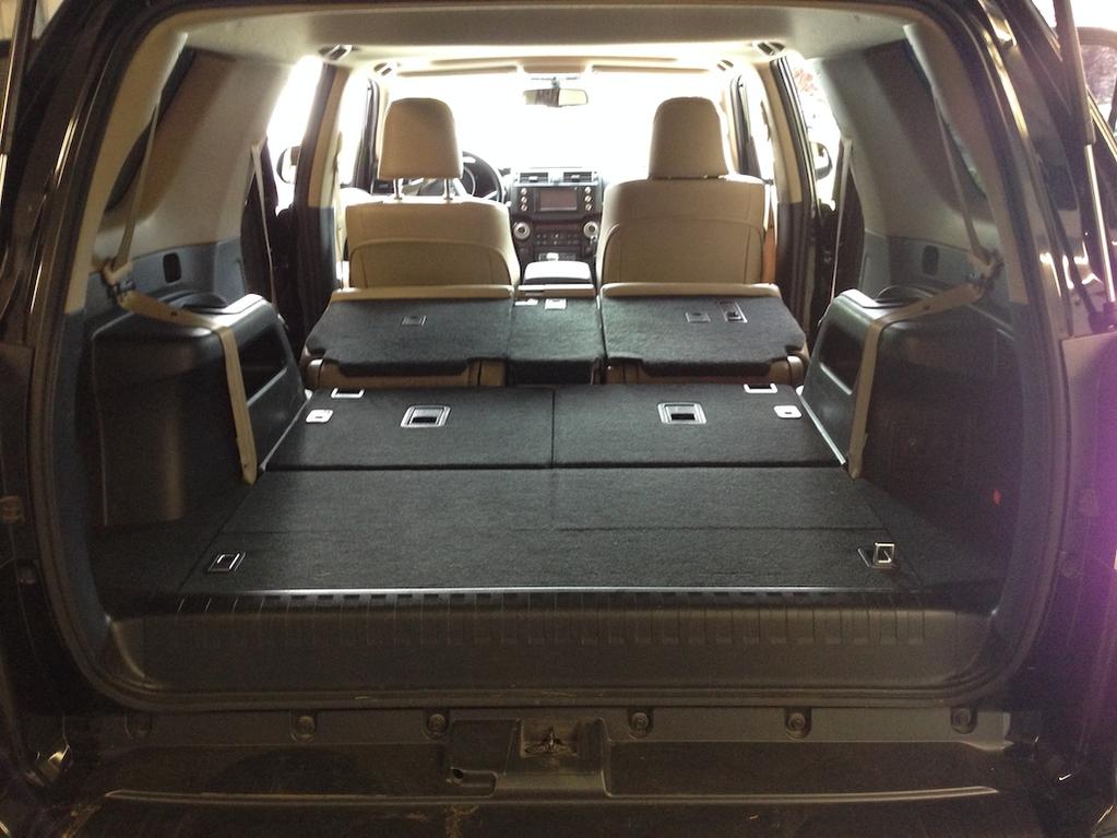

This is what an LE with 3rd row looks like with everything folded down.
Remove a couple of trim pieces
3rd row seats exposed

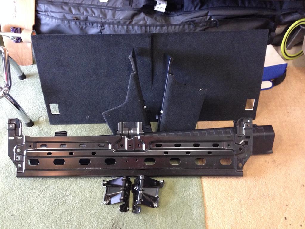

Ultimately, I will have only one seat in the back and I'll finally bolt down my ARB fridge slide and drawer. Its almost as if it was designed that way. The floor is fairly even with the ARB drawer and the other 3rd row seat.
And let's rip apart the rest of the rear interior.

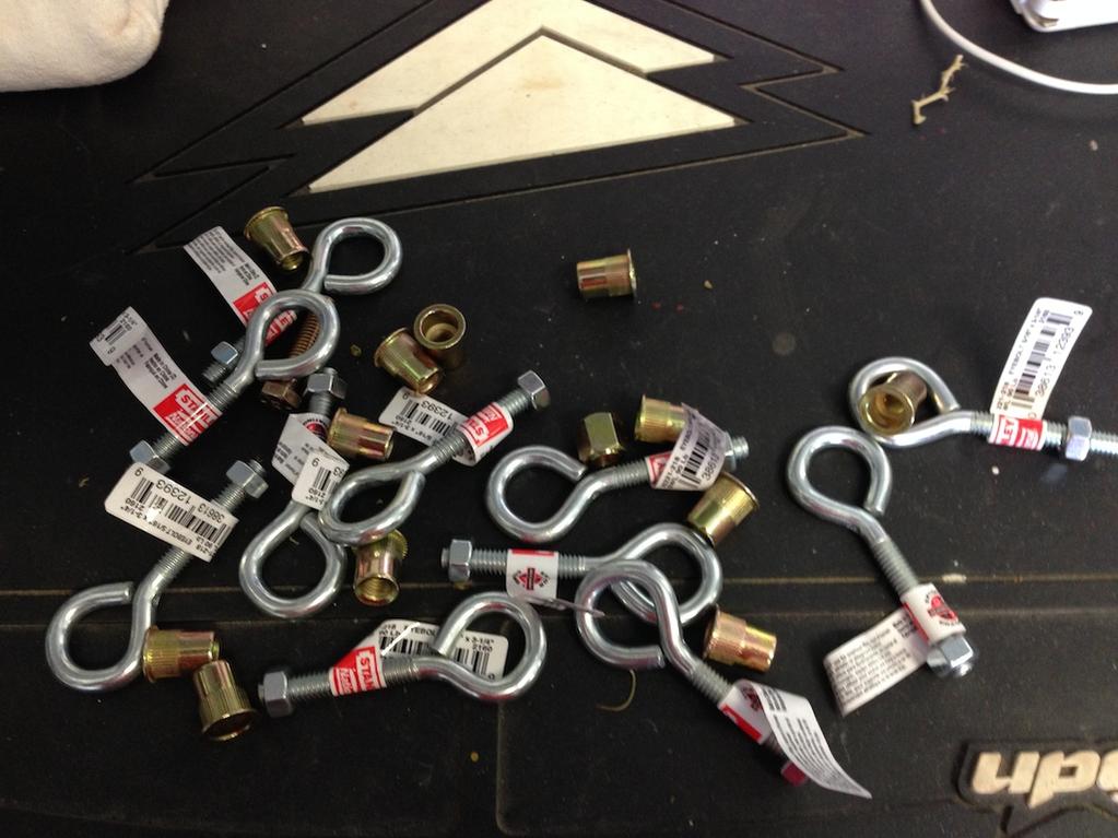

Here's some hardware for my "cargo system" I'll be going over a little later. Still waiting on some parts.

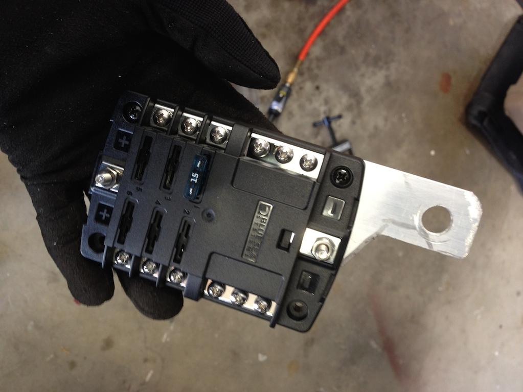

A couple of mods needed to be done at the same time. I was tired of my 40" not lighting up completely with the truck off. So I needed to run a decent size gauge wire to the light. This brought up a couple of things.
I need to run 4ga to the back of the truck so I can run a fridge (when I get one), 12v outlet that is on constant, and power and relays for the lights on the rack. I used a typical Blue Sea fuse box and fabricated a bracket as seen here. The funky shape allows me to use it on an existing 3rd row seat belt mount. I also wanted to be able to access it with the 3rd row still assembled, up or down.
Getting some of the wiring attached.

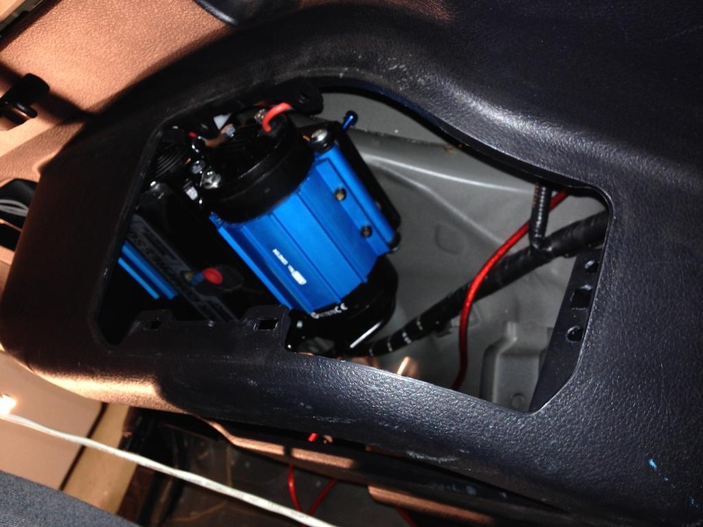

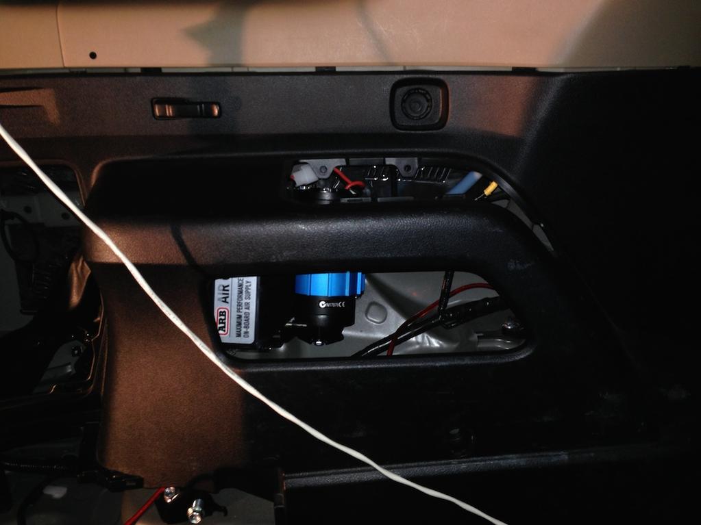

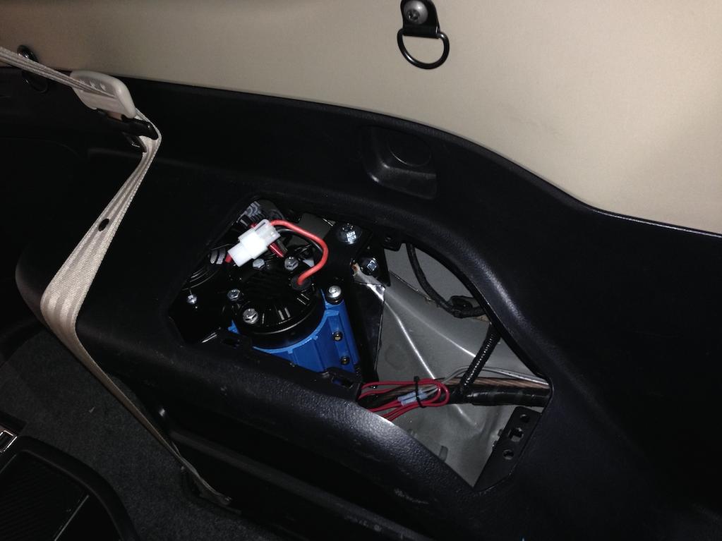

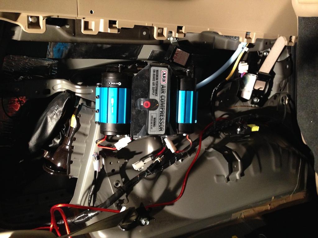

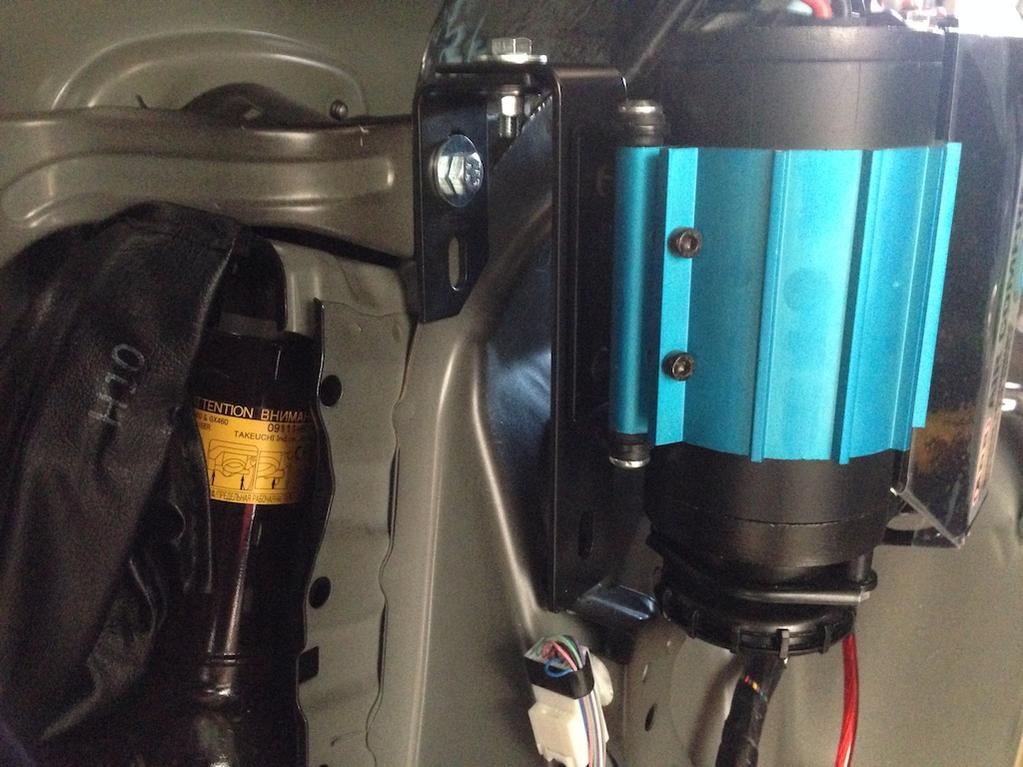

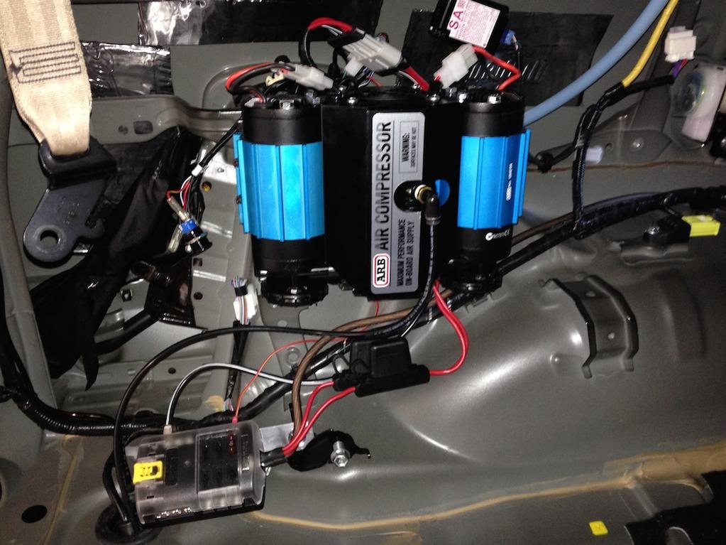

I'm finally going to get to install my ARB compressor! It's been sitting in my toolbox for over a year now. I was originally going to install it in the engine bay but since I was wiring up another fuse box and running 4ga wire to the back, why not find a way to mount it in the interior.
Again, I'm sure the rear quarter panels are similar between 4R trims but I can only show you what I did with an LE and 3rd row.
Found a place with a ton of room. I needed to temporarily hang it to check clearances again with the interior panels. There's a wheel well "lip" that I bolted it to temporarily. I'll have to make some brackets to make the mount solid.
Yes, they are mounted two different ways. I was experimenting with the air outlet and wiring orientation. Ultimately, the air filter will be installed towards the bottom.

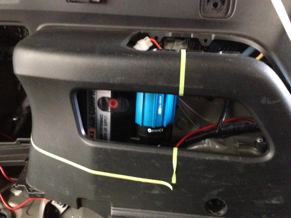

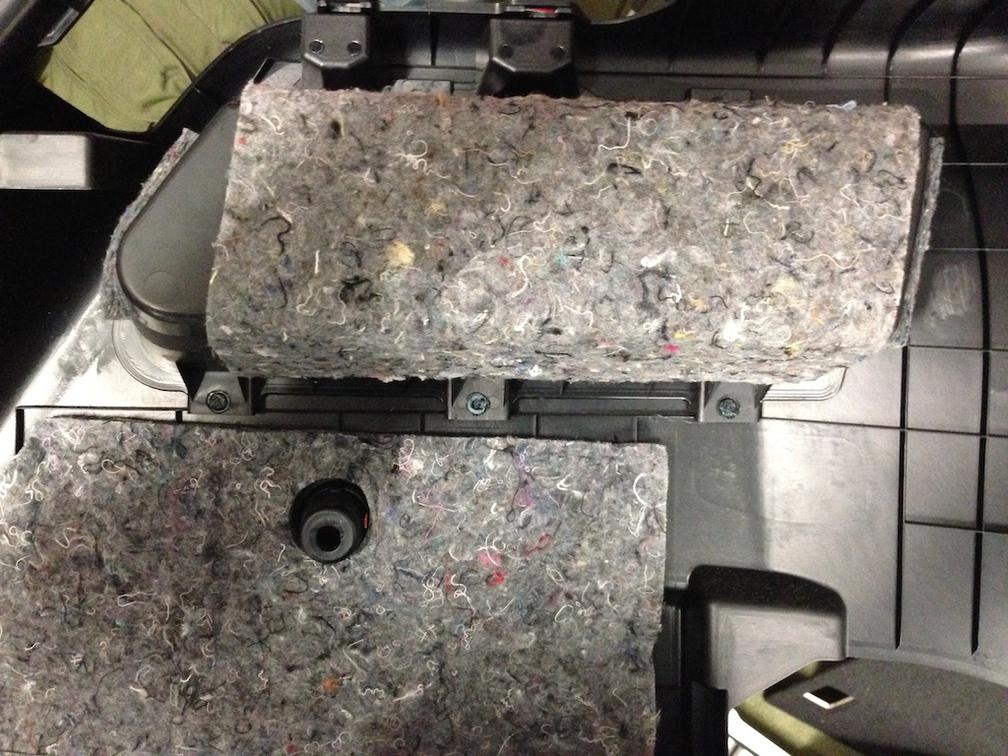

Aaaaannnnd, reinstall the interior again! This is probably the most annoying part of modding. Having to check clearances for anything you're installing. Honestly, it wouldn't be so bad if I didn't have to reinstall half of the truck check to check one thing. But, as they say, "measure once....".
Ignore the old wiring that's still hanging for the roof lights. That will be removed and replaced with 10ga later.

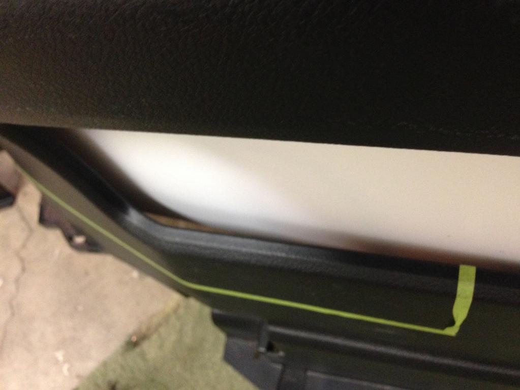

I put some masking tape to create my imaginary line that will guide me for when I modify the pockets for the 3rd row.

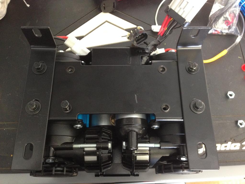

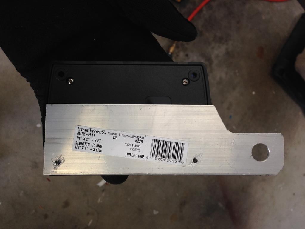

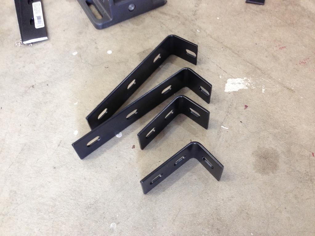

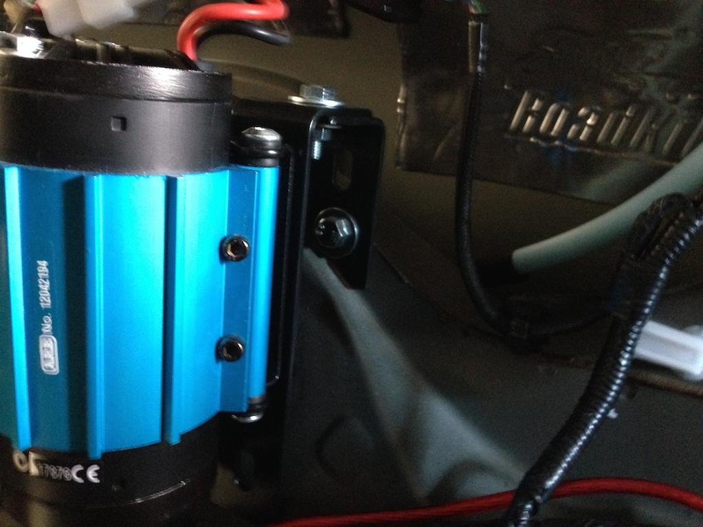

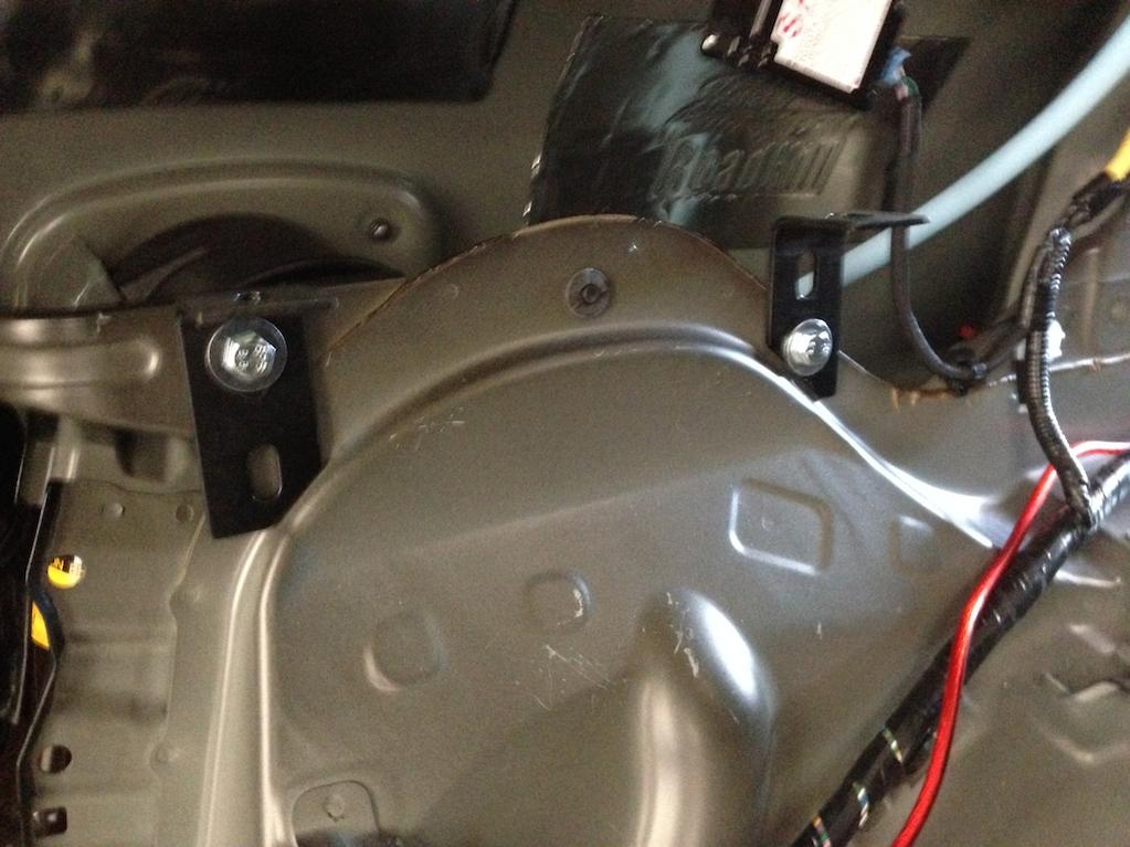

Now to mount this sucker. I can't tell you how much I miss having a shop to work in. Don't get me wrong, it's great to have a garage now, but I definitely miss the equipment and hardware that was made available to me. Not to mention the guys I worked with.
Anyway, I went to a local hardware store and picked up some angle. I think it was in the fencing section. Cut and slightly modified.
Mounted the smaller of the L brackets to the wheel well and cut to fit again.
Mount the longer ones to the compressor.
And then bolt the 2 brackets together. This ended up being an extremely solid mount. I cut the longer bracket so that it would sit on the "shelf" as seen here just above the white plug. I'm going to also use more sound deadening to hopefully quiet down the interior.
And the front mount.

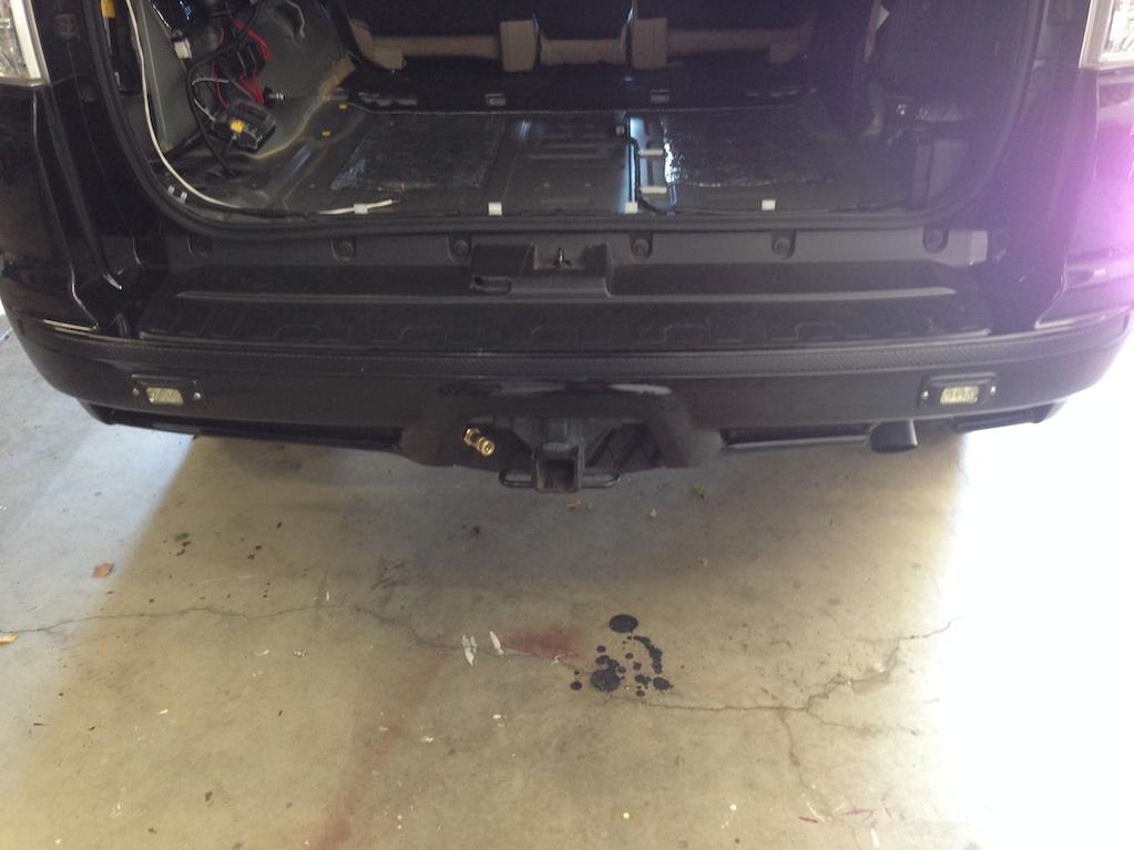

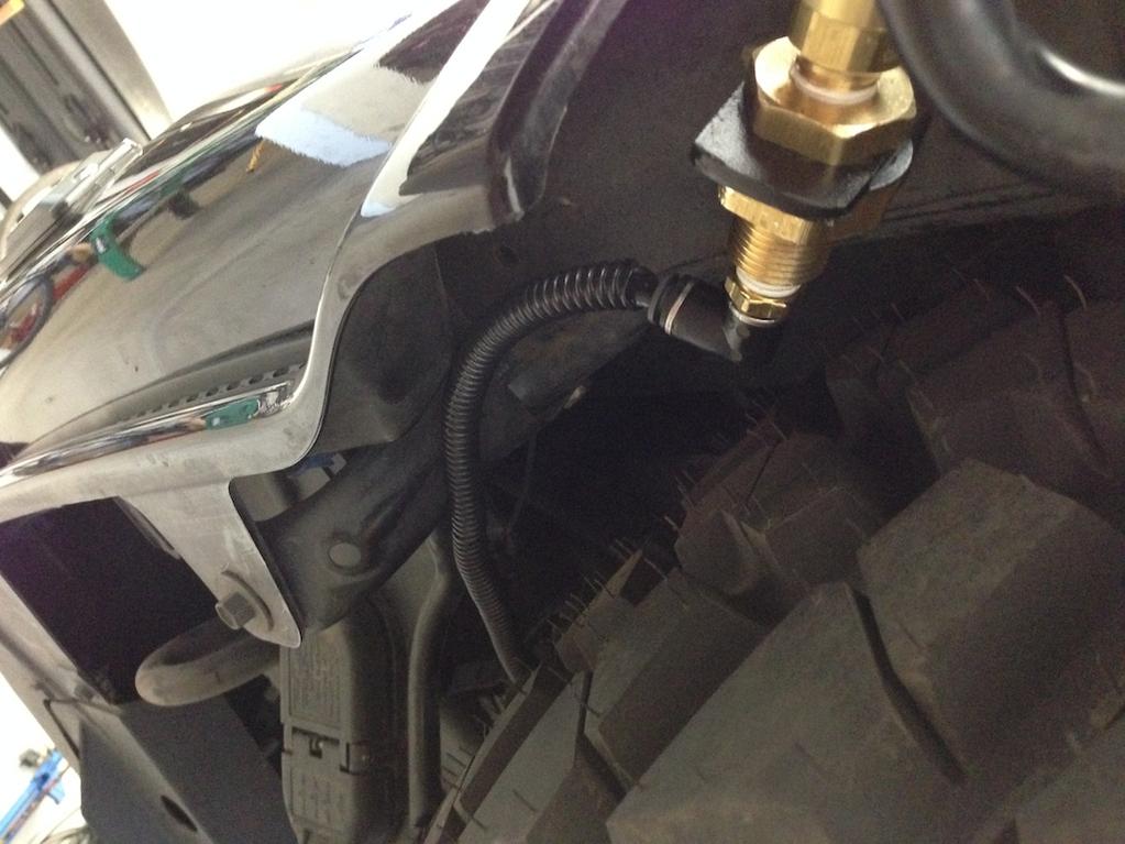

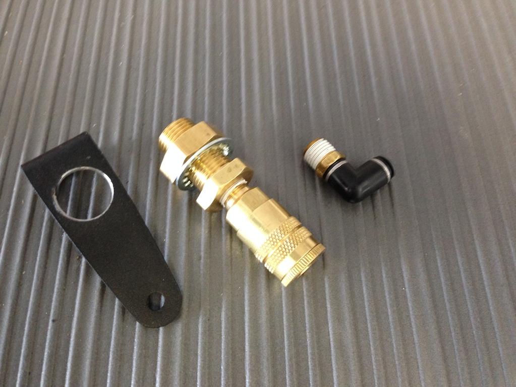

Reduce, reuse, and recycle, right? Here's some hardware courtesy of a Rigid Industries light bar. Drill a hole and mount the air fitting. I wanted to put it somewhere where it would be protected and inconspicuous. I think I accomplished that.
Routed the air hose through the grommet in the floor on the drivers side.
Cut the end of the light bracket and mounted it underneath near the hitch.
And what it looks like from behind.

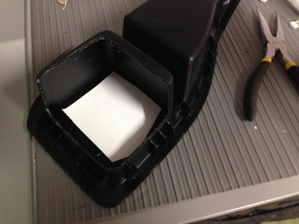

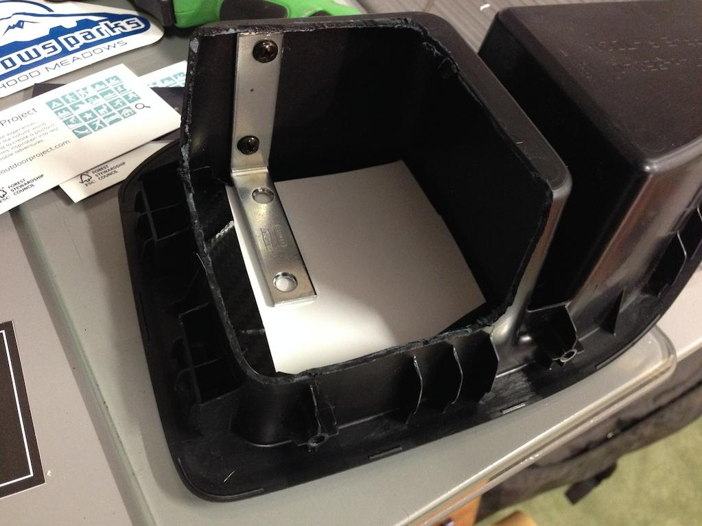

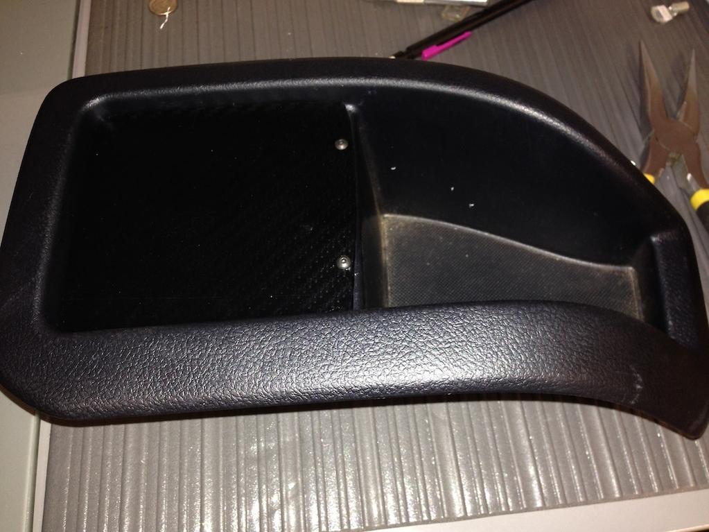

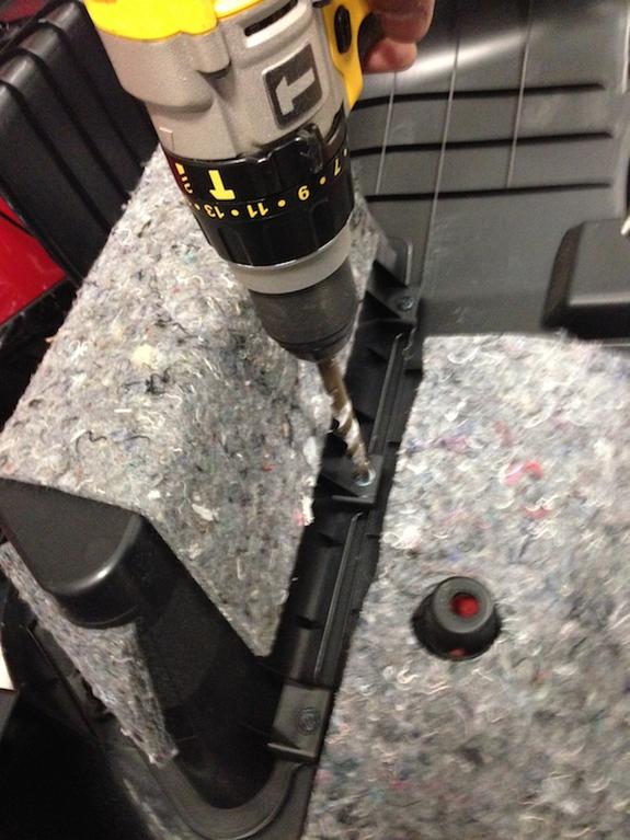

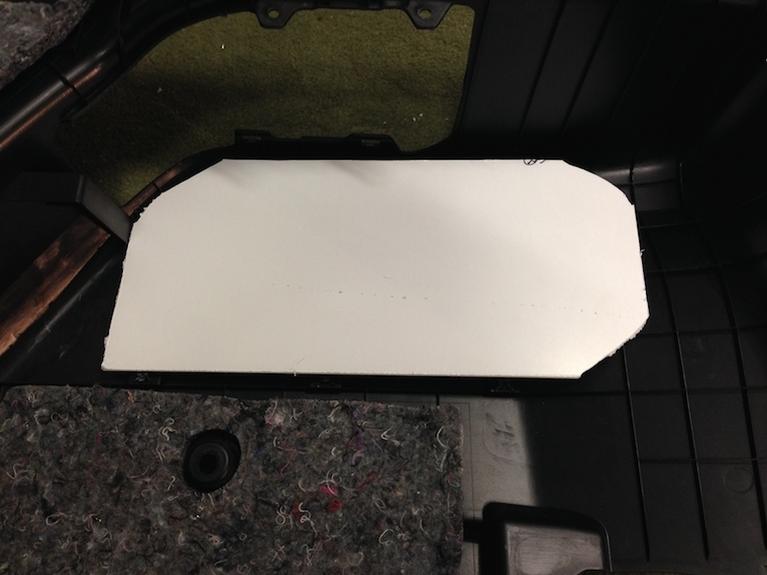

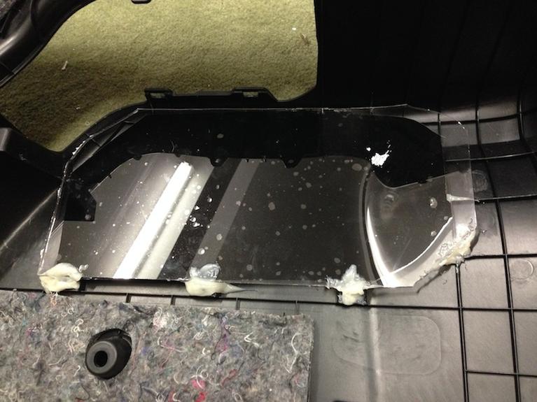

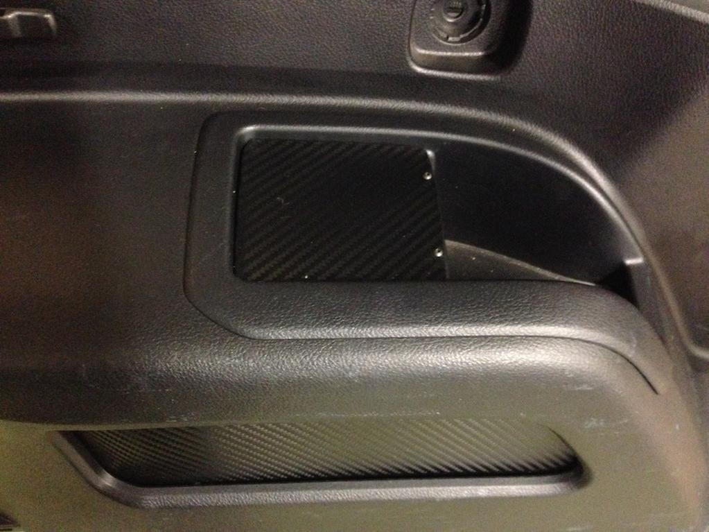

Now to deal with the interior pockets of the 3rd row. The top pockets were easy to deal with. 2 screws and it pops off. The bottom one, however was plastic welded to the panel.
Here's the back of the panel.
Where you have to drill 6 plastic rivets off. Don't get crazy and go to far here. Or that's gonna be an expensive mistake.
Cut out the rear pocket of the top. I left as much of the corners as possible to help keep the pocket itself sturdy. This is 1/8 plex with di noc wrapped. Of course, you didn't think I'd do something without some Di Noc! Actually, I just have a ton of it left over.
There are 2 screws holding the front of the plex. They are drilled through and bolted down.
I put a piece of angle to support the back of the panel. Now there's no flex from the plex. This still makes this cubby useable by the 3rd row. Not that anyone is going to put anything in there but if you're gonna do it, might as well do it right.

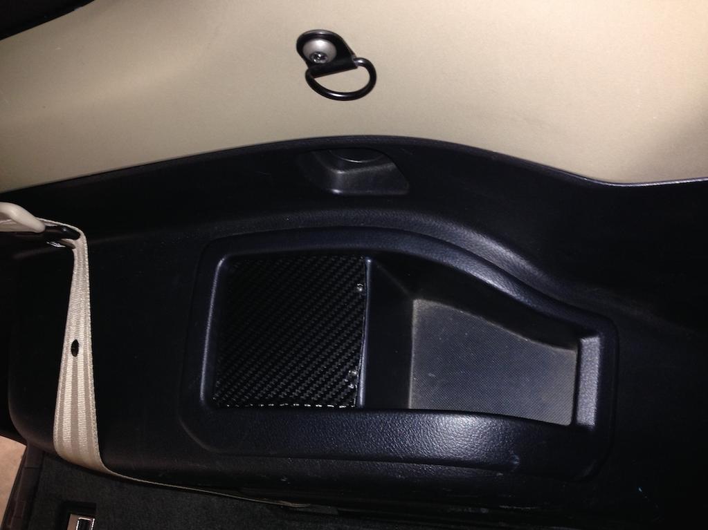

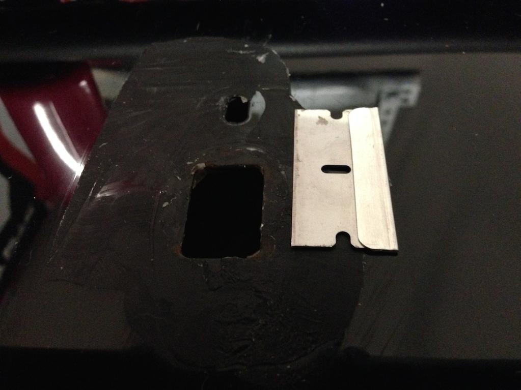

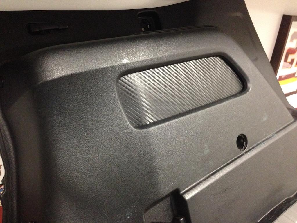

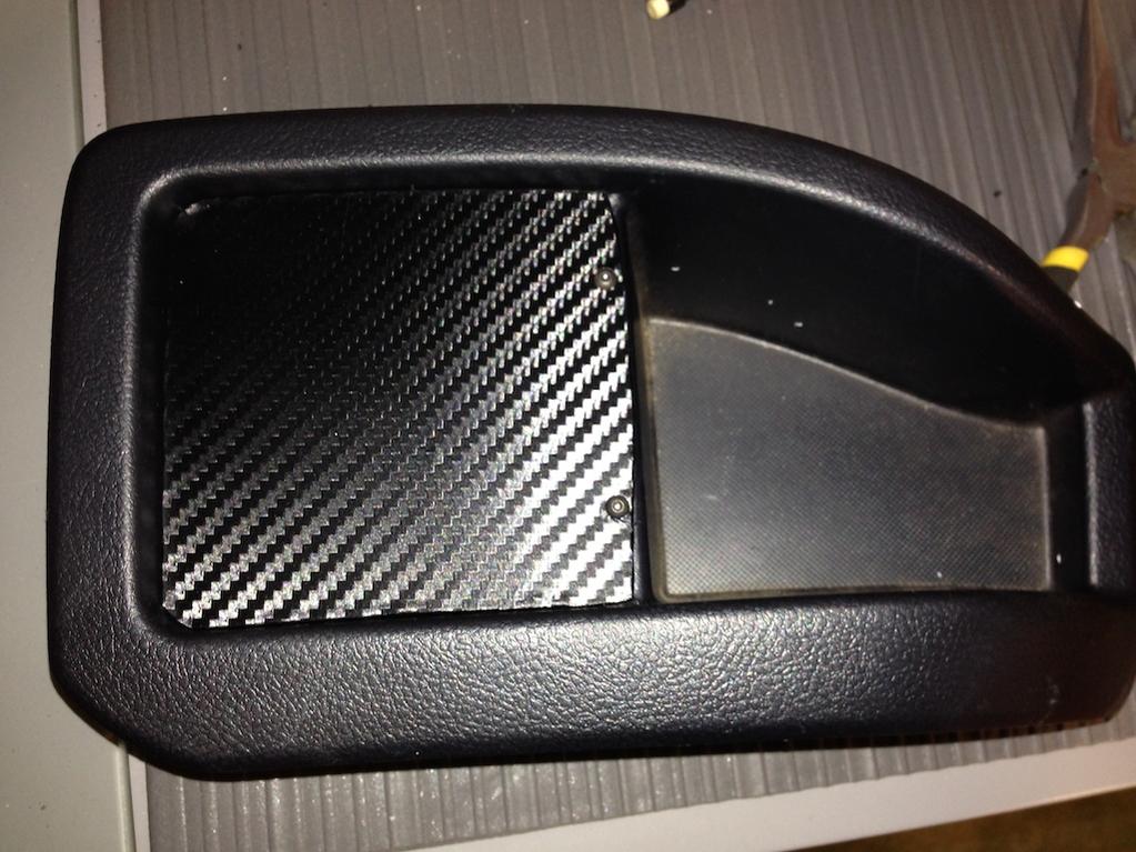

The bottom pocket proved to be a little more challenging. There is a slight curve in the panel. It didn't matter when there was a pocket there but I've got to build a plate. So I used 1/4 plex so it could withstand some heat and mold to the shape I needed it to.
Cut it out to mimic the shape as best as possible.
Heat it up to try and conform the shape.
Wrapped in Di Noc :yo: and epoxied into place. I used a specific plastic epoxy from Loc-tite. Cures in 20mins but smells like holy hell!
I was able to follow the flow of the panel pretty well. And it's definitely not going anywhere.

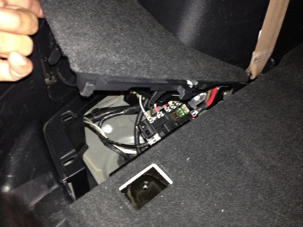

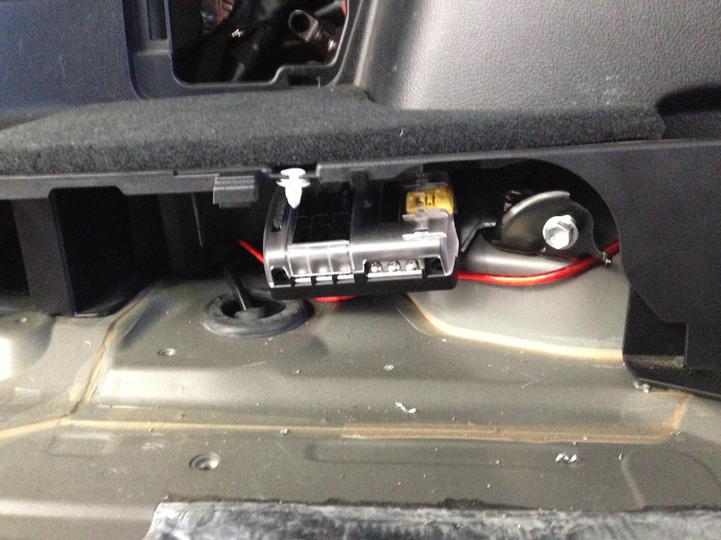

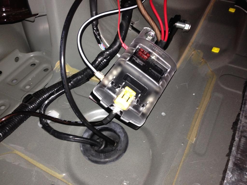

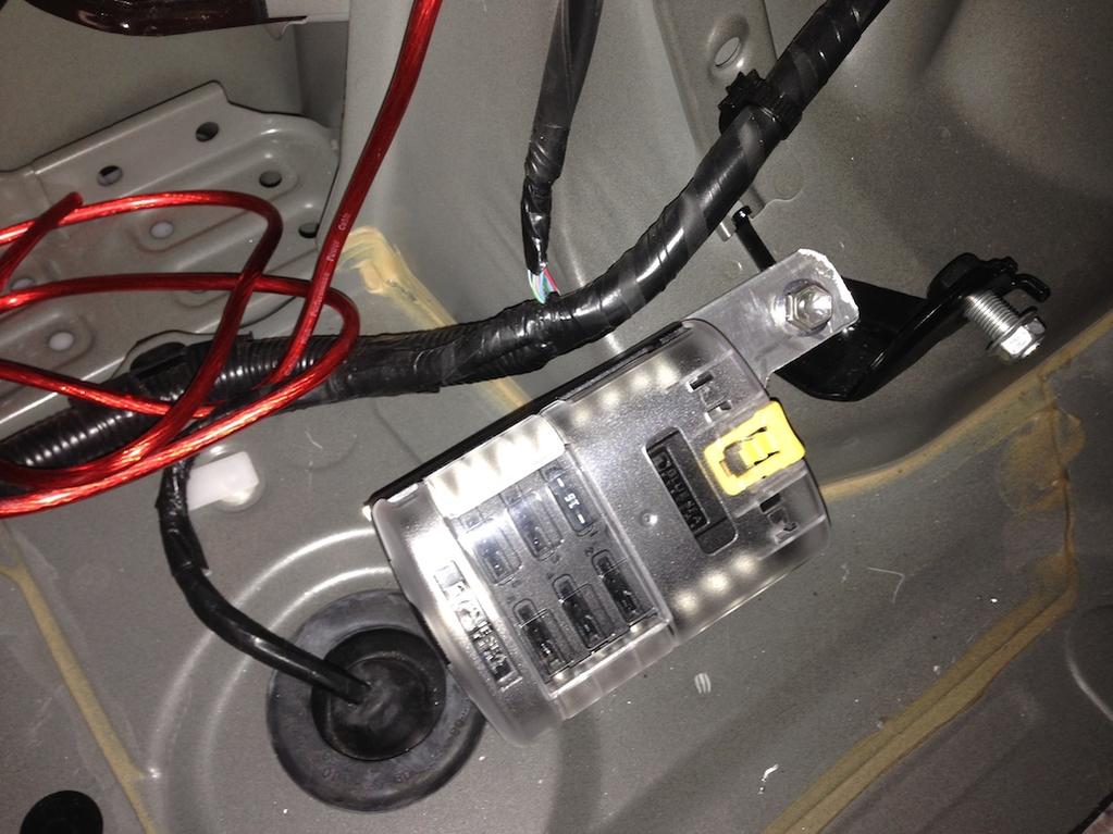

Functionality. I was originally going to use some sort of mesh for the top pocket for ventilation. But I didn't want any compressor noise to travel into the cab if it wasn't necessary. So the nice thing is, I can pop off the top pocket if I feel the compressor is getting too hot.
The fuse panel is very accessible. Pop the side panel off and you're golden.

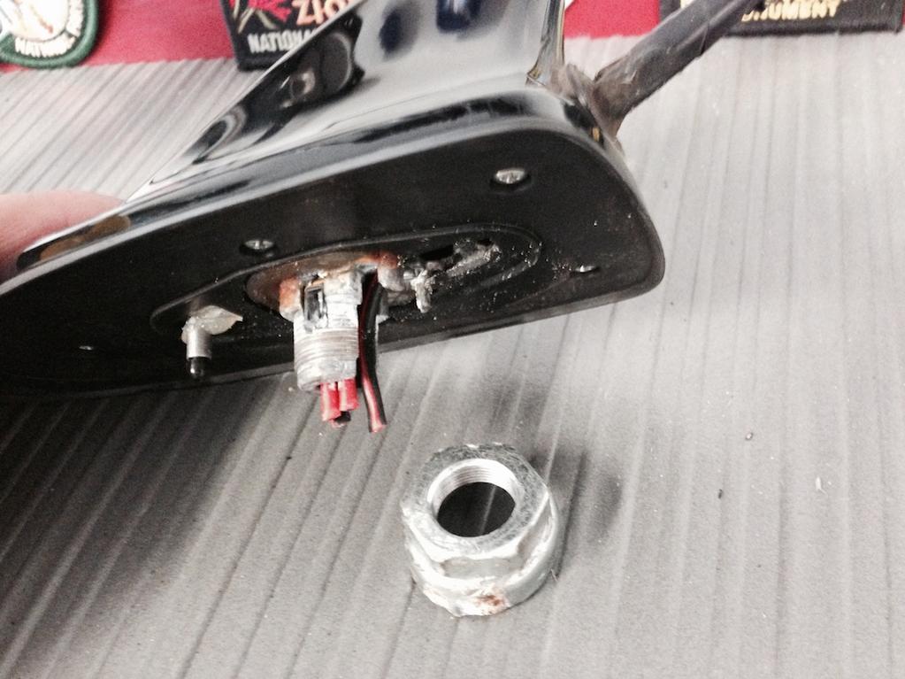

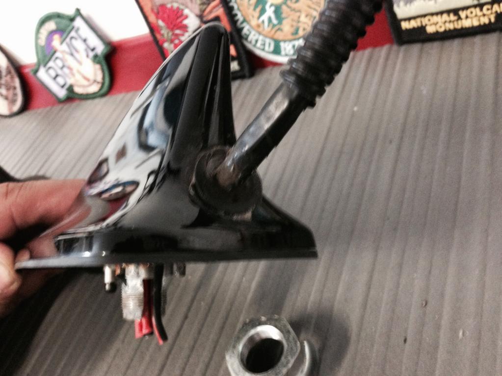

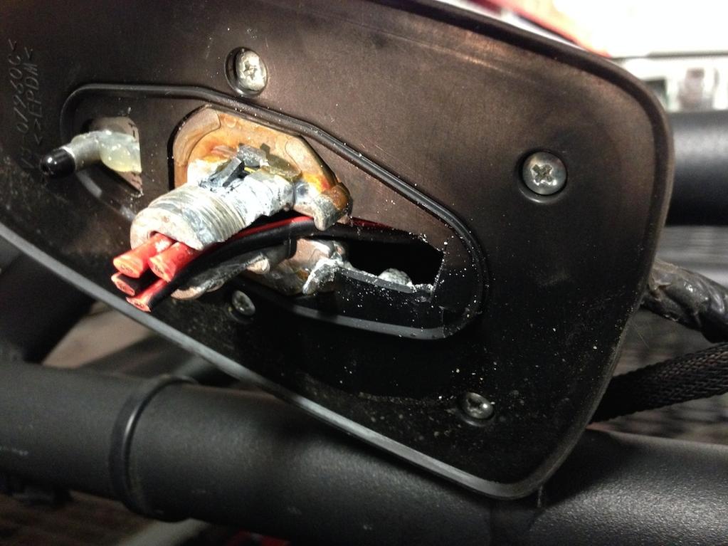

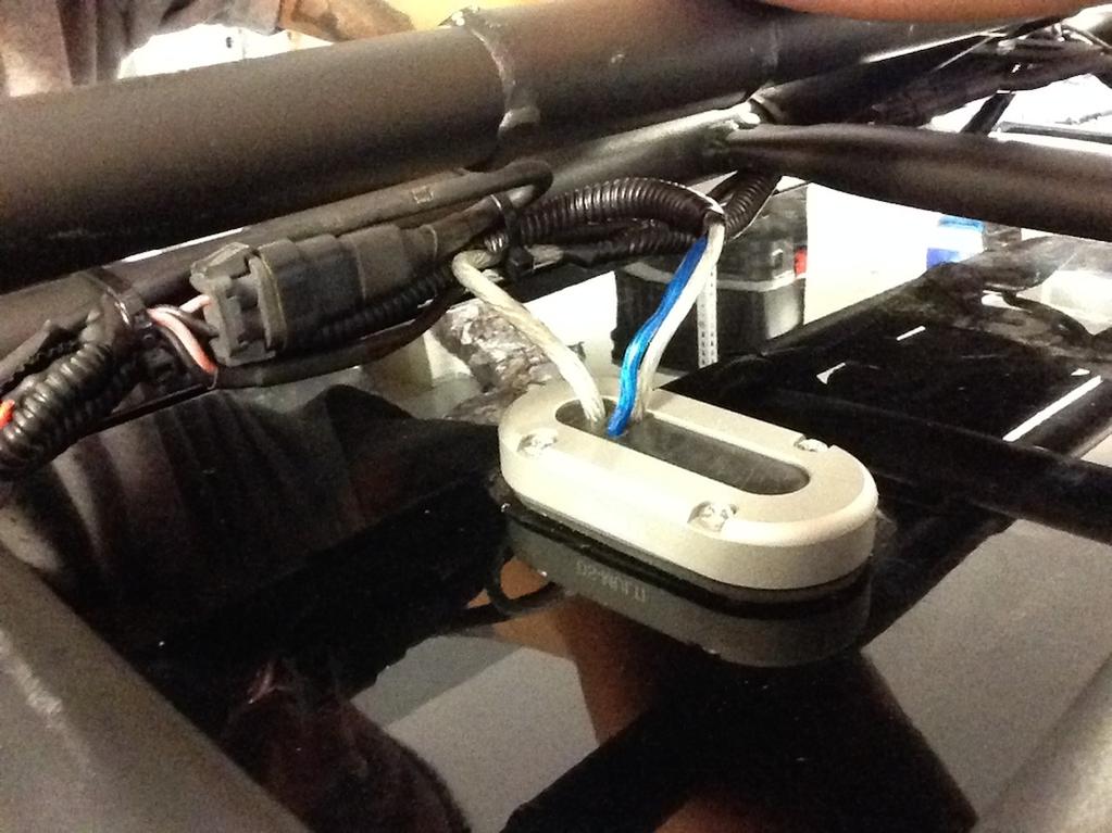

Alright, so part of the reason for running the 4ga to the back of the truck is so that I can run 10ga to the 40" light bar. But in order to get 10ga to the light bar, I needed a different way to seal the roof. As some of you may know, I gutted the innards of the shark fin antenna. There is no room for 10ga to run through the bolt of the shark fin.
For those that are curious as to what's under the shark fin...
Here's how it exited the shark fin. These are 4 12ga wires coming out of the grommet
A better look
And here's a good shot of the "through bolt" that the wires have to pass through to get into the cab.

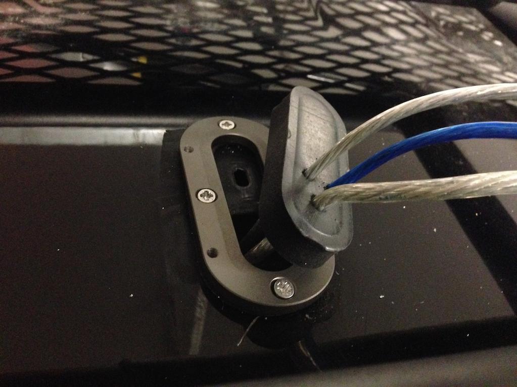

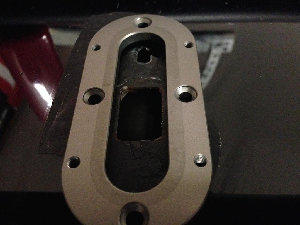

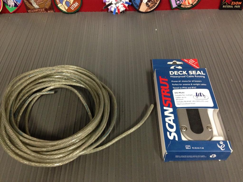

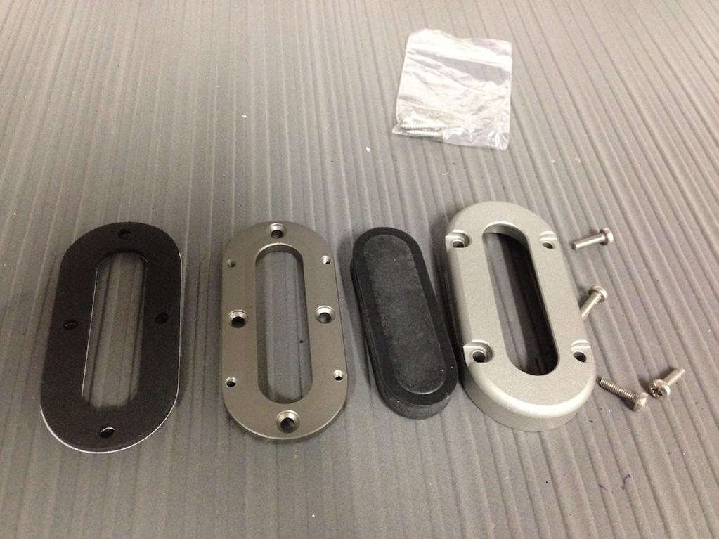

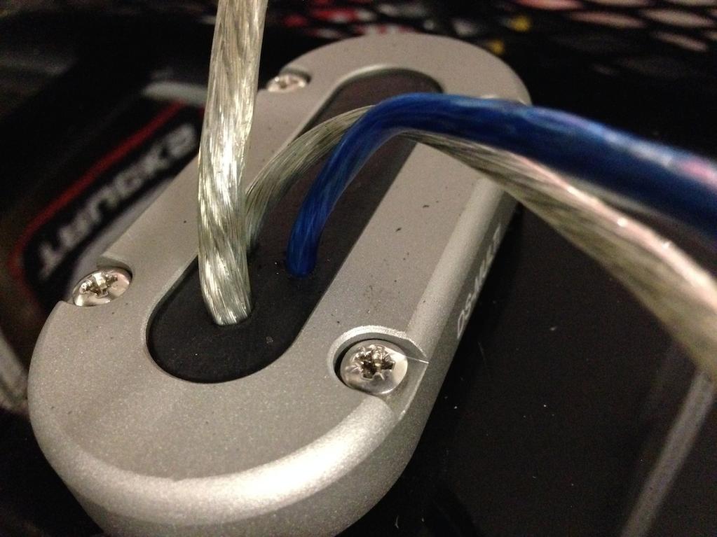

I bought 25ft of 10ga and a Scanstrut bulk head.
The Scanstrut is a marine deck seal. Its components from left to right are the seal, base plate, rubberish poly type pass through, and the top plate. You basically drill a hole into the grommet and push the wire through. Once the top plate goes on, it sandwiches the grommet and "compresses" the grommet around the wire for a completely 100% waterproof seal.
Here's what you're left with on the roof. Please ignore the silicone. I was being overly cautious with the shark fin. I put the razor I used to remove the silicone next to the 2 holes in the roof for size reference. Scanstrut makes a smaller deck seal but I wasn't confident that it would cover both holes. And the added benefit of the larger deck seal is there is plenty of room for additional wires for antennas or more electrical.
Find a good place to center your base plate and drill through.
Drill the required holes for how ever many wires you're passing through and run your wires.
Sandwich the grommet in between and bolt down your top plate.
Clean up your wiring and you're done.

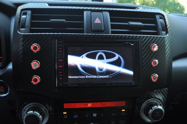

The Wired HDH system is really nice. It's very self explanatory when it comes to wiring. I hid the main module under the driver's seat. Pre-wired eight wires to go into the engine bay. They will connect to two of the Wired Wagon relay boxes. Each relay box has 5 circuits, each with its own power lead. So I needed two of them for a total of 10. The Wired HDH system has switches for 8.
If you recall, I already have 6 switches on my dash next to the head unit.
I guess you could say I've got a thing for switches. Maybe not has bad as Jango does, but I'll take the close second!
So far, switches will be for:

Hey Bobby, is your dash just a generic dash that you wrapped with carbon tape?
Or did you get it somewhere specific? I would like to mount OEM switches in the dash area, do you think it will fit a few?
It's just a Metra kit wrapped in Di-Noc. There is some space behind for the switches but you're limited. Since I have no experience with those OEM switches you have coming from the group buy, I can't tell you if there's enough space. The tamper proof switches that I used have a depth of 5/8".
I'm also concerned with how they mount. I don't believe they are a simple push through design like most universal switches. They may only work in a predetermined factory location. If I remember correctly, the factory style switch requires a "bucket" for the switch to sit in. That's where the retaining clips sit. But, I could be wrong.
