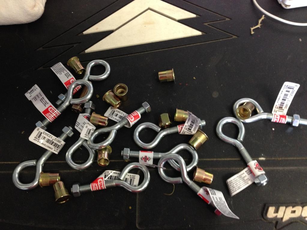

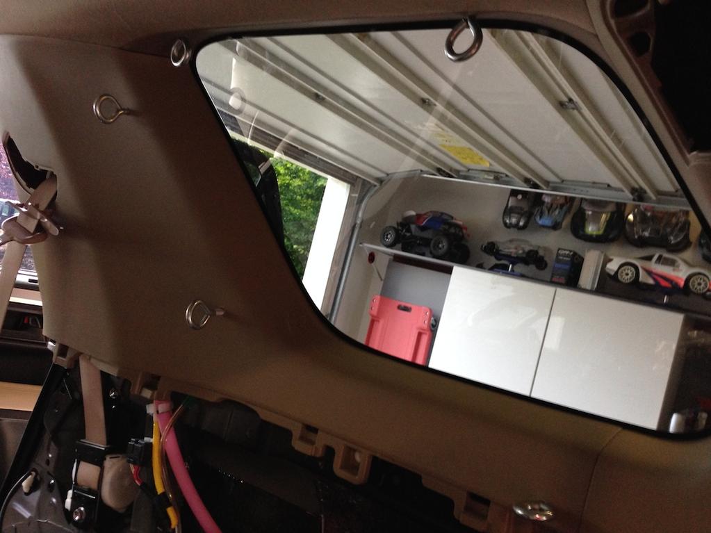

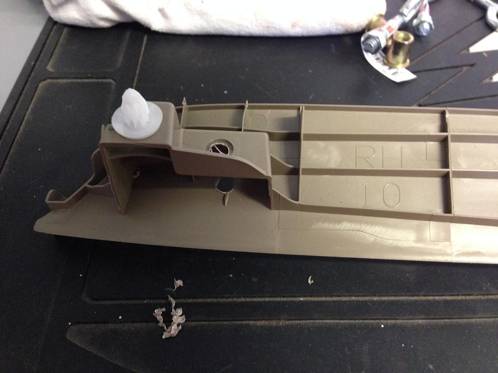

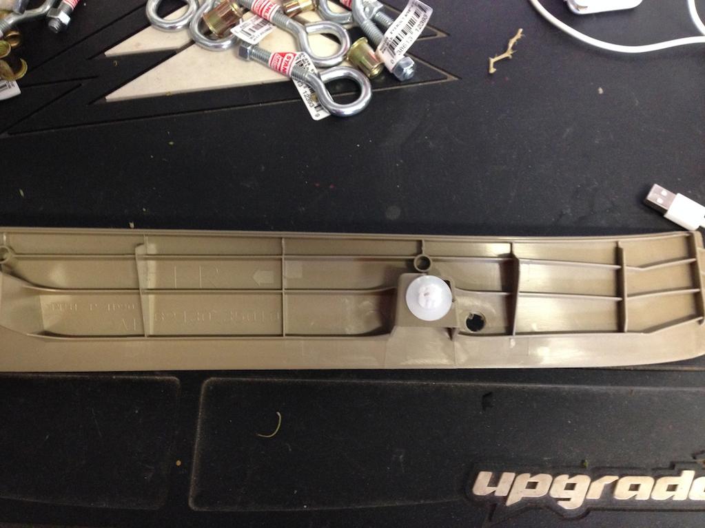

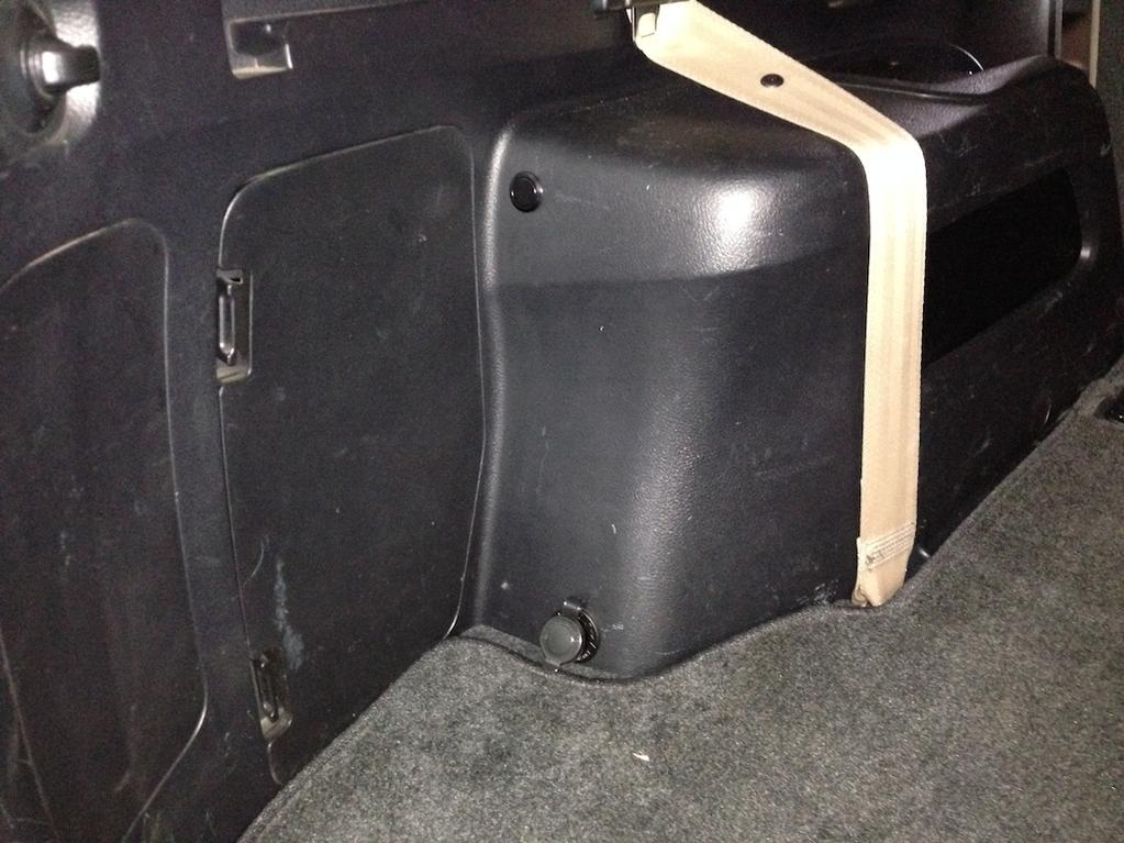

Here's that pile of hardware I started out with. I say "started out with" because as all projects go, you end up thinking of better ways to go about something. The brass nuts are called blind rivnuts. Its a way to put a threaded nut in something that you can't reach behind. You basically drill a hole, insert the rivnut, use the tool, and it compresses on the opposite side of the wall you're working on.

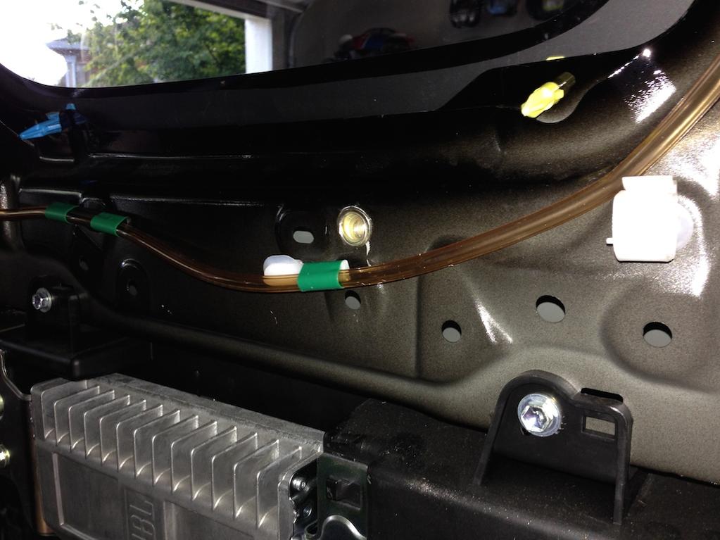

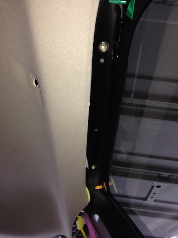

Here are two of them installed above the side rear cargo window.

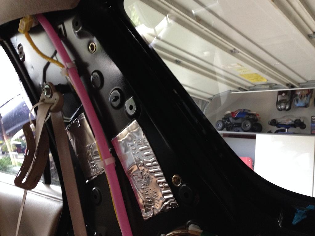

Here are two in the c pillar.
And here's one below the side rear cargo window.
The ultimate plan is to have a place to attach things such as a molle panel, bungees, etc.

Here comes the fun part. After taking a ton of measurements, putting the interior together, taking it apart, putting it back together again, then take it apart one more time, you can mark where you'll need to drill holes. This was a painstaking part of the job. I didn't want to ruin the interior of the truck with a bunch of incorrectly marked holes.
Upper panel of window area.
And after attaching the interior AGAIN, test the new nuts!
I know, I know.....it looks HORRIBLE! That's exactly what my wife said, anyway. So, at least I had the rivnuts installed and I can basically use any type of hardware I wanted. The hard part was done.

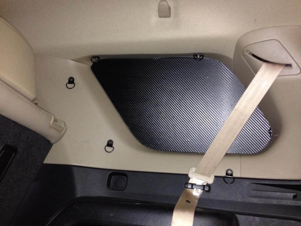

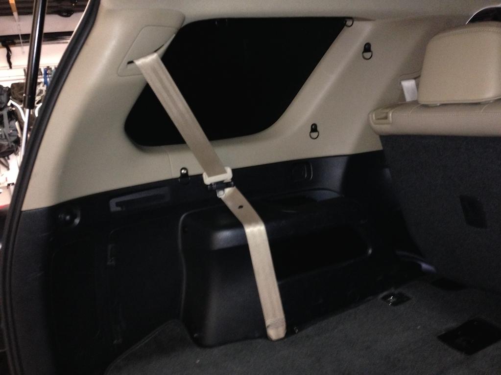

I ended up going with a 3/4" d-ring with button head hardware. Much cleaner if you ask me. Yes, that's the cargo windows Di-noc'd. Since we don't really use the window for everyday driving, I blacked it out from the inside and I wanted another barrier to protect the tint. I know it doesn't make sense, but it will soon.
Passenger side
Driver's side

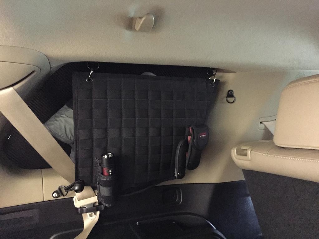

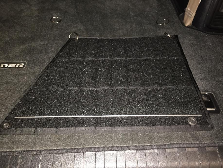

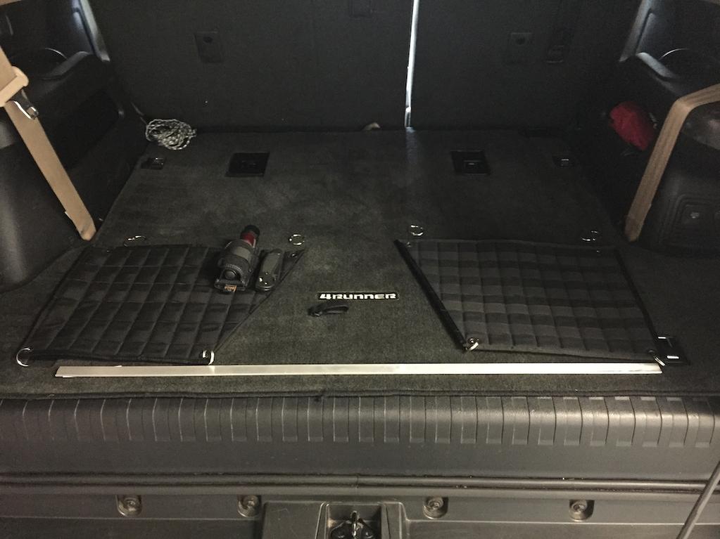

Here's where the molle panels come into play. I contacted John Wilde of San Diego Gun Store | Custom AR15 | Gunsmithing | Wilde Built Tactical Gun Shop. He owns a company that custom fabricates molle panels for gun safe doors. I mentioned to him what I wanted to get done and he took on the job. I used some paper and made a stencil of the particular shape panel I wanted. I also had him place grommets where I needed them. I also had him line the backside of the panels with velcro. Since they will be mirror images of each other, I could use the reverse side as a velcro attachment if necessary. His turn around for my particular project was about a week and a half. The craftsmanship is top notch. I would highly recommend him for any molle panel projects you guys need.
Here's what they ended up looking like. The 1/8" aluminum flat bar is to create some rigidity. There is a foam panel sewn into the molle but it wasn't stiff enough for what I wanted to accomplish. I basically measured out how much I would need and then cut it out.

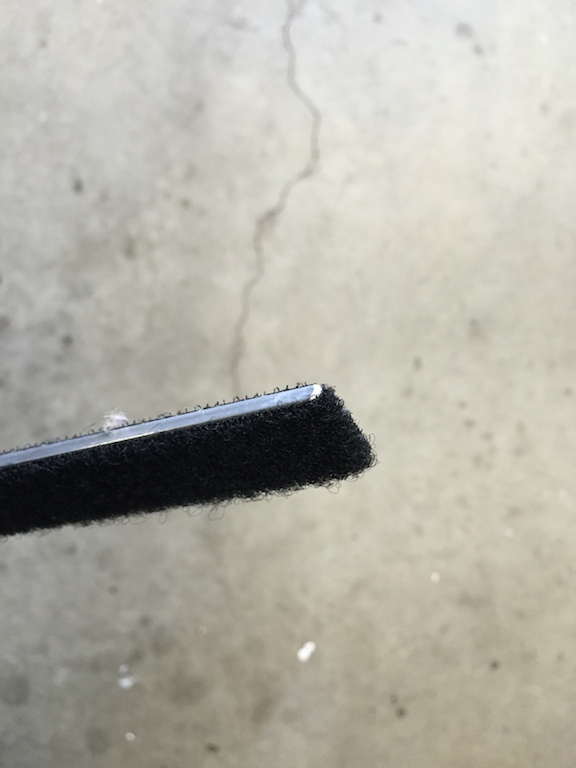

I installed velcro on both sides of the flat bar.
So when I attached the bar to the back of the panel, it creates a firm backing. Here you can see the back side of the molle panel lined with velcro.

Some of you may be thinking, this is a ton of work for such minimal storage space. And it is. I realize that it's probably not cost effective if you have to pay someone to do the work. But here was my decision making process.
Our family uses the 3rd row quite often. Whether its family or friends visiting, transporting other people's children, or just trying to go out with some friends without having to drive 2 different cars. I felt that the window "area" could be used better than a lookout hole for the people(kids) in the 3rd row.

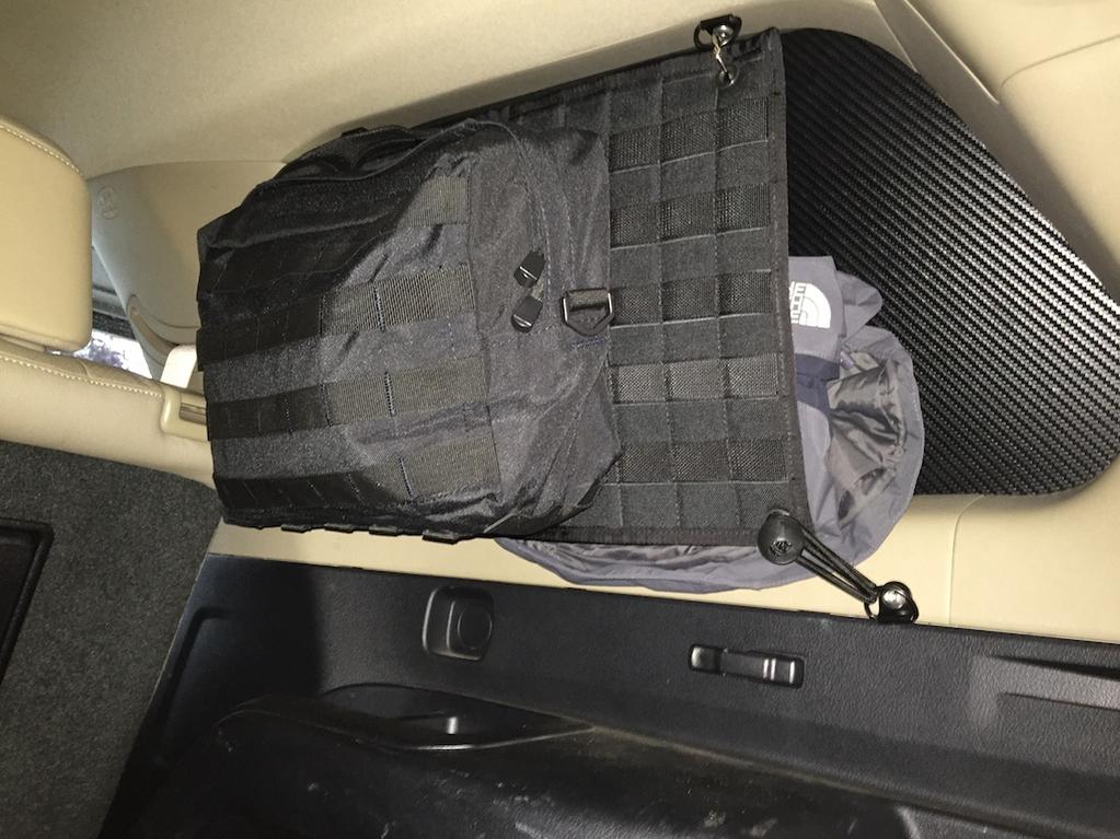

The molle bag contains flat tire repair kit, first aid kit, motorola talkabouts, air hose for the newly installed ARB compressor:bravo:, air chuck, MVUM (motor vehicle use map) for the Gifford Pinchot NF, and a Warn winch controller. There's plenty of room to spare too.
Haven't figured out what I'll need for the other side quite yet. But a Leatherman, Stinger flashlight and my Benchmade rest here for now.

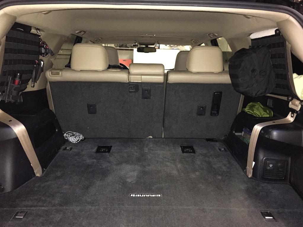

It really gave me a lot of options to carry stuff and still have full use of the cargo area or 3rd row. This is how she sits now. I'm sure I'll be adding a bunch of other things as I figure out what I want to keep with the truck.
Oh, and only the bottom corner is attached with a bungee. The other areas are attached with a clip ring and/or a small carabiner. This allows me to pull the panel out and stuff whatever I need behind it much easier. Also allows me to pull the entire panel off within seconds.

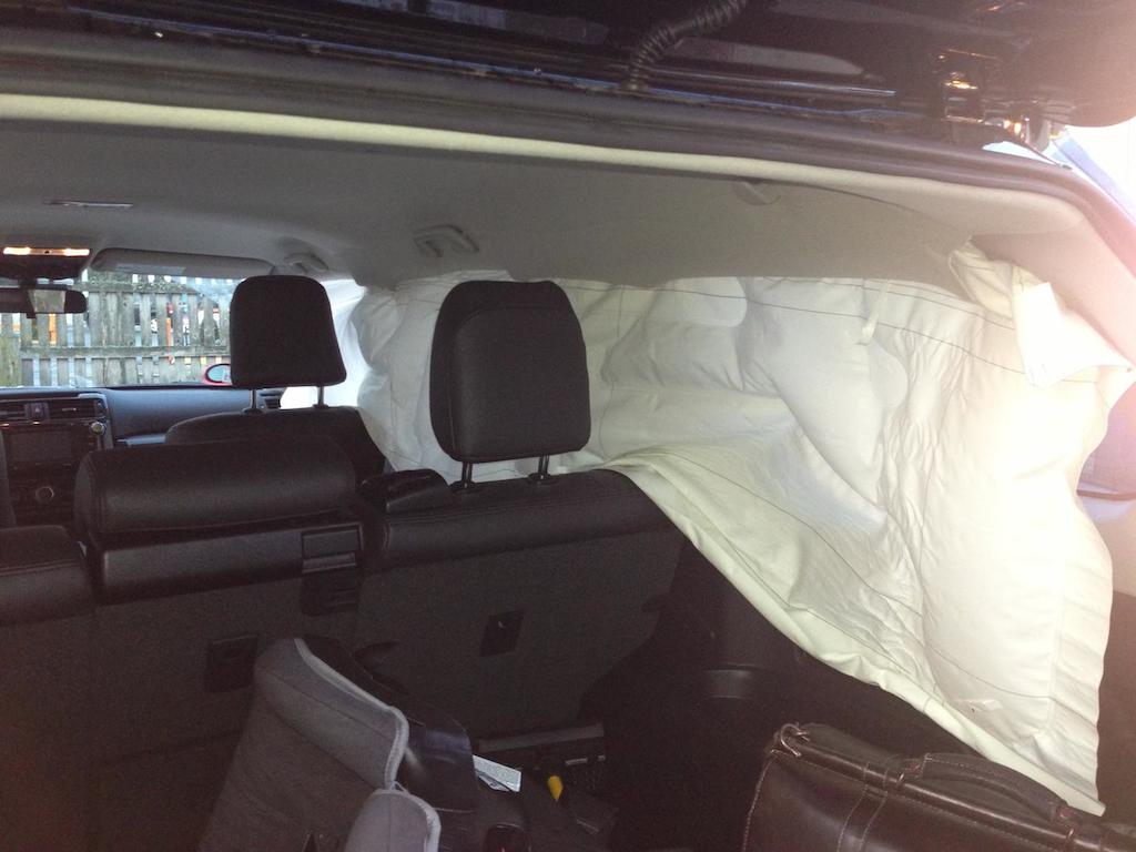

Cool idea, but I would be worried about issues with curtain air bags in an emergency. Did you disable them? Or do they not exist on your model 4Runner?
Good question. I actually thought about this when I was drilling into the truck. The air bags are located towards the inside of the truck window. Looking at some google images of blown up air bags, I determined that the headliner is where there needs to be no obstruction.
Granted the molle bag would be in the way if there were actually a 3rd row passenger. If there were someone in that seat, I may consider removing the bag or just going with a smaller one. This is one that I had laying around already.

A quick scroll through the pictures made me think you accidently deployed your curtain airbags!
