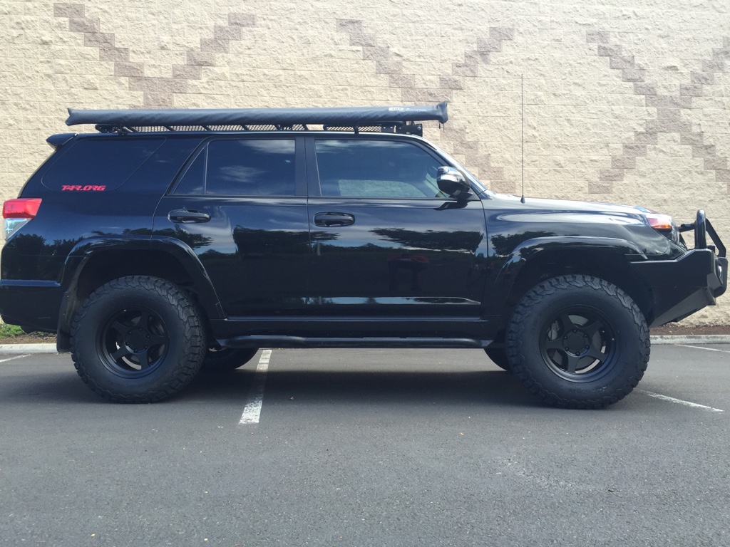

They made it!
I wanted to explore the 34/10.5R17 with the new FN Wheels Five Stars. I am absolutely elated with the outcome.
First and foremost, Dustin [MENTION=85422]FNWheels[/MENTION] was an absolute pleasure to deal with. Easy transaction and fast shipping. Can't ask for anything more.

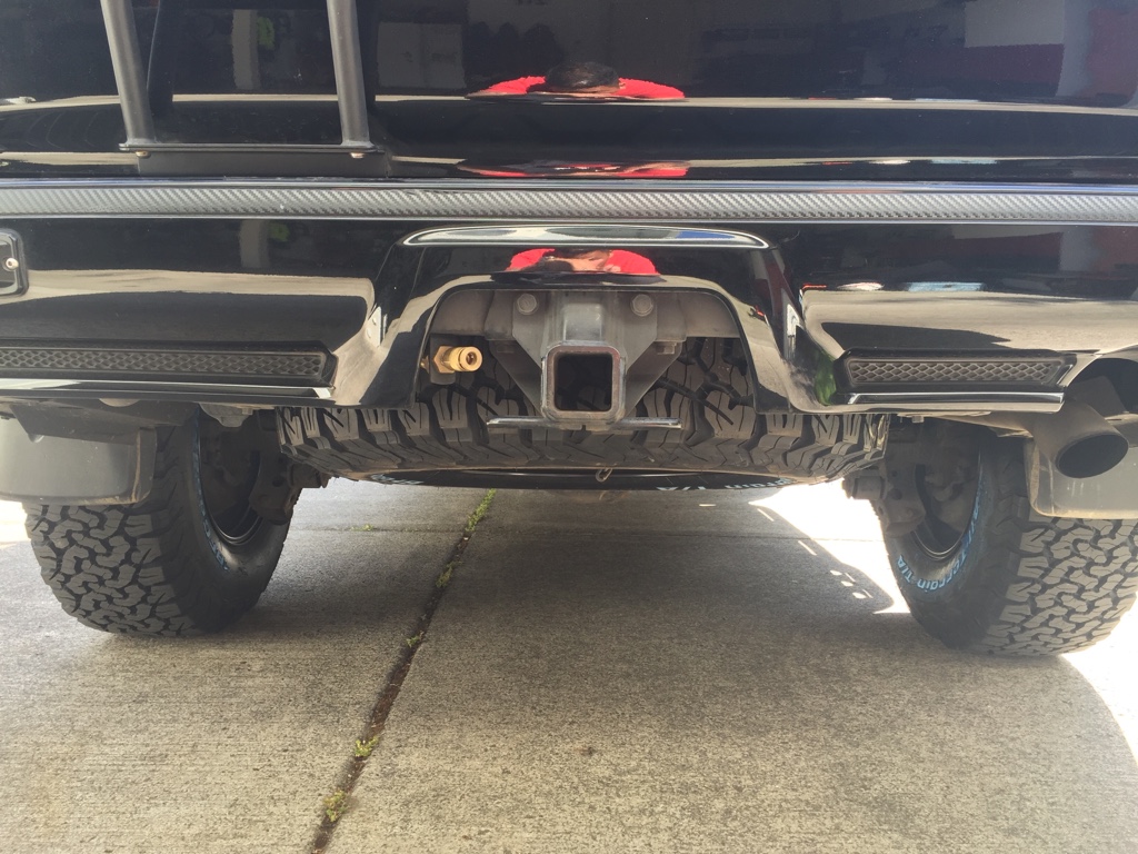

Second, the guys at my local Discount Tire (Jason, Paul and crew) did a bang up job dismounting the old tires, removing TPMS, and transferring them over to the new wheels and then installing valve stems in the old wheels and airing them up. They even balanced the new wheels with the BFGs with the weights hidden behind the spokes. On top of that, they took the time to drop my spare and install the new wheel and tire in the factory spare location. All of this within an hour (they did have 3 guys knocking everything out). All I did was bring them all a Waffleberry Brownie Shake from Sonic. If you want people to take care of your stuff, take care of them. That's the best $25 investment on tips I can recommend. The guys in the automotive industry really appreciate the little things that customers do for them, trust me.

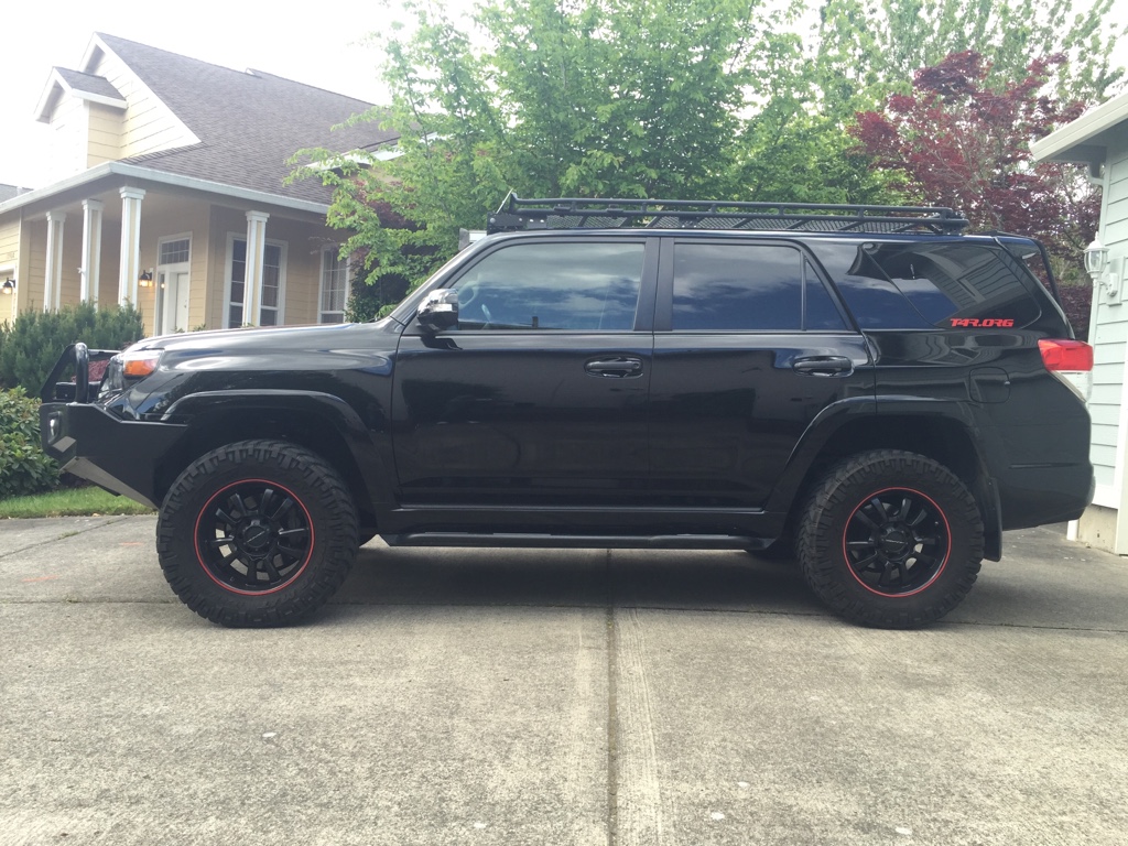

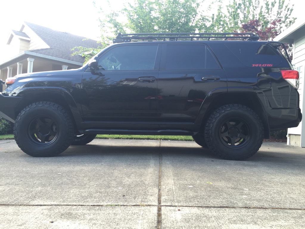

I tried to take a similar before and after pic for a side by side comparison. Sorry for the iPhone pics.
KMC Skitch 18x8 +15mm with Spidertrax 1.25 wheel spacers.

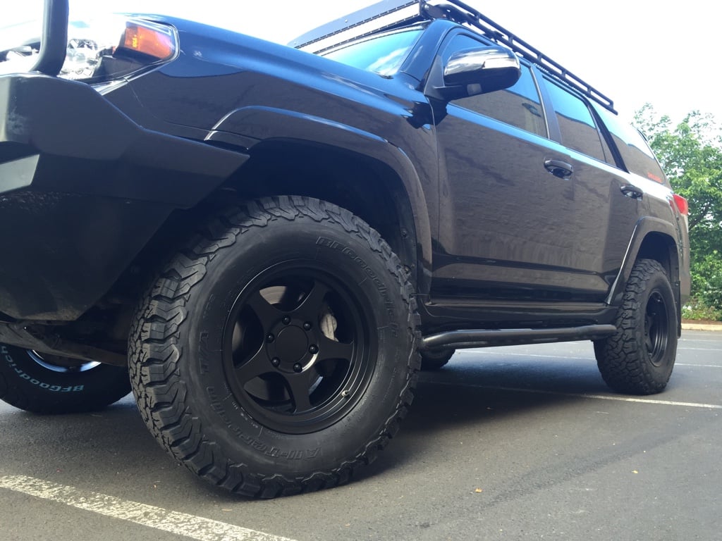

With the new wheels and tires. FN Wheels 17x8.5 with BFG 34x10.5R17 A/T KO2s
Overall impressions-
The new BFGs finally look the part. The new sidewall was the kicker. With the skinnier tire my scrub radius is drastically reduced combined with the fact that I removed the wheel spacers. Turn in is so much faster and lighter. I could immediately feel the difference when I drove off. It does feel like there is a bit more body roll with the D range BFGs with 40psi. I still need to experiment with tire pressures but I'm fairly happy with how they feel for now. Time will tell if I get better fuel economy but with a weight difference of approximately 15lbs per tire and wheel combo and the fact that the BFGs aren't as wide, I hope to break the 13mpg barrier.
The height difference between the 34 BFG and a 285/65 Trail Grappler is very minimal. I'll try and take a pic of the old/unused Nitto and set it up against the BFG. I was going to take a pic of both of them side by side, but the nice guys at Discount Tire had already installed the spare underneath.
If anyone is considering the 34 vs. a 285, I will always recommend the 34.

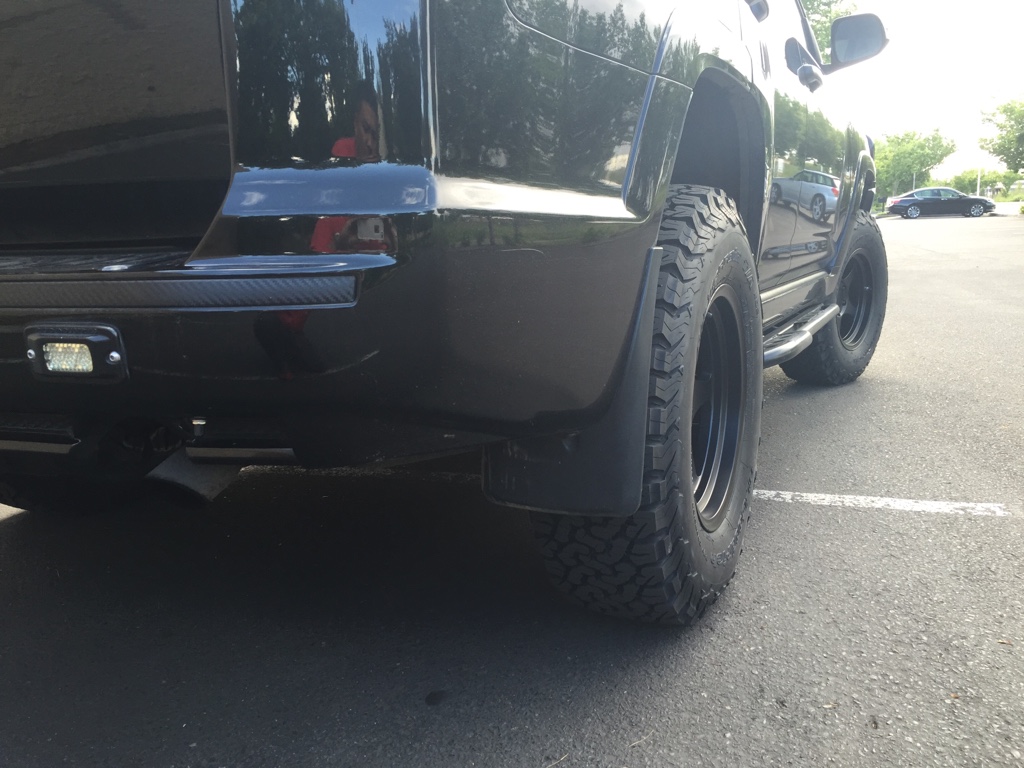

No rubbing but I wasn't rubbing with the wider TrailGrappler 285s with wheel spacers either.
I think the stock offset wheels would look too tucked in. I think they would look fantastic if you ran a wheel spacer.

Did you do any body mount chop or anything? I'm def interested in these tires but wanna make sure any potential rubbing issues are taken care of first
Thanks for pointing this out to me. Yes, I have had the body mount chop done since I've done the lift, wheels and tires. I can not say with authority that these tires will not rub with either factory or aftermarket wheels.
But, as I mentioned in our PM exchange, it is worth the investment to pay a local tire shop to test fit them at the cost of labor. This way, one will know for sure what they are dealing with regarding tire sizes.
I will note, the 285 Nitto Trail Grapplers are the same physical height as the 34x10.5R17 BFG KO2s. I'll update this post when I can get a side by side comparison.
