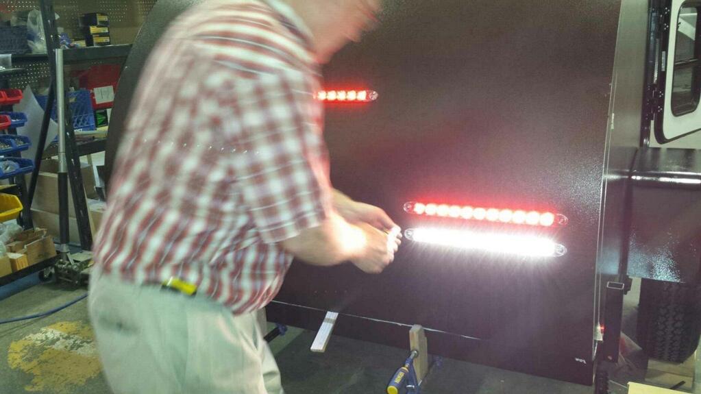

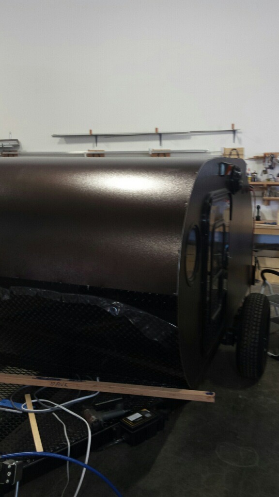

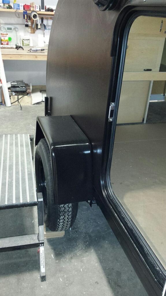

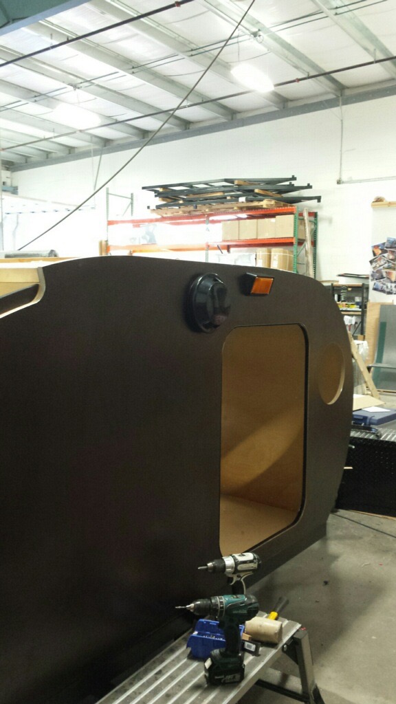

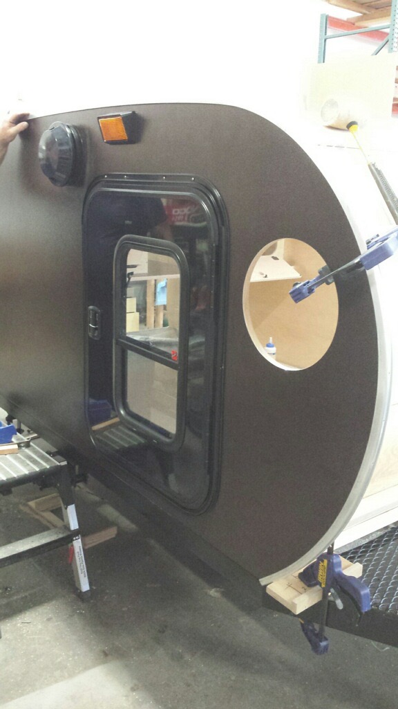

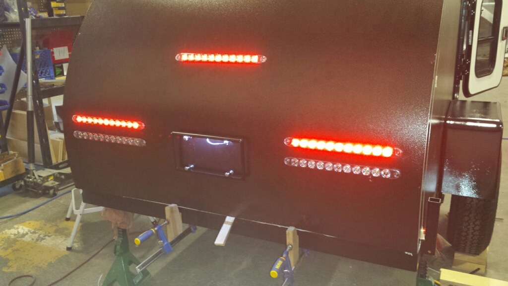

And the skinning begins! My wife and I went back and forth with the color options. I just wanted the durability while she was more concerned with the "tone". We opted for power coated aluminum skin in a "copper vein texture". We love how it turned out.
You guys know me and lighting!

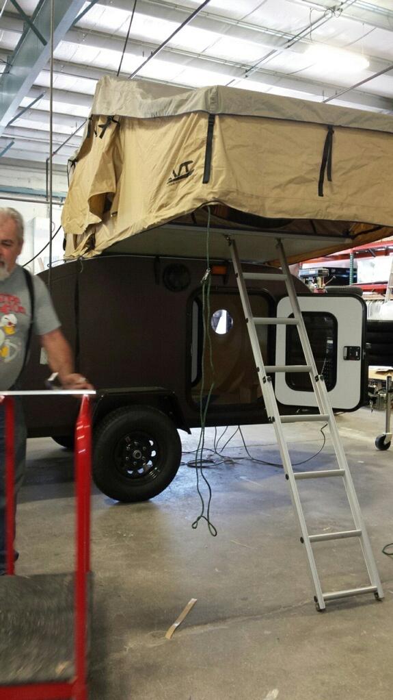

One of the major factors in this build was the height limit. It was absolutely imperative that we can fit the TD into our 7' garage. After a lot of deliberation and brainstorming of how we were going to fabricate a low profile roof rack, we decided to mount it directly to the roof. We determined this prior to the beginning of the build so that they could reinforce the roof with additional sparring to support the weight of the RTT and its occupants. It is through bolted in 9 different places. I knew I had no intention of ever using the RTT on top of my truck anymore. As convenient as it is to have it, it was just too tall to get in and out of the tent. With this configuration, I have less than 1/4" gap between the door frame of my garage and the knobs that stick up from the ladder when the tent isn't deployed. Absolutely FANTASTIC!!!

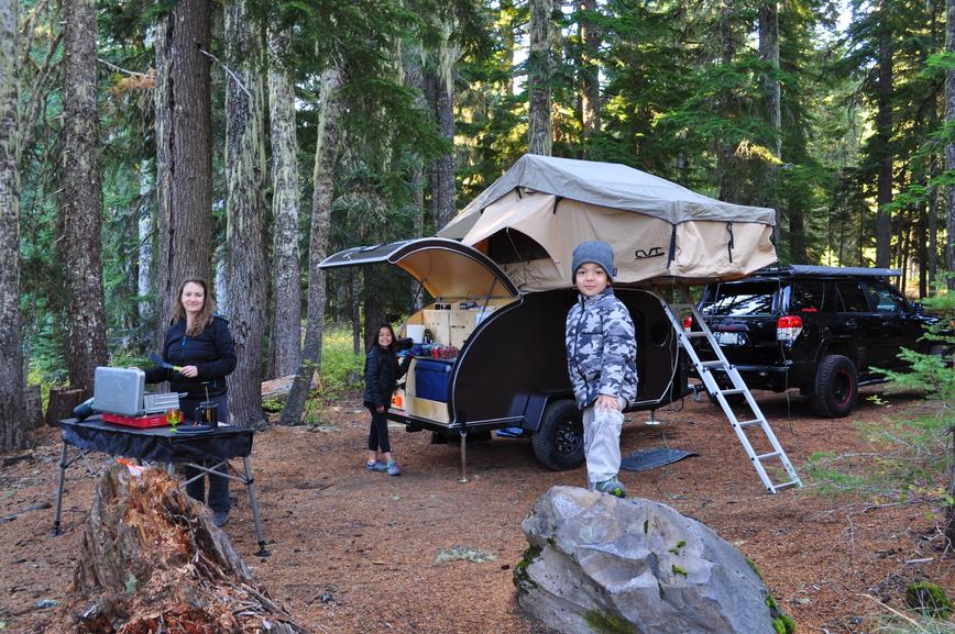

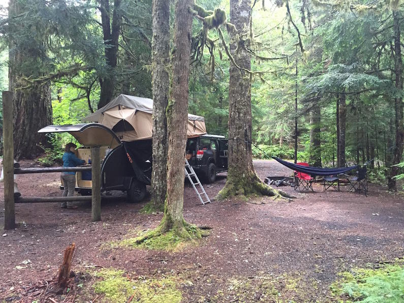

Setting up for our first night out in "Recon 1"

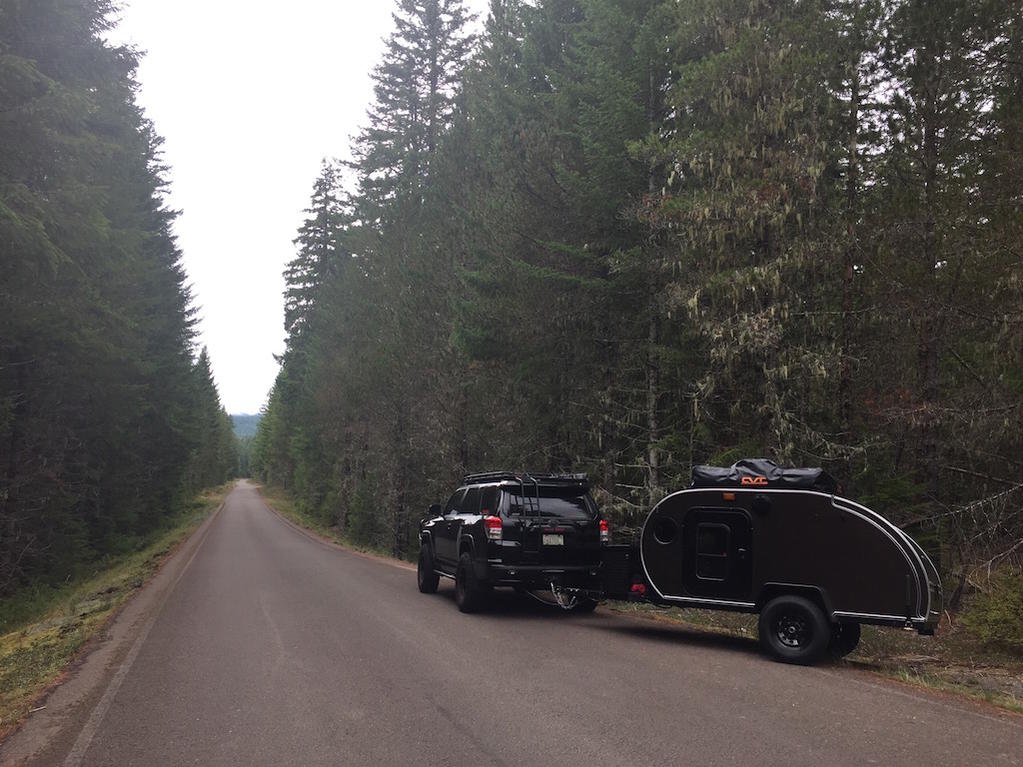

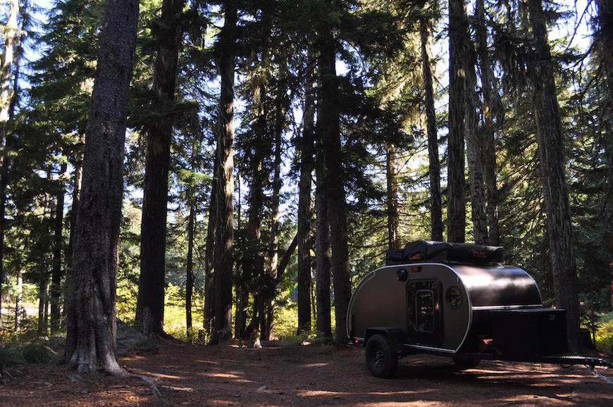

Random travel pictures...
Please excuse the laziness. I didn't put the guy lines out yet.
Pretty nice place to wake up to.

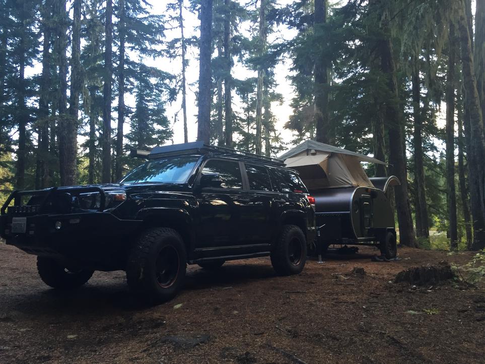

looks like the ass end of your truck could use some stiffer springs
I actually have air bags. I haven't taken the time to really dial it in yet. We've been working out the tongue weight and what we'll be keeping on the expanded steel portion of the tongue. The pic in front of their shop makes it look like I'm sagging but the driveway had a bit of an incline and depression.
