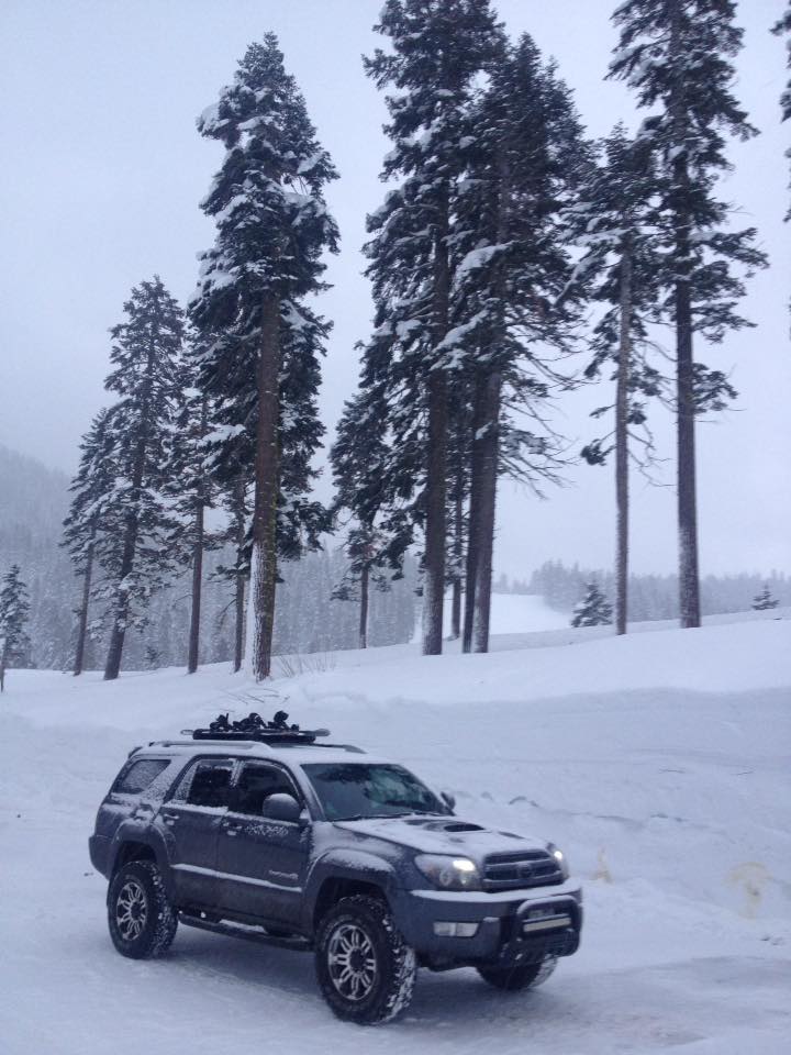

Swapped out the stock running boards for these tube style that hang from the body mounts. Definitely a little easier getting in and out because they dont stick out as far as stock.
