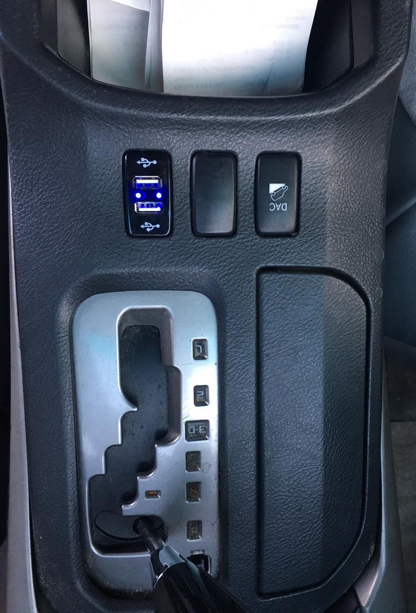

Funny, I bought this almost a year ago and still haven't had the chance to put it in there. I swapped the cigaretter lighter out and used a dual usb in there. This one was suppose to be on the outside for passenger use. just thought it was hilarious to see Amazon tell me I bought it in May 2016. :becky:
I bought it May of last year, and just installed it. lol. Forgot I had it until I was looking for something and found it in the glovebox.
Whats the easiest way to get the old blank switch out and this in?
thx!
Open the course and pull up where you see the counsel meet the plastic piece with the blanks and shifter cutout.
I'll post pictures when I get to my car in a minute.
