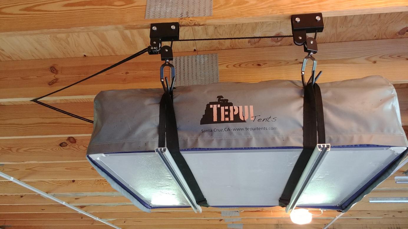

I really need to order some Plio Grip and the Plio gun for mine. Was it as easy to work with as they make it seem?
Here is my parts list:
1. Remote operated electric hoist (880lb double line/440lb single) - Harbor Freight. It's overkill, but I had a coupon
2. Unistrut 20ft (1 5/8 slotted) - Home Depot
3. Stainless Steel 316 Round Ring Welded 3/8" x 3"
4. 1/8 Inch Aluminum Crimping Loop Sleeve for Wire Rope
5. Stainless Steel Thimble for 3/32" and 1/8" Diameter Wire Rope
6. T316 Marine grade 1/8 inch Stainless Steel Aircraft Wire Rope Cable, 100ft
7. 100Pcs 1/8" Aluminum Crimping Loop Sleeve Crimps
8. 16Pcs M3 Stainless Steel Thimble Rigging for Wire Rope Cable
9. 3/8" X 1 1/4" DROP FORGED MACHINERY EYE BOLTs, qty 8 (Chicago Hardware)
10. Threaded Quick Link Carabiner 5/16-Inch Diameter, 2-Pack x 2
11. IWISS Wire Rope Tool for Swaging
12. All thread, 3/8 (1ft)
Thanks! Looks like I've got a new project for this weekend!
It's fairly easy to work with Plio Grip. Flows very well but dries quickly so get a few extra mixing tubes.
Sanding is OK, takes a bit of time but not bad. Lots of dust, though. I used a mask when I was sanding.
If you have all the parts the whole thing can be done, ready to paint, in one easy day.
