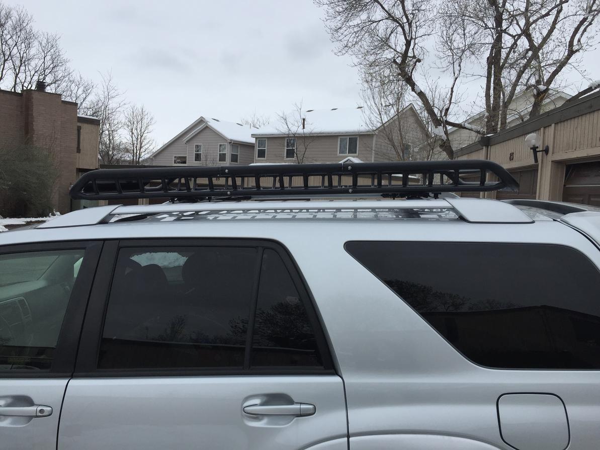

My Land Cruiser had a custom rack made for $250 here in Denver and I was really disappointed with the build quality, but I learned to love it after a couple of years of hard use wherein it didn't show an ounce of trouble. So my plan was to have another custom rack built by the same guy, but of course he doubled his prices, despite what I wanted this time being smaller in every dimension, so I did some more digging.
I was impressed with the style of this rack in pics I found here on T4R.org and it was somewhat low profile looking, so despite wanting a custom, lower-profile rack, I pulled the trigger.
When it arrived I was immediately impressed with how sturdy it felt. Knowing what I put my last shoddily built rack through I have no doubt this one will hold up.

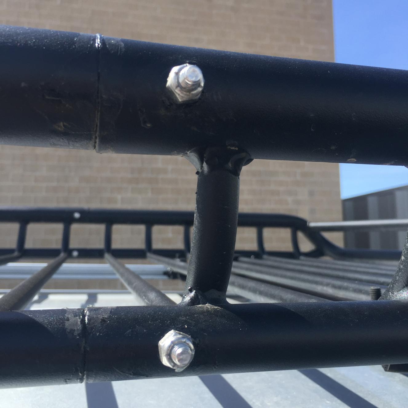

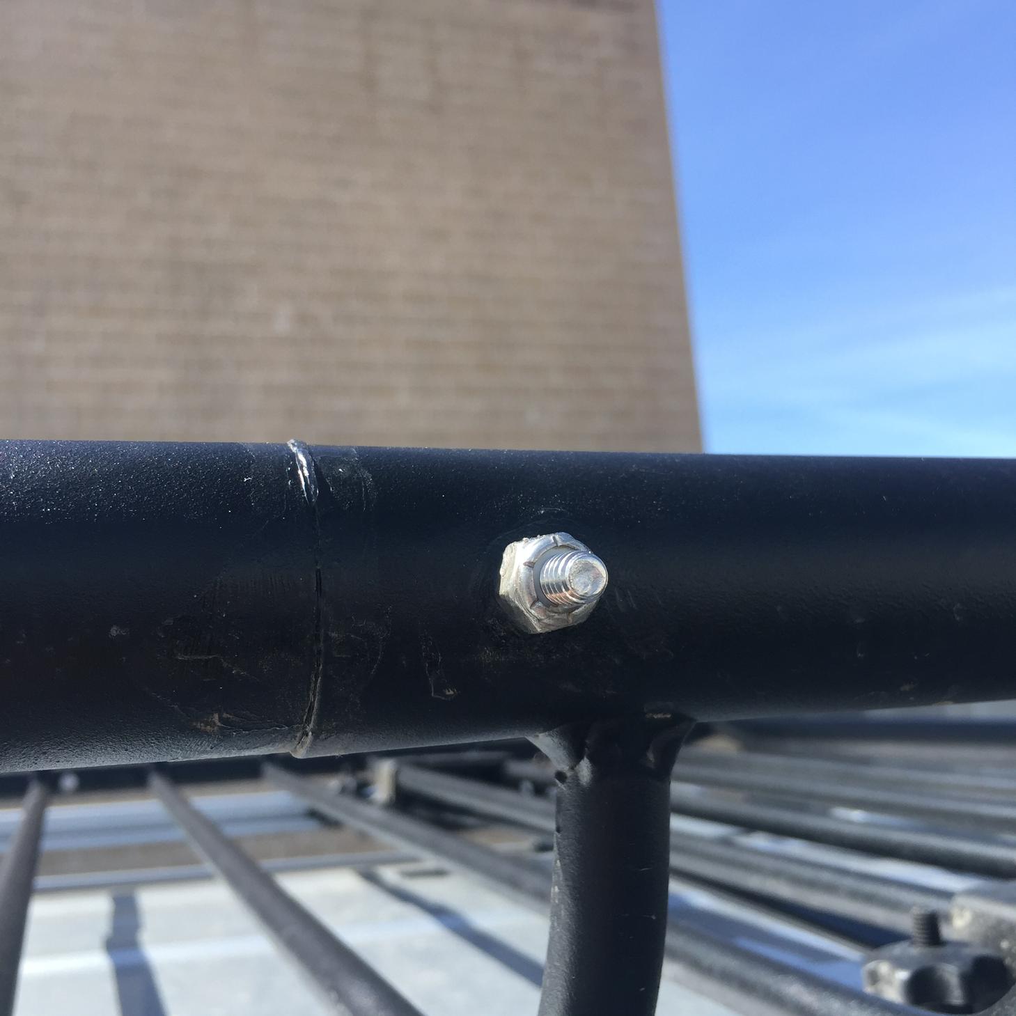

I did take some suggested precautions...
1. Silicone the joints
2. Use better hardware to connect the rack sections.
I drilled holes through the rack and used SS 1/4-20 bolts with SS nylock nuts. Before putting it all together I sprayed a bit of paint on the drilled holes and then silicone around the hardware as well.
I've considered the lower profile mounts and I may get them some day, but for now I'd like to be able to open my sunroof.

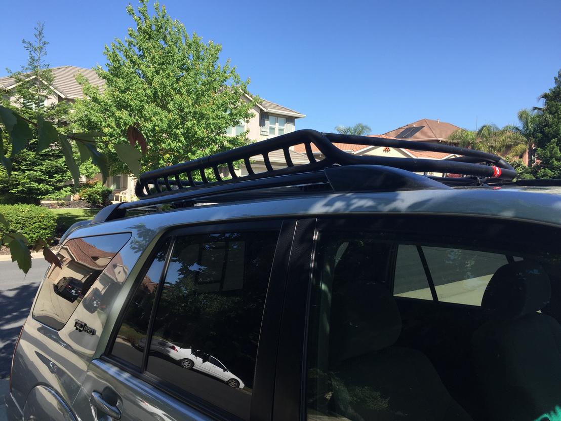

I bought one the other week! Yes it does come with a rubber sleeve that goes over the joints. Bit of a pain to stretch over the holes but it does work. Overall very happy with it. Still deciding whether i want the extension or the low brackets first.
