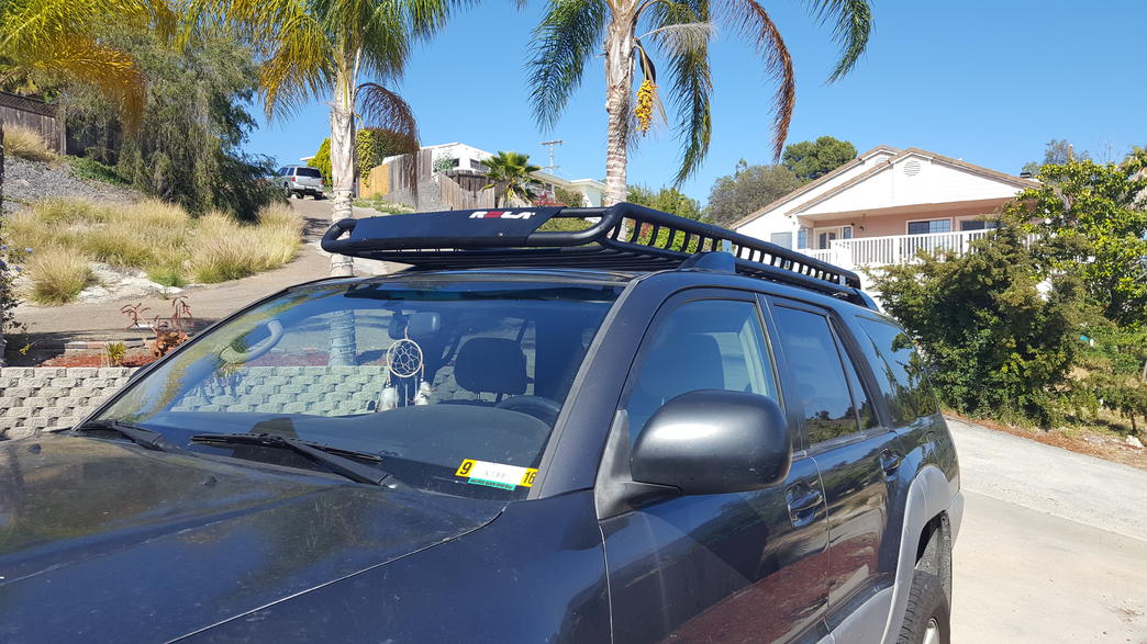

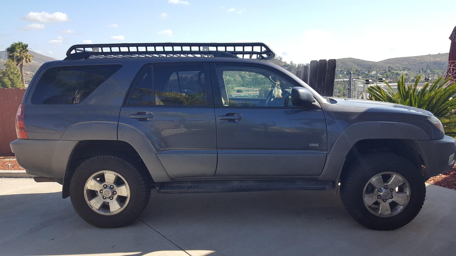

does anyone have pictures of the gap with these mounts? im painting my mounts and going to install this weekend and dont know if i want to flip the mounts or not because i like to be able to get up on the rack and not have to think about he rack touching the roof

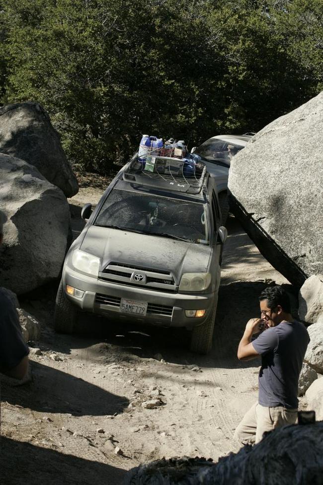

Here's mine with the double extension cause I like the full roof rack look.

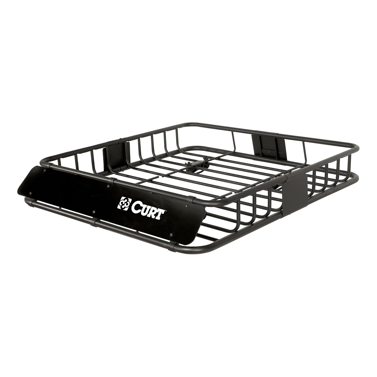

For examples most other commercial baskets use Four longitudinal tubes..
two at the edge/rim (top) two at the bottom closer to the center line holding all the smaller curved tubes dimensionally stable (Most baskets had the roof rack mounts hardware attach to the small (multiple) tubes.. (the Rola has some at the bottom edge of the basket but they are very "Malleable" and the are about 38-39 inches apart)
In terms of manufacturing this presents many challenge because four big diameter tubes are far more complex to keep alight specially after welding..

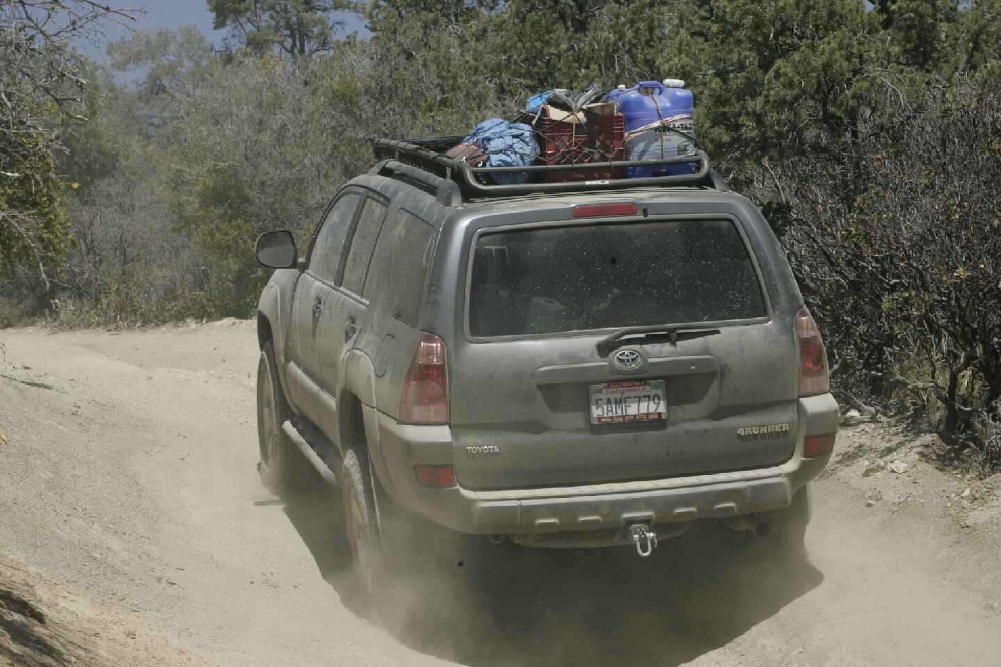

You see even the guys that sell them for a living (I can not even find pictures of customers using them) had no freaking clue about airflow dynamics and a rack mount it like that will drop fuel efficiency a good 5-7%, (The air will be force fed in between the rack and the roof) max wind too, just don't open your sunroof specially when eating popcorn
Just look at the back of it, it will let you open the rear door even with a spoiler, zero issues, So sexy, but not almost $500 sexy at least in my opinion and budget)
Then again regardless all baskets by definitions generate turbulent airflow on the roof of the vehicle, especially if you count the gad in between the roof of the car and the rails of the basket..

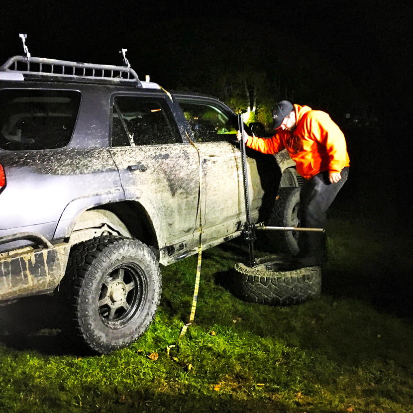

All around pretty good basket. I use mine for my spare and Hi-Lift. I run 4 crossbars underneath just for peace of mind.

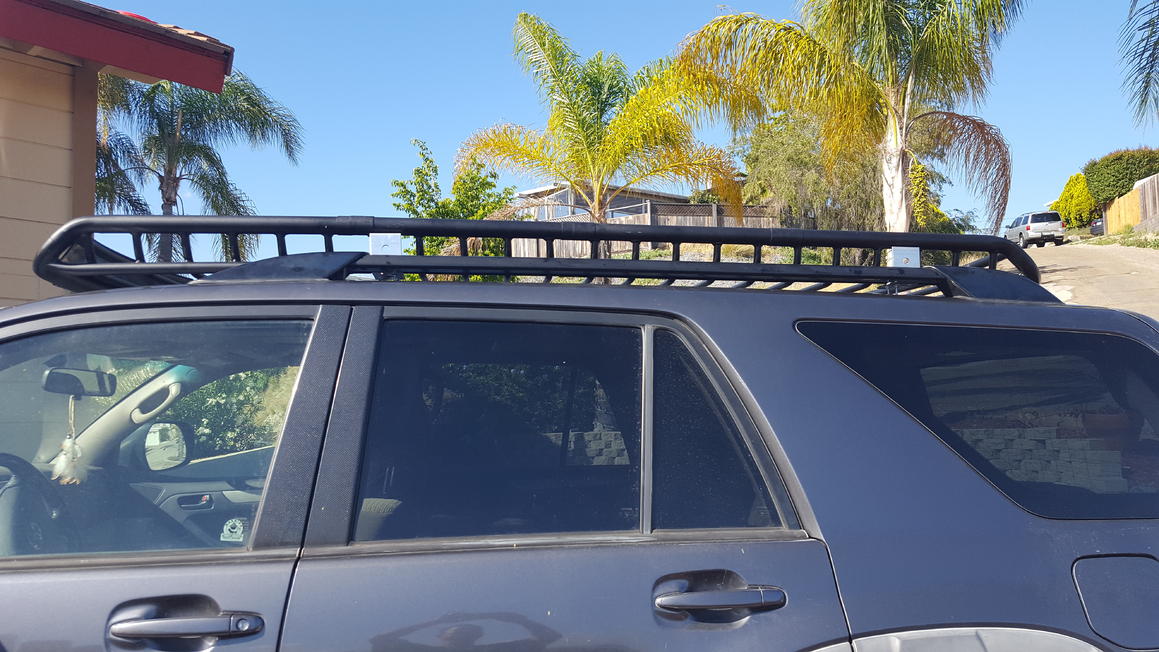

well i mounted the lowering kit. i installed it flipped because i did not like how it was mounted at first. i might flip the mount and add a spacer to it but for now i like how it looks flipped and i think it is stronger then with the cross bars
