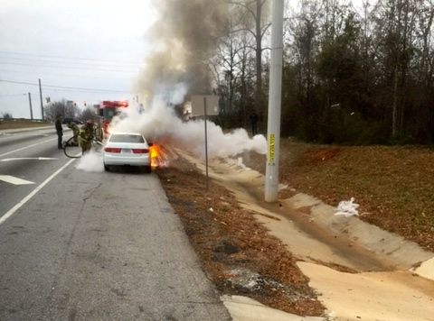

^ I like that. Originally, my 4runner was going to serve more as a recreational/multipurpose vehicle since I had a separate DD. But after this happened to my DD while driving on the highway on my way to work a few months ago...
...my 4runner became my new DD. Luckily it was only my car that took any damage. Don't care much to live in a bubble & b/c of that I will welcome safety advice of any kind. I've been looking into fire extinguisher options since this incident & this thread will be a big help. Solid info, thanks for taking the time to share some knowledge.
Edit: Kind of ironic but I just looked at your original post date and my car catching fire on my way to work happened about a week after you made this thread.
