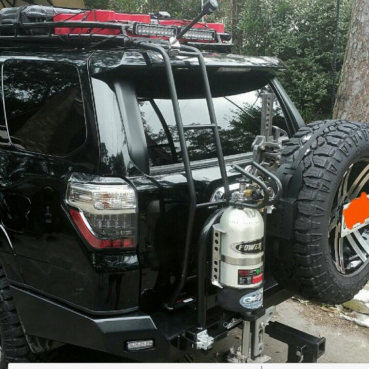

So, my PowerTank is filled with CO2. I did not know it could put out fires.

[MENTION=96877]T4Rfirefighter[/MENTION] I Knew Metal Had to better than Plastic for the controls, just about common sense in most cases, but I didn't know brand had so much to do with it. My current Fire extinguisher I've been carrying with me for a year is a "Strike First" ABC Dry Powder 5lb'er. It has metal controls and the weld on the bottom is smooth like dimes laid over, like a weld should be as far as I know. Any good or should I start looking for a Amerex like my work has?
Not sure it will be able to put much out since it has to go through the regulator and has no horn. I wouldn't recommend trying to create your own CO2 extinguisher out of a PowerTank, either. Since it is a high pressure cylinder, things can get dangerous in a hurry if you discharge it in a way that it isn't meant to.
