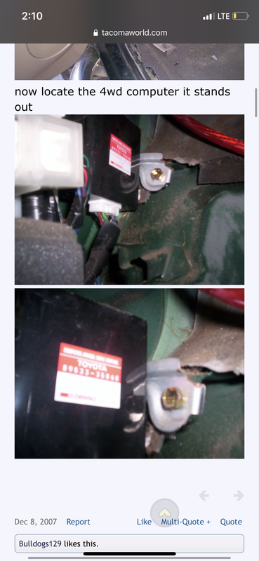

Finally just finished. How did you mount the modules that were attached to the firewall itself? I got all the wiring hooked back up except those 2 modules, was thinking about just using some zip ties but wanted to see if there was a better solution?
Mine were still able to clip back on. It took a generous smack but they stayed when I hit them. The bottom isn't hooked but the top was able to latch. It doesn't rattle off road or anything so I'm leaving it as is. Zip ties would be an easy fix though if yours isn't latching.
All the clips and everything still pops back into their original locations, but on the driver side there is the 4wd module (black box) which had a 10mm bolt attaching it to the firewall. That attachment is no longer there after cutting.. I think passenger side has something similar as well.
Oh ok I know what you’re talking about. Passenger one I just shoved in and closed it up without bolting it in. Driver side there was one available spot that I bolted the 4WD module in. It’s sitting at a weird sideways angle but secure.
I’d say zip tire most of it together and it’ll all stay tight and you’ll be good to go. Make sure you test 4WD and locker. I was nervous after all of that cutting and pulling wires around.
