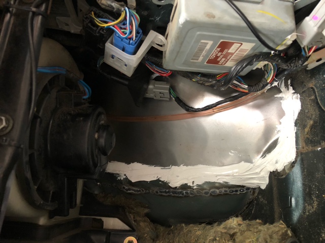

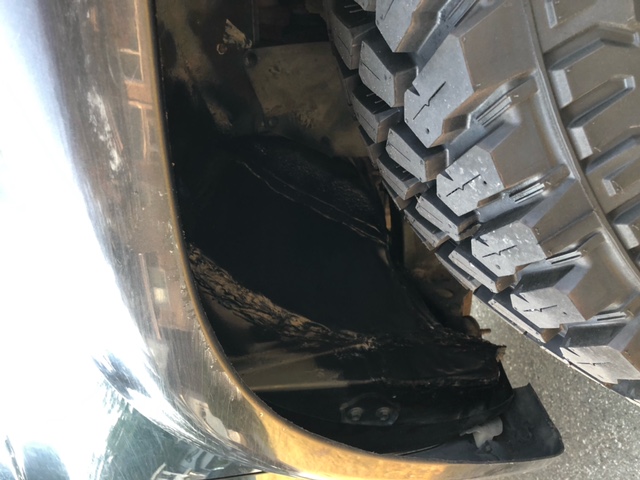

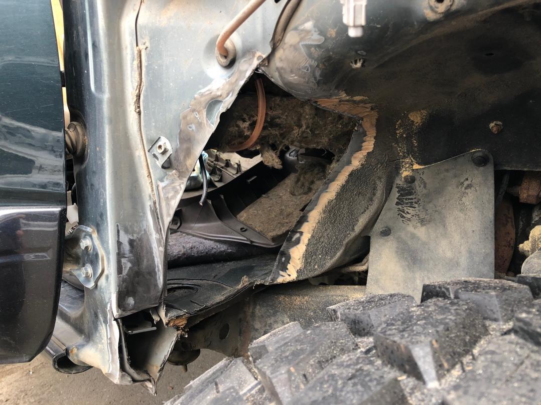

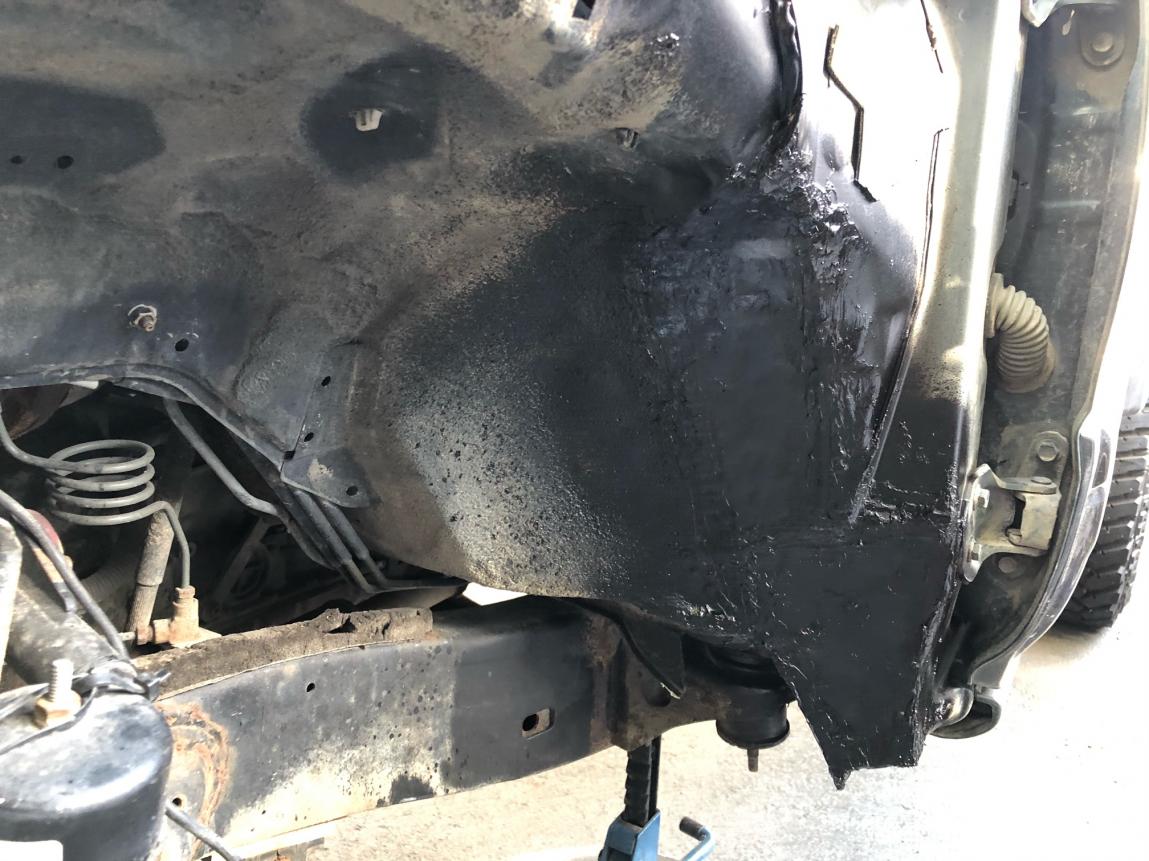

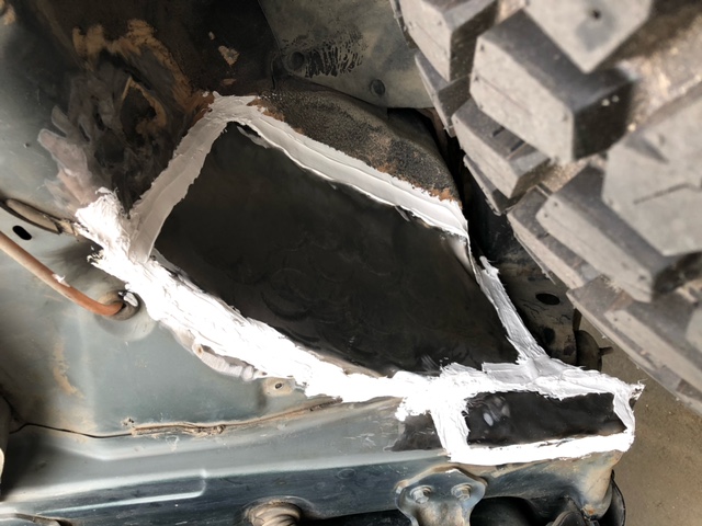

Just finished mine off recently as well, only have good photos of the passenger side but it looks very similar to yours. I started on the driver side with what I eventually realized was not a big enough cut, so I ended up still using a BFH to open up the hole and make a little more clearance. When it came to doing the other side I thought it best to just go big from the get go. Also cut the fenders and emptied out the inside of the flares.
Still need spacers to clear the frame, but no rubbing up front in my last trip, and i was doing bigger, more challanging stuff than I ever did on 33's. Well worth the time and effort!
