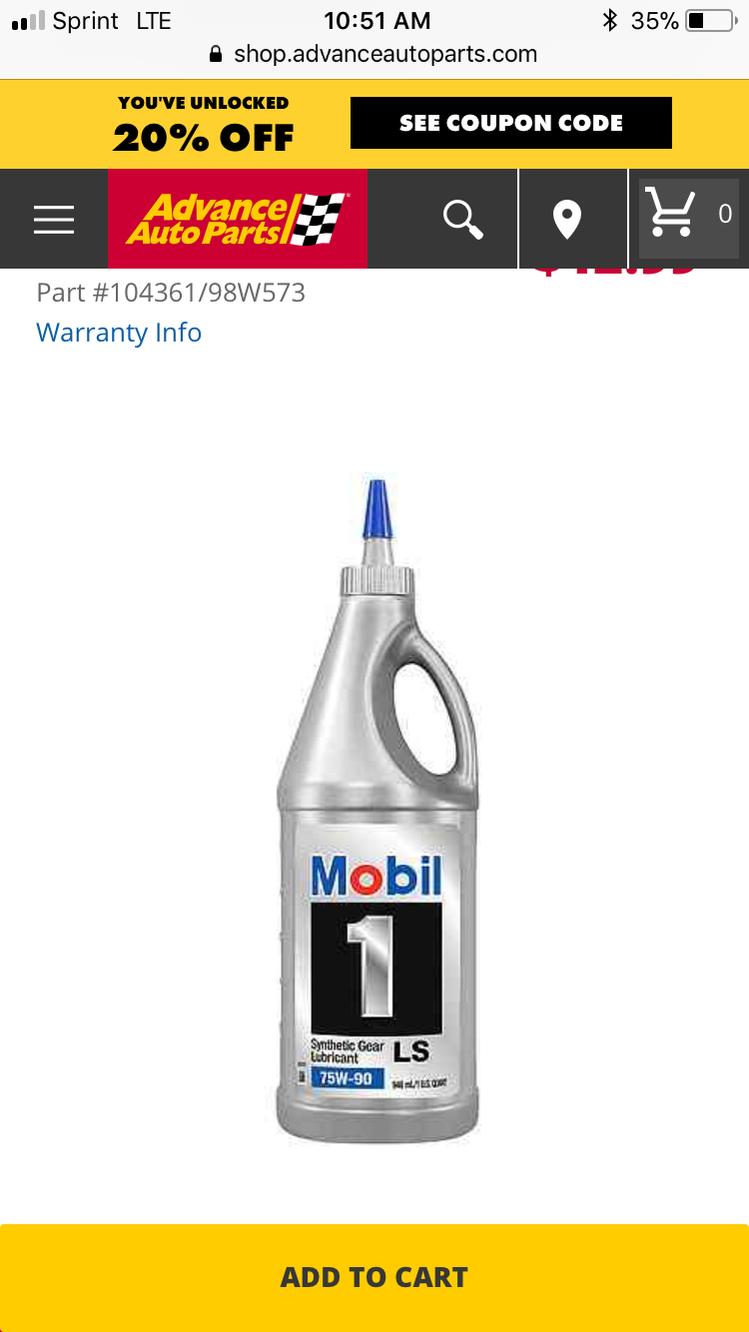

I Went ahead and got 8 of these so I hope it was the right one. I’ll be doing it in a few days so I have time to exchange it if I got the wrong oil
https://shop.advanceautoparts.com/p...ant-ls-75w-90-1-quart-104361-98w573/7070039-P
that is what I used when I had 3K miles on the T4R.. reason the rear diff was oil changed due to being very dark had some black specs in the oil/fluid
when I did the oil changes this January 10K miles , the drive train fluids all looked very good. so the rear diff does get burned up on break in when new @3Kmiles..
all the other fluids looked like new.. as was mentioned on this post ..
LS has no effect on a open diff..NO clutches so not an issue..
75W-85 Is what manual calls for. I tried 75W-90 Royal Purple and wasn't pleased with the way it worked so I switched to Redline 75w-85 in both diffs, and OEM 75W in transfer case. Now it drives as smooth as silk:
