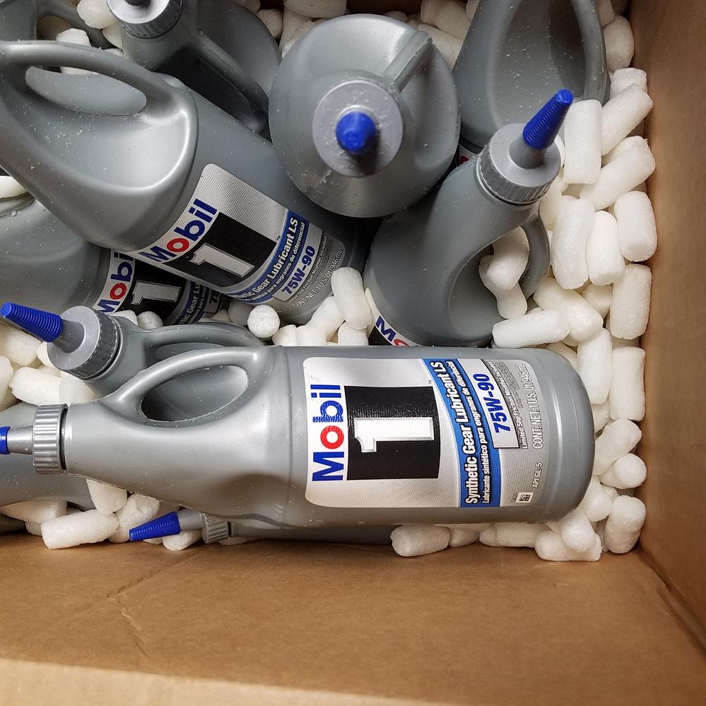

So my oil guy ordered me the wrong oil. He got me 75-90 Mobil 1 full synthetic as I asked for but it's the LS stuff not the Delvac stuff. Has anyone used this? It's for a 2016 SR5 so to the best of my knowledge, diffs are open and no need for the LS additive. Not sure if the LS additive will harm anything in the diffs or transfer case either? I figure no harm to the diffs but the transfer case is my main concern.
So I am sure many will disagree with me on this but if he will swap it for you (the non LS oil) do it. If he won't, I wouldn't toss the oil , to my knowledge (very very limited) the main downside to LS oils is the Friction modifiers in them can, under circiumstances (heat) shorten the life of the fluid (oxidation stabiilty).
Differentials that have limited slip still have ring and pinion gears to lubricate.......

Well to be honest, he sent this to me as a free sample. We spend literally hundreds of thousands of dollars with this supplier every year nationally. I don't honestly see the LS additive being an issue in the diffs, it's just overkill if anything. He did give me a # to call Mobil 1 which I will do tomorrow just to confirm there is no issue but I wanted to get some input from you guys here also. I'm one of those guys that tends to over think everything, like servicing my diffs every 15K miles and engine oil every 5K miles lol. Cheap insurance is how I see it. I think when it comes time to service the transfer case I'm going to just spend the 50-60 bucks and go with the OEM fluid. Not worth the risk of blowing something up or shortening the life of the case for such a small amount of money in comparison to replacing the case.
