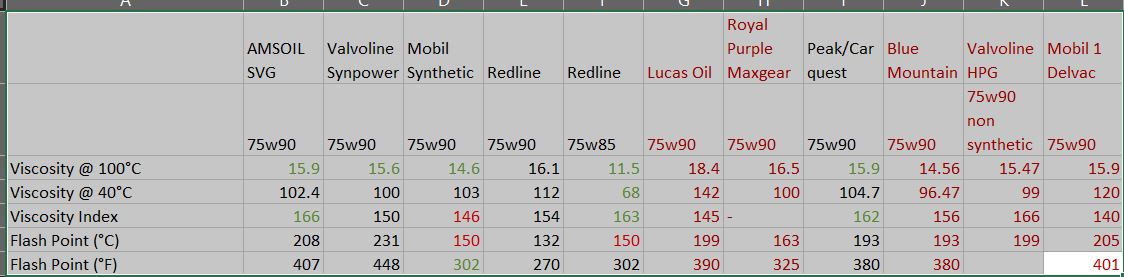

Royal purple is fine oil but expensive and hyped up according to many discussions over at bobistheoilguy. I refuse to use Royal purple because their PDS is so difficult to find. I eventually found it but im sure they really dont want you to see it. Leave the Redline in there.
I know every manufacturer uses different methods of testing to derives these numbers which may skew numbers here and there. However these are published by the oil manufacturer and gives sort of a decent idea of each gear oil's properties.
Could not find a Viscosity index figure for Royal Purple maxgear 75w90.

This is the first i'm hearing Mobil 1 has ever been rated as a bad oil. Everything I've ever seen has put Mobil 1 up there with the best oils on the market.

He's talking about some poor ratings for M1 motor oil.
I've seen this argument before. I might be mis-remembering but IIRC that M1 Advanced Fuel Economy or a similar uses a base stock that can't legally be called synthetic in Europe and that it doesn't perform as well as some other synthetics in testing.
There are several different M1 motor oils now including Extended Performance, Annual Protection, High Mileage, Advance Fuel Economy and European formula (0w-40).
