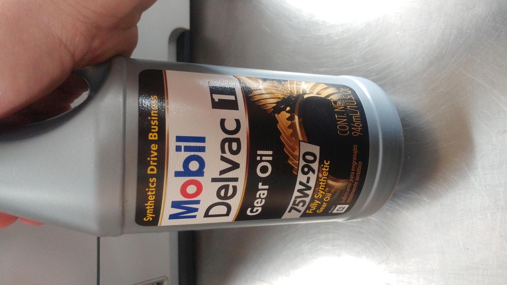

Ve read the back and forth about what oildls to use and some people were using delvac. I just wanted to make sure I got the right stuff (for the people that use it). I get it cheap from work so id like to start with that rather than $100 for 6 qts of royal purple.

Looks like it. I've never seen it in that size.
What does the label on the back say as far as GL Approvals?
I knew they were changing the name to Delvac 1.
Hoy crap! Summit has the gallon size at a great price.
https://www.summitracing.com/search/brand/mobil-1/product-line/mobil-delvac-synthetic-gear-oil
Gl5/mt1. I work in a shop that specializes in med and heavy duty trucks. We have the gallon size as well but I wanted these for ease of working with. $8 each.
Nice score. Same stuff, new packaging and new size.

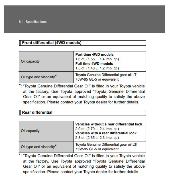

So I just did my rear and it took 3.5 of those delvac quarts. Either I have an enlarged rear diff or those quarts are severely underfilled.
Also 2.5 qts came out only. Underfilled from the factory? I know its never been changed because the crush washers still had black factory paint on them
