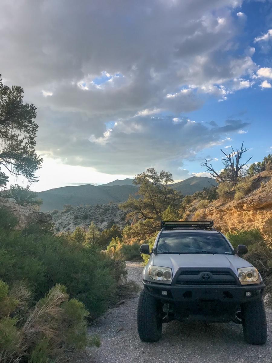

Recent trail pics.

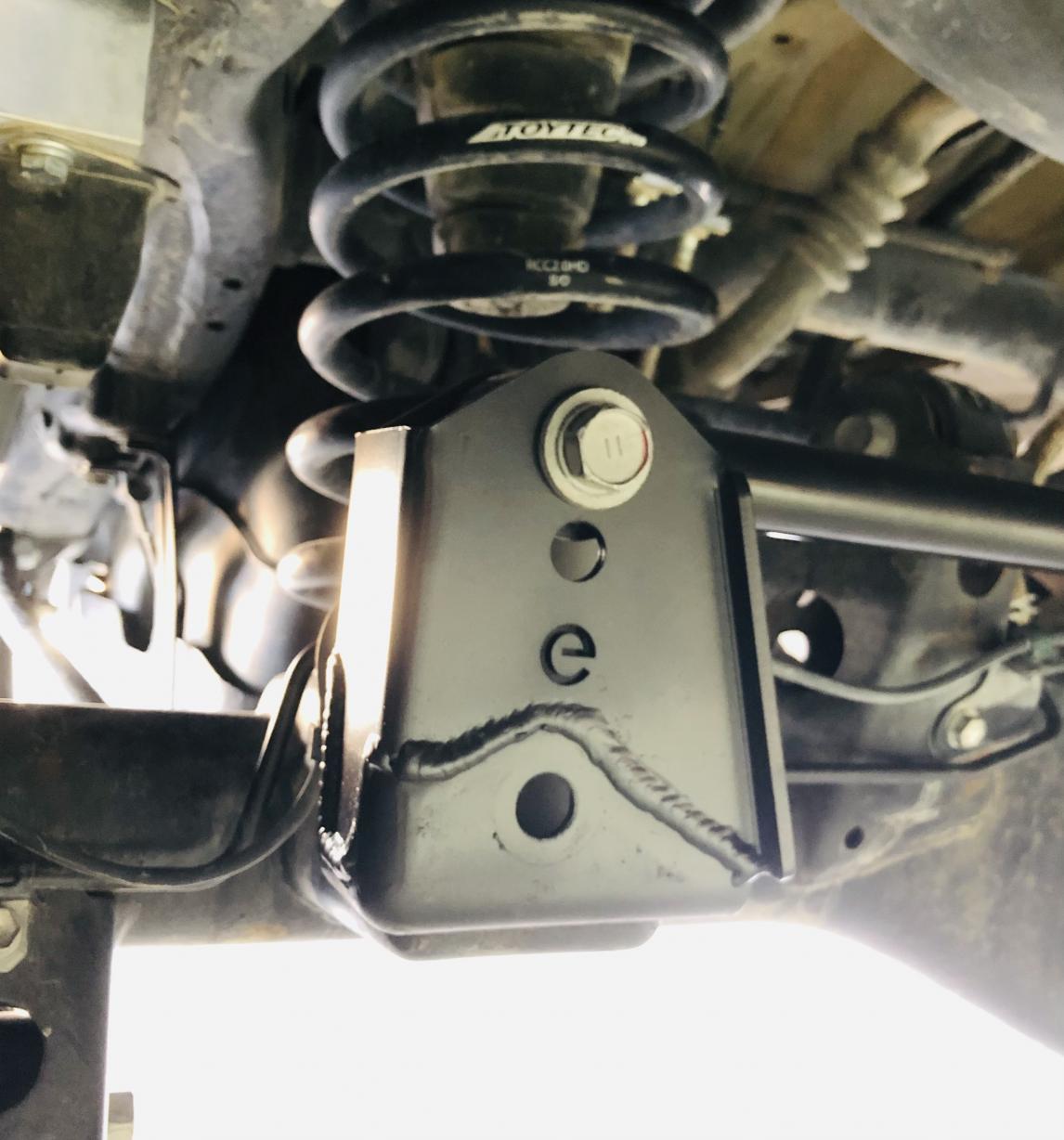

eimkeith PCK
Installed the eimkeith PCK and swapped the Toytec panhard bar for the stock one.
How's the handling now?
Sent from my Pixel 3 XL using Tapatalk
Maybe not night and day difference but I have my front sway bar removed and my tires were at 15 psi for the short drive on pavement to the trails. I’ll be able to tell once I have my tires at a normal pressure and run highway speeds.
On the trail it felt phenomenal.
No more squeaky heims in the rear too.
yeah wait till you hit a big round turn on the highway. You're going to feel the difference right away.

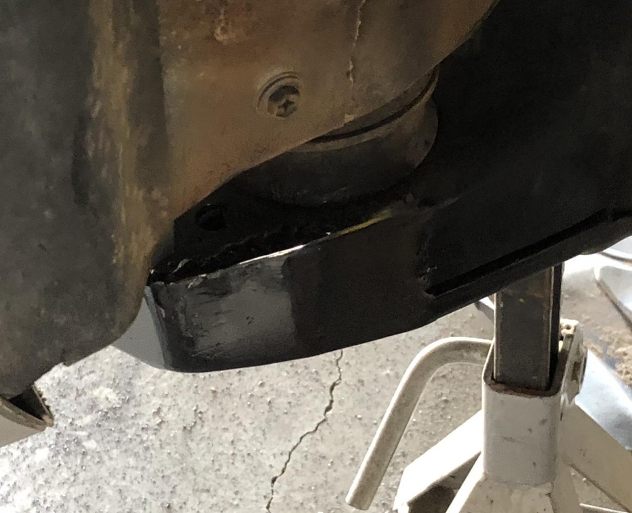

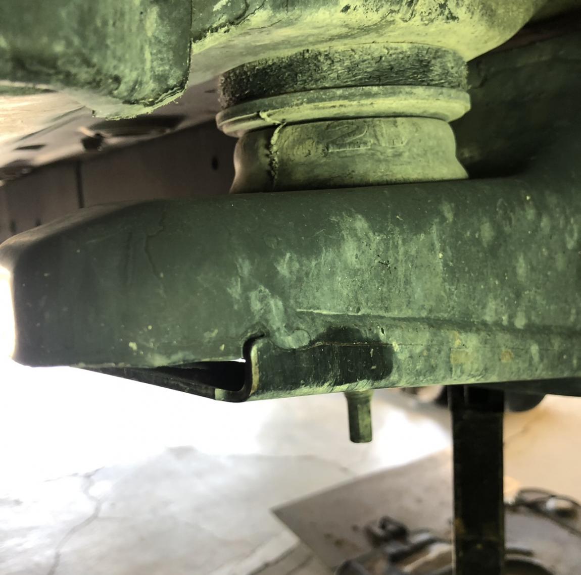

Right side body mount chop. Never had much of an issue hitting that side but on the last two trail rides it hit several times. Glad it’s done.

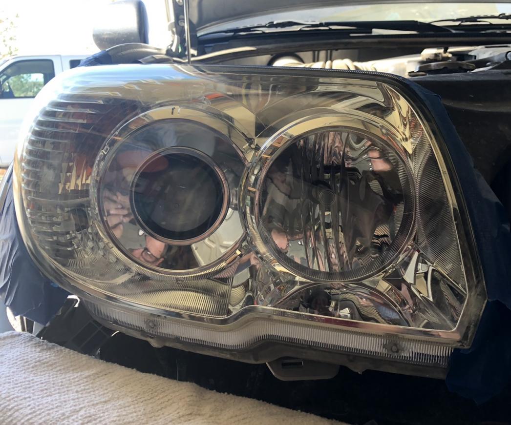

Headlight restore using the Mothers restoration kit. These haven’t looked this good for years. I wet sanded the lenses using 2000 grit then 3000 grit and only used the foam polishing pad and compound in my drill instead of the 800 grit, 1500 grit and 3000 grit pads the kit came with.

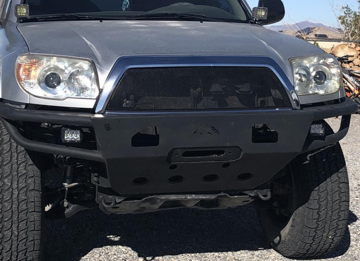

My 1st attempt at a flush grill mod. Kinda turned out lame but oh well. The plastic grille was starting to fall apart. The mesh is used is 1/8” diamond mesh used for security doors I think. Idk it was in my dads shop. Also peeled the plasti-dip off the chrome surround.

Headlight restore using the Meguiars restoration kit. These haven’t looked this good for years. I wet sanded the lenses using 2000 grit then 3000 grit and only used the foam polishing pad and compound in my drill instead of the 800 grit, 1500 grit and 3000 grit pads the kit came with.
Clean! Next time try this method.
The BEST Guide to Restore Headlights PERMANENTLY! - YouTube
I did mine this way and I haven't touched them for a couple years now. 2K clear is the shit!

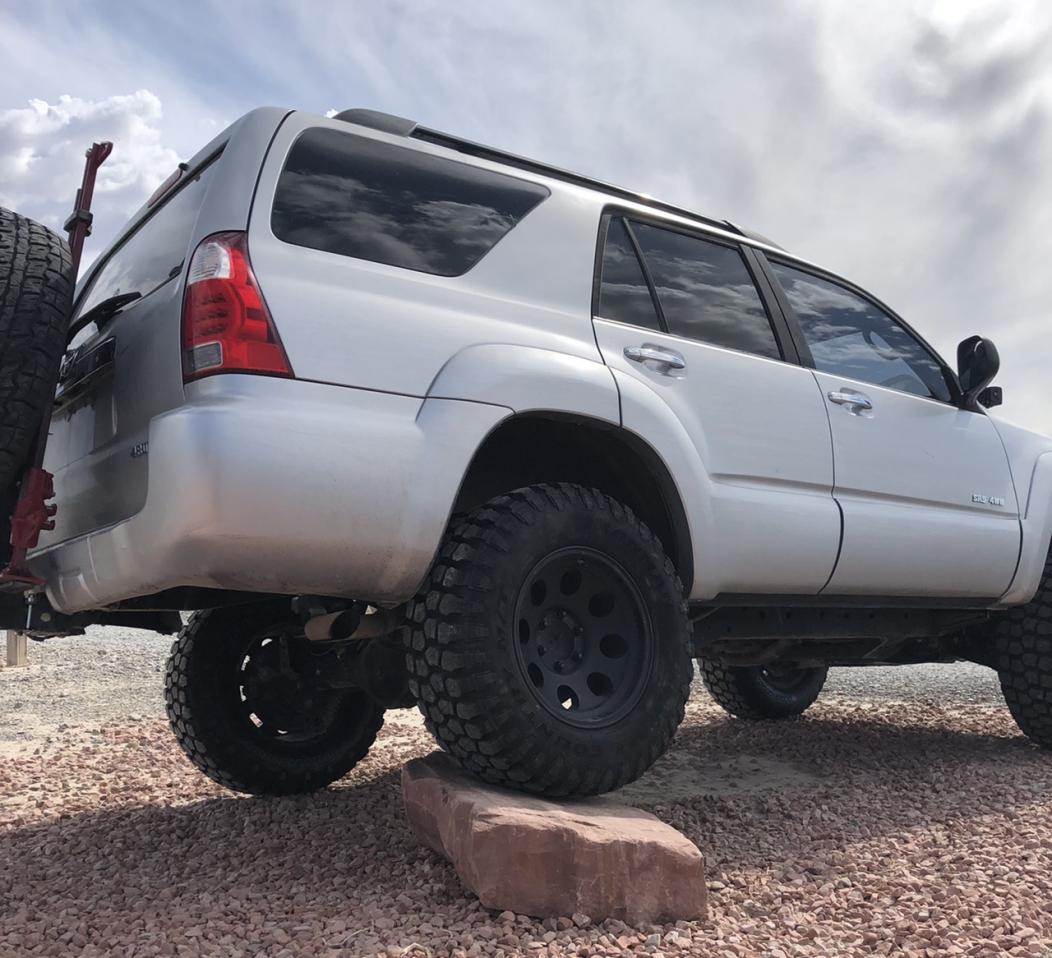

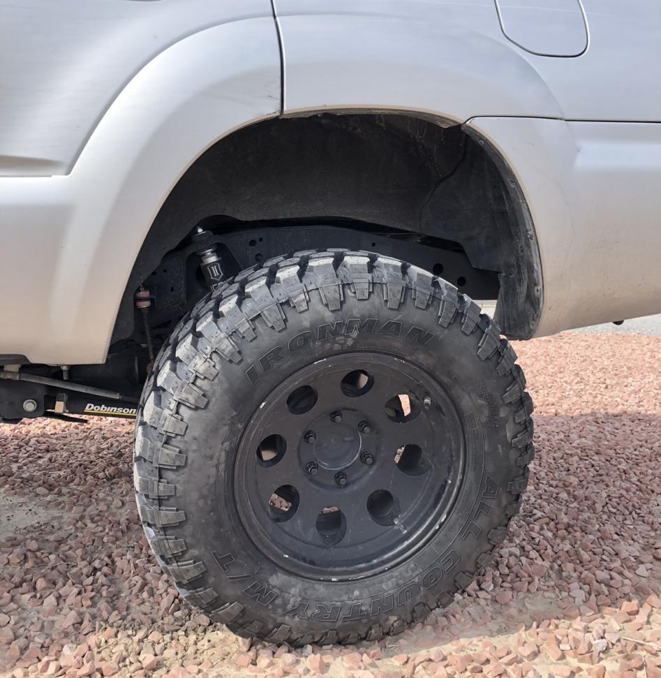

New shoes and alignment today.
285/70r17 Ironman All Country M/T
I told my wife I’m parking on these ugly pink landscape rocks from now on lol:der:

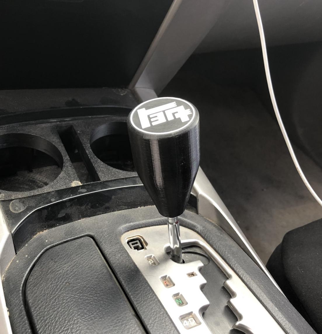

3D printed shift knob. Thanks [MENTION=83833]thegame7[/MENTION]
Yeah dude it turned out killer. Thanks again. Wasn’t sure if you wanted me advertising where I got it or not.
I like the cup holder. Since you can print your own you might want to play with the cup opening sizing. I got mine with equal size openings. It’s definitely better than the lame stock one.
Yea I don't mind, put it on blast! Good to know on the cup holder. I'll have to see if they also posted up the CAD file so I can manipulate it.
