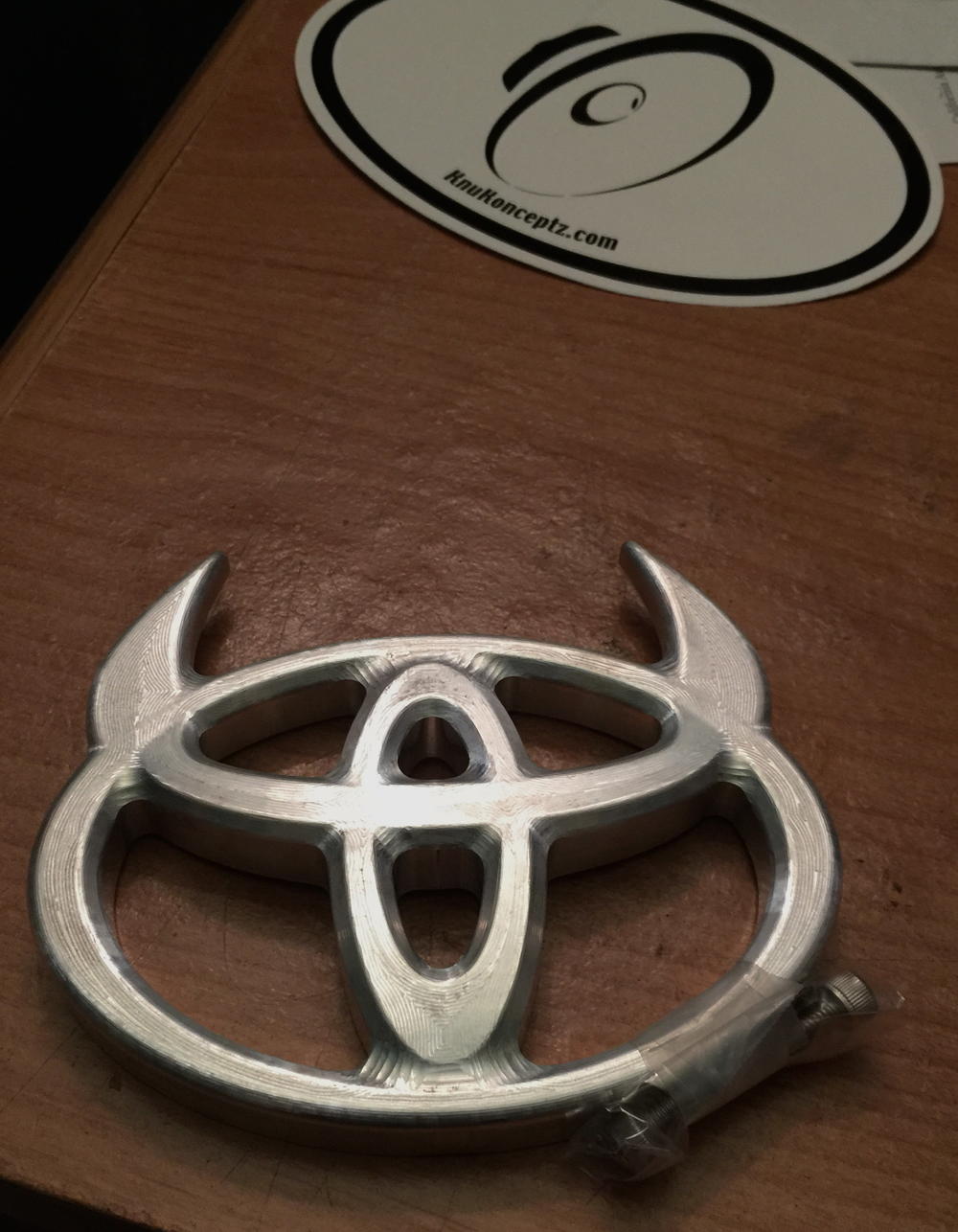

Devil Horns
New Emblem!!!! "Devil" Horns...
hoping to Line-X but for now a nice coat of red plasti Dip should do the trick

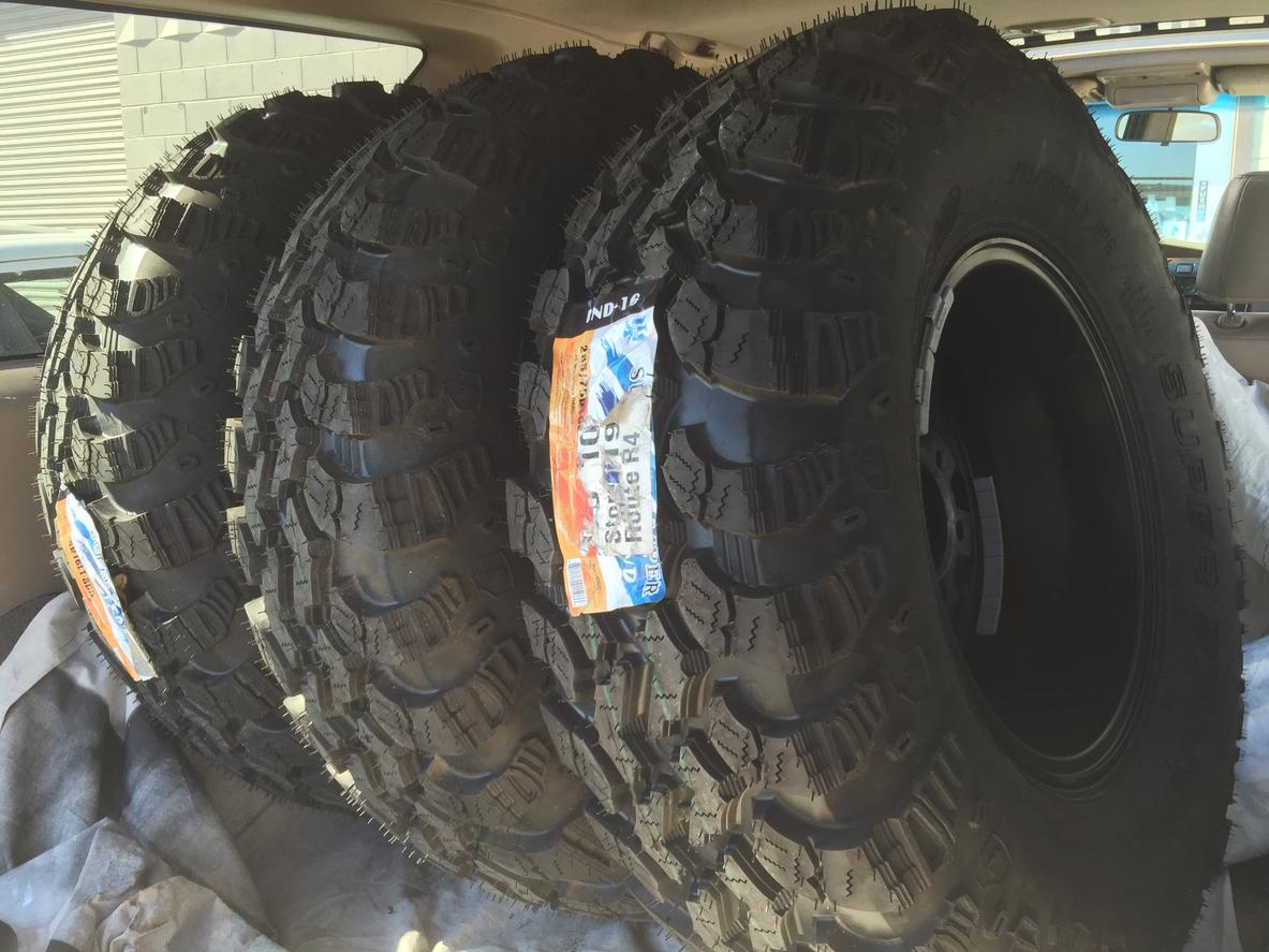

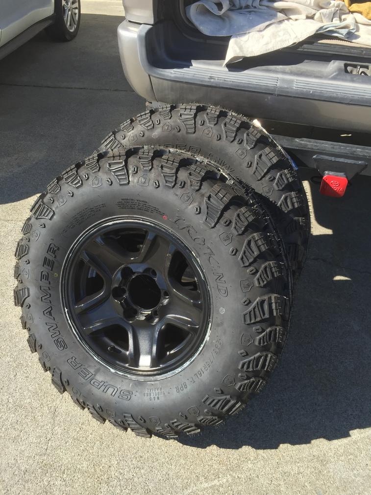

in other news i finally got my IROK super swamper's mounted and balanced on my 5 star rims that i FINALLY finished painting after a long arduous battle with sanding and spray can painting.... definitely going to just bite the bullet next time and have them professionally painted or power coated.... just honestly not worth the hassle it is to prep and paint IMO...

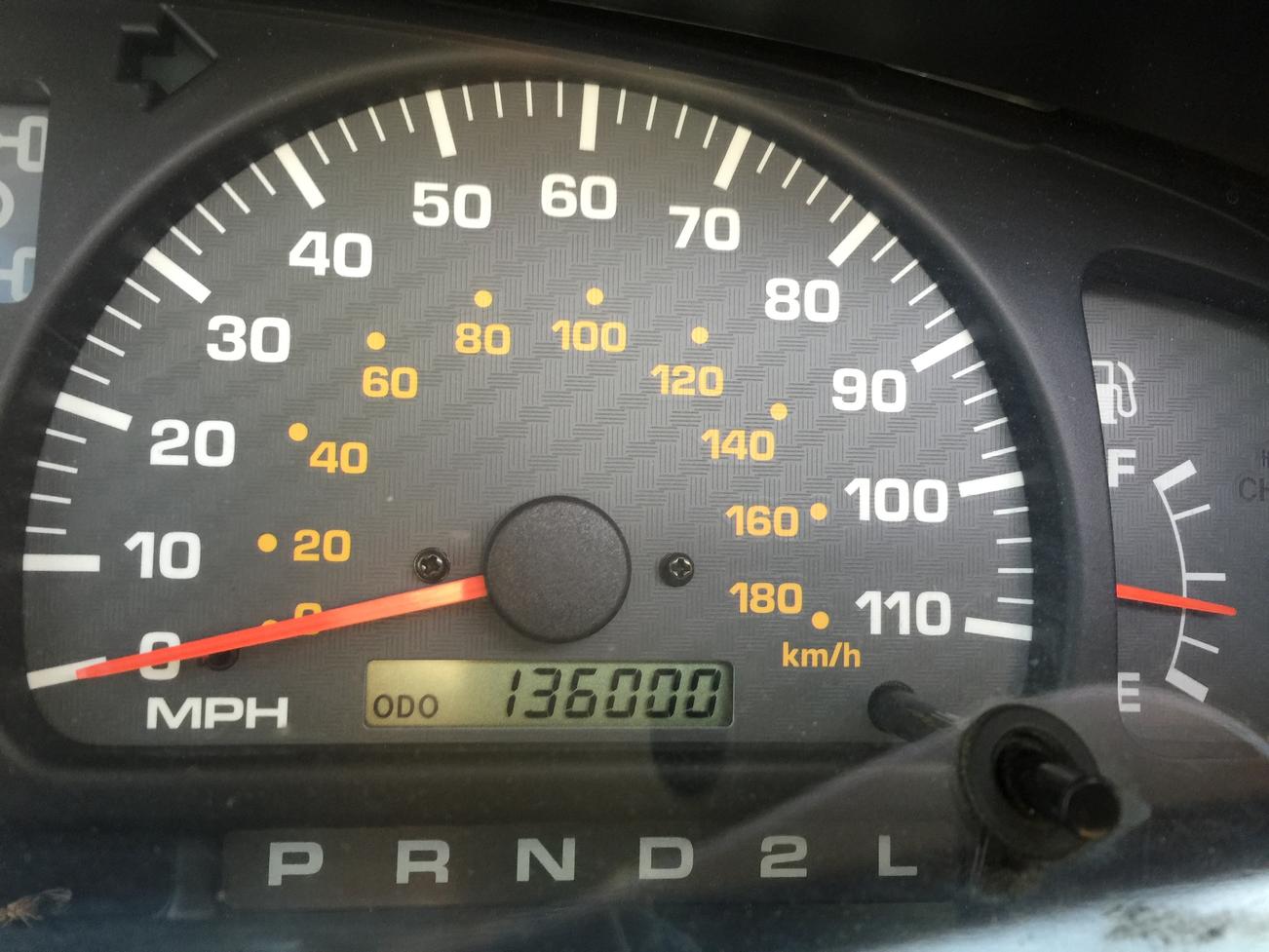

also hit a cool mileage recently. . .

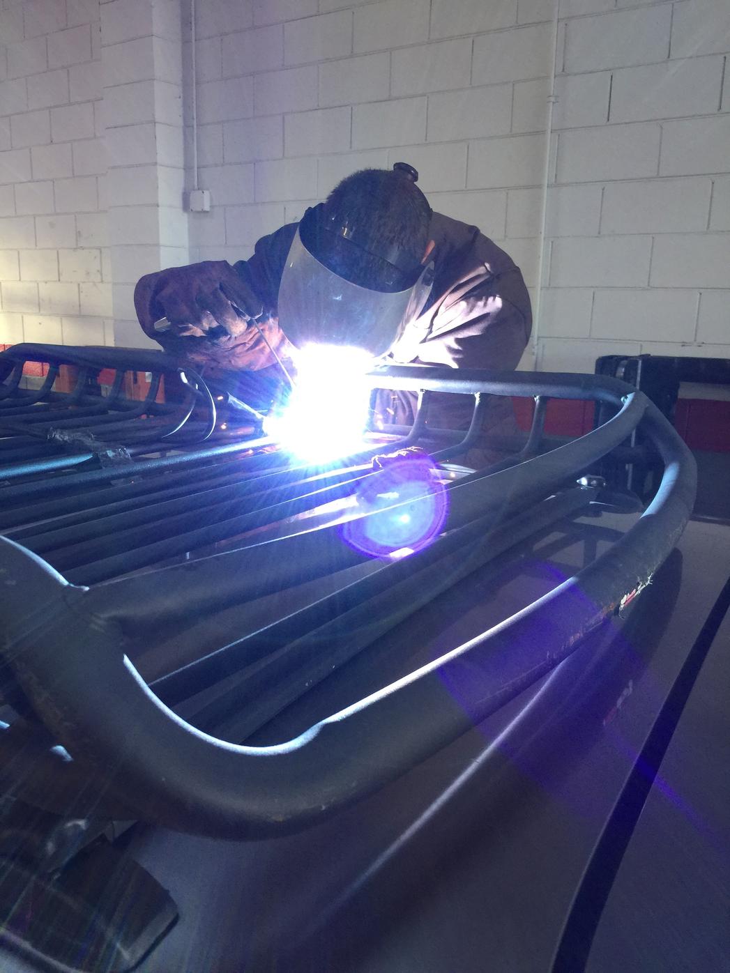

had a little playdate with [MENTION=100687]Konkordmusk[/MENTION] at my place and went to his work place to have a little welding action on my Rola roof rack to add a couple more mounting tabs for support.....

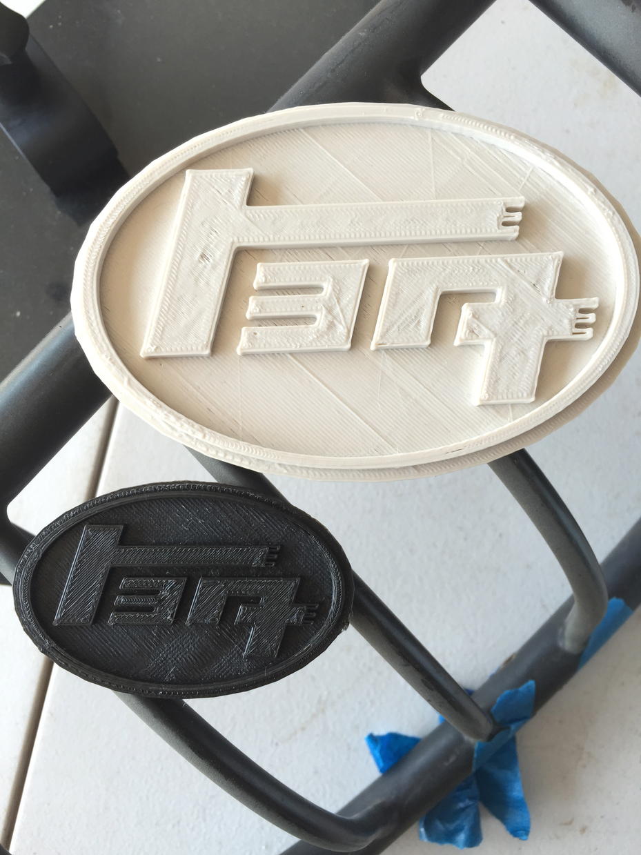

got some TEQ badges 3d printed for the rear hitch "toyota" logo and the grill's front "toyota" logo...
after some paint they should look good...
had them printed the same exact size as the logos mentioned for an exact size replacement.

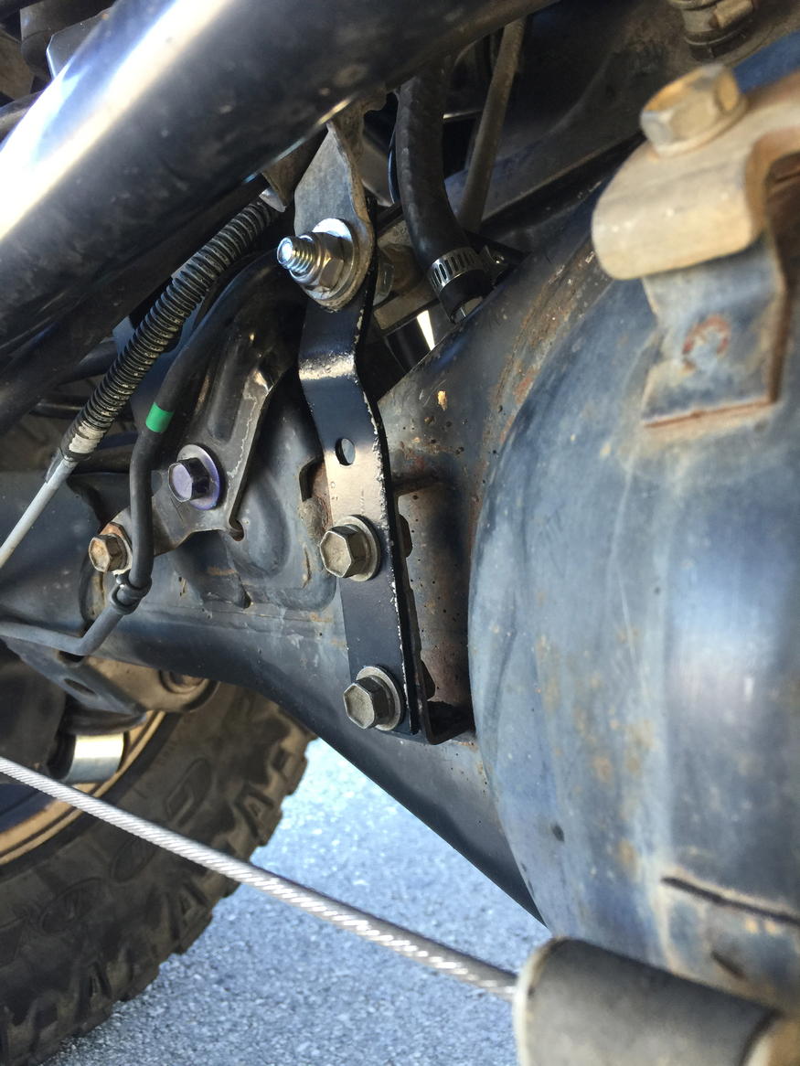

E-Brake Extension

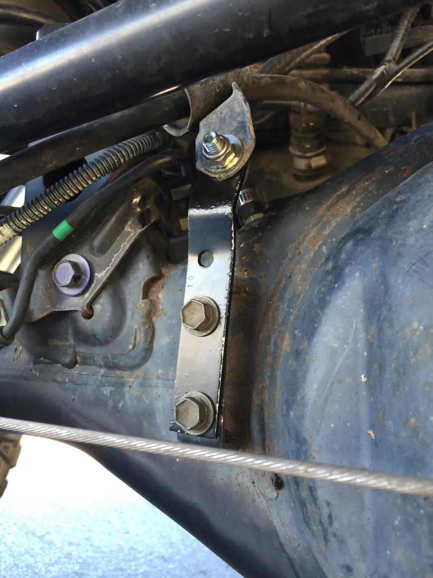

worked on my emergency brake bracket extension.
just got a an "L" shaped bracket that was laying around, bent it as straight as i could... and chopped one end off and drilled some holes...
used the spare tire bolts for the axel and got some other hardware to secure the e-brake cable bracket,..

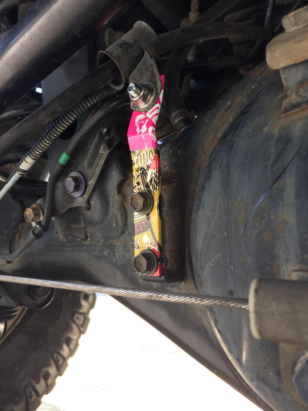

so i got this sticker bomb theme goin' on so i did my E-brake bracket. YOLO.

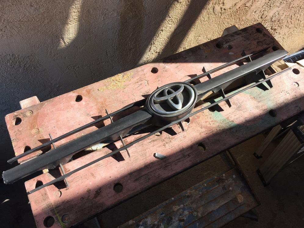

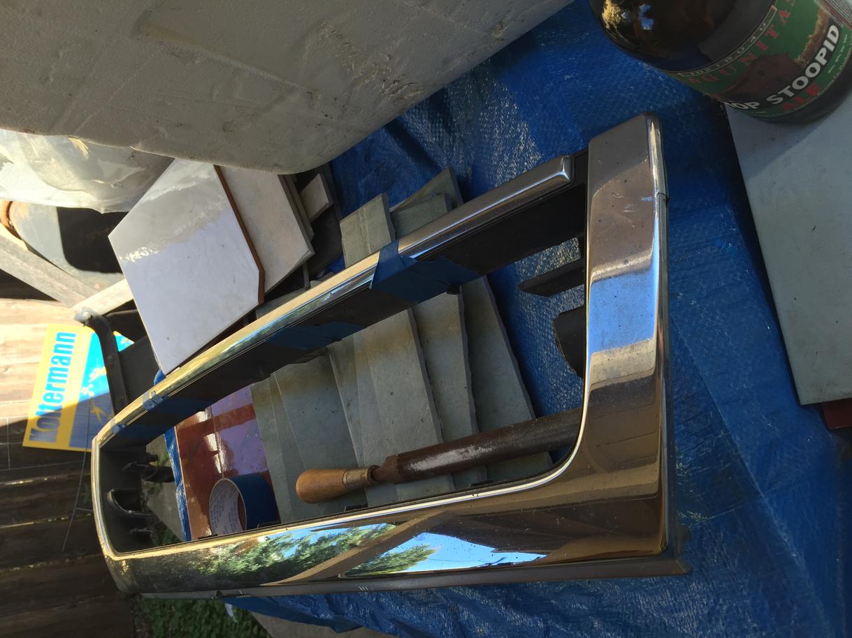

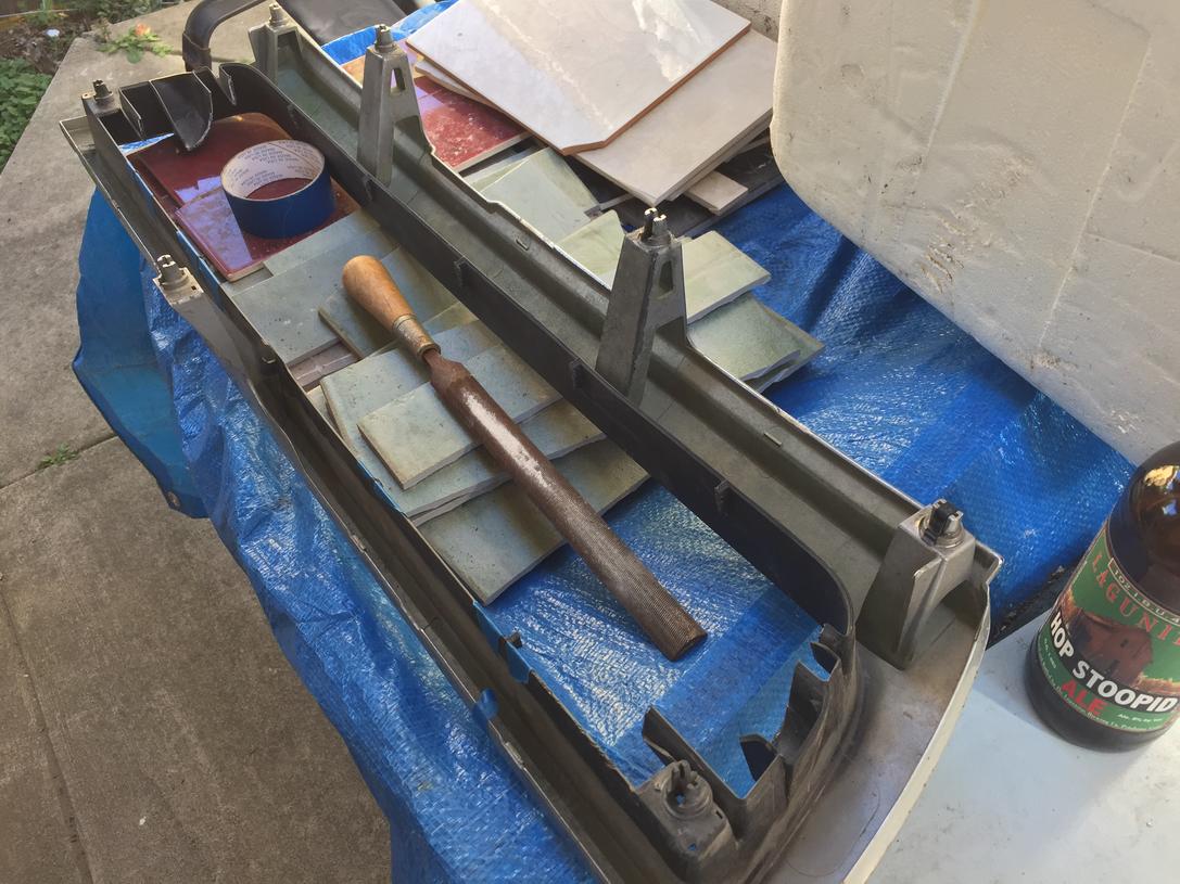

i've been working on my satoshi style grill.

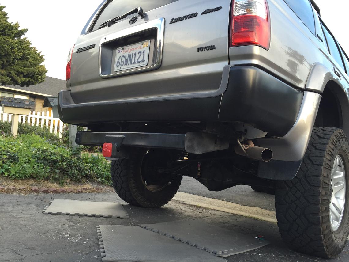

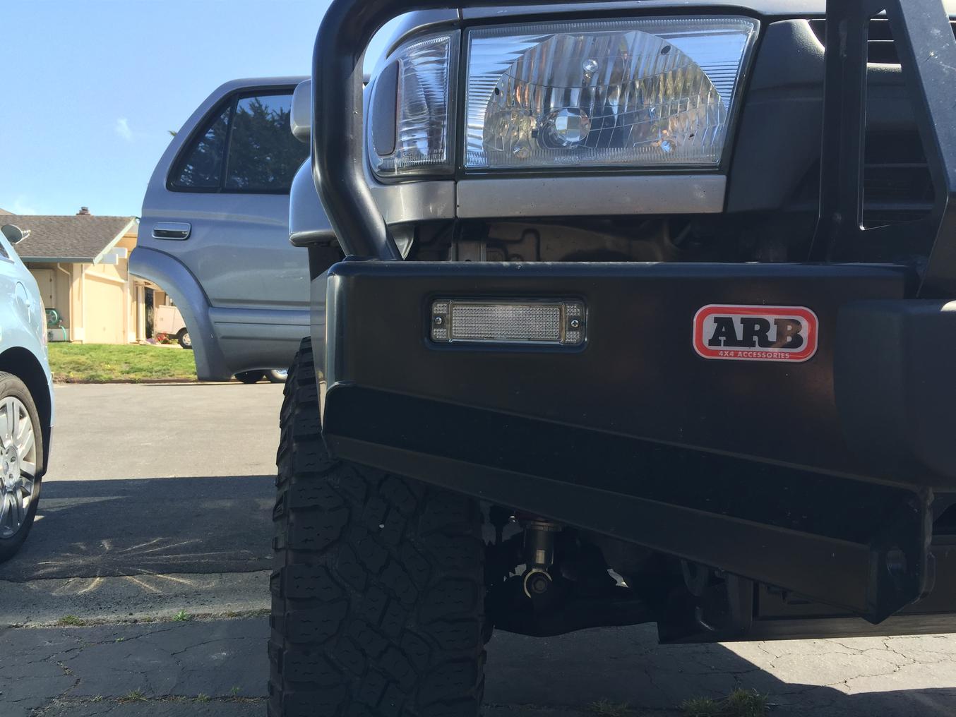

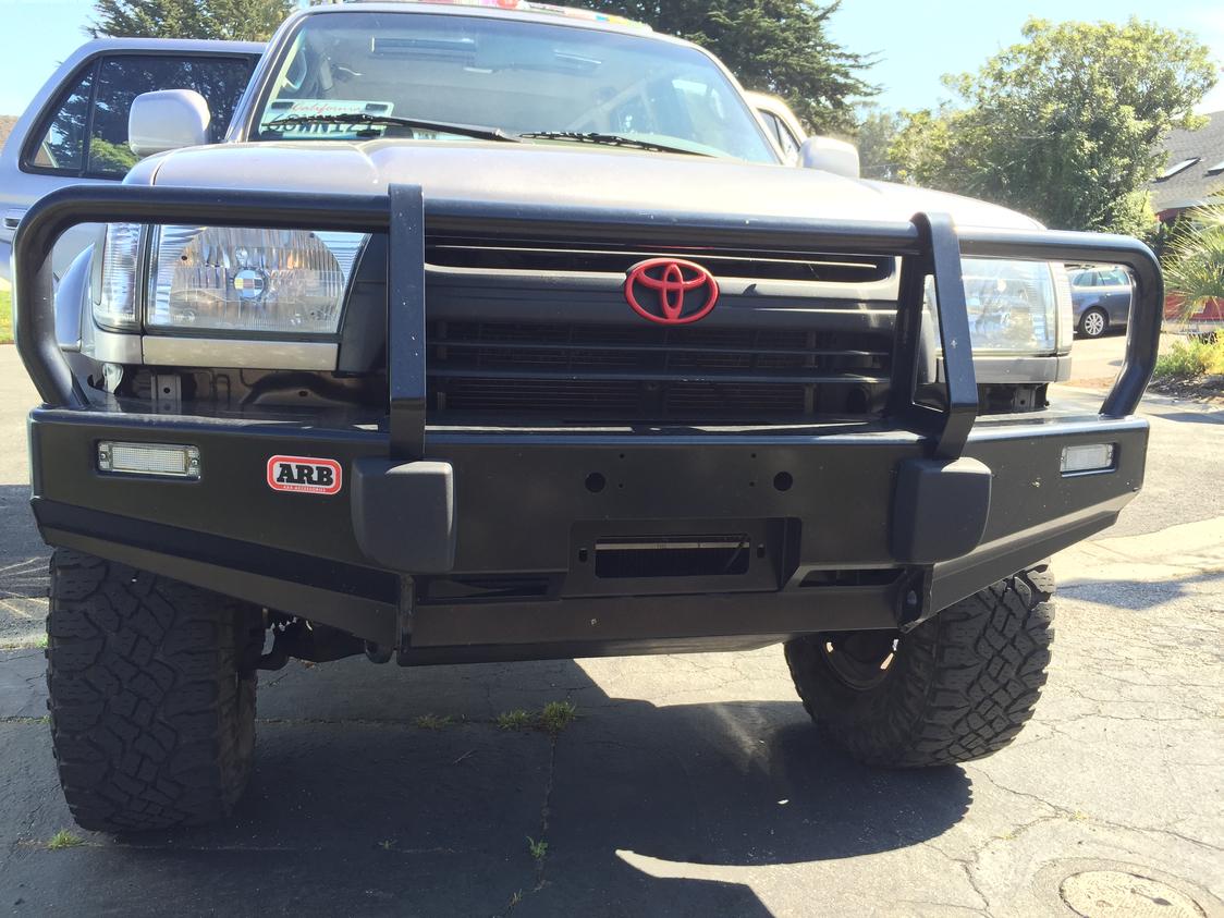

so the other night i ran out of gas... had AAA give me some gas at a painful $12 for 2 gallons.

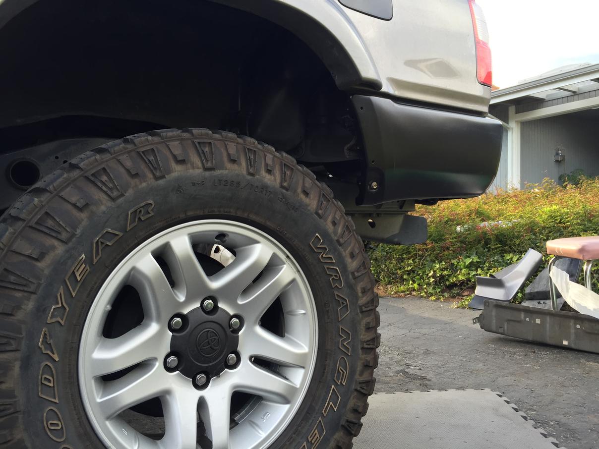

i got a rear bumper from [MENTION=82223]mud dawg[/MENTION] (thank you for the awesome packing job)
powdercoated ARB black to match my front bumper.

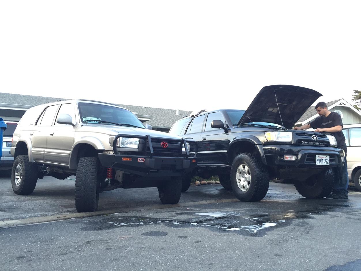

it's great to get some 4runner owner's together to wrench a little and talk yoga
here's a little video of the members that were able to join us that day...

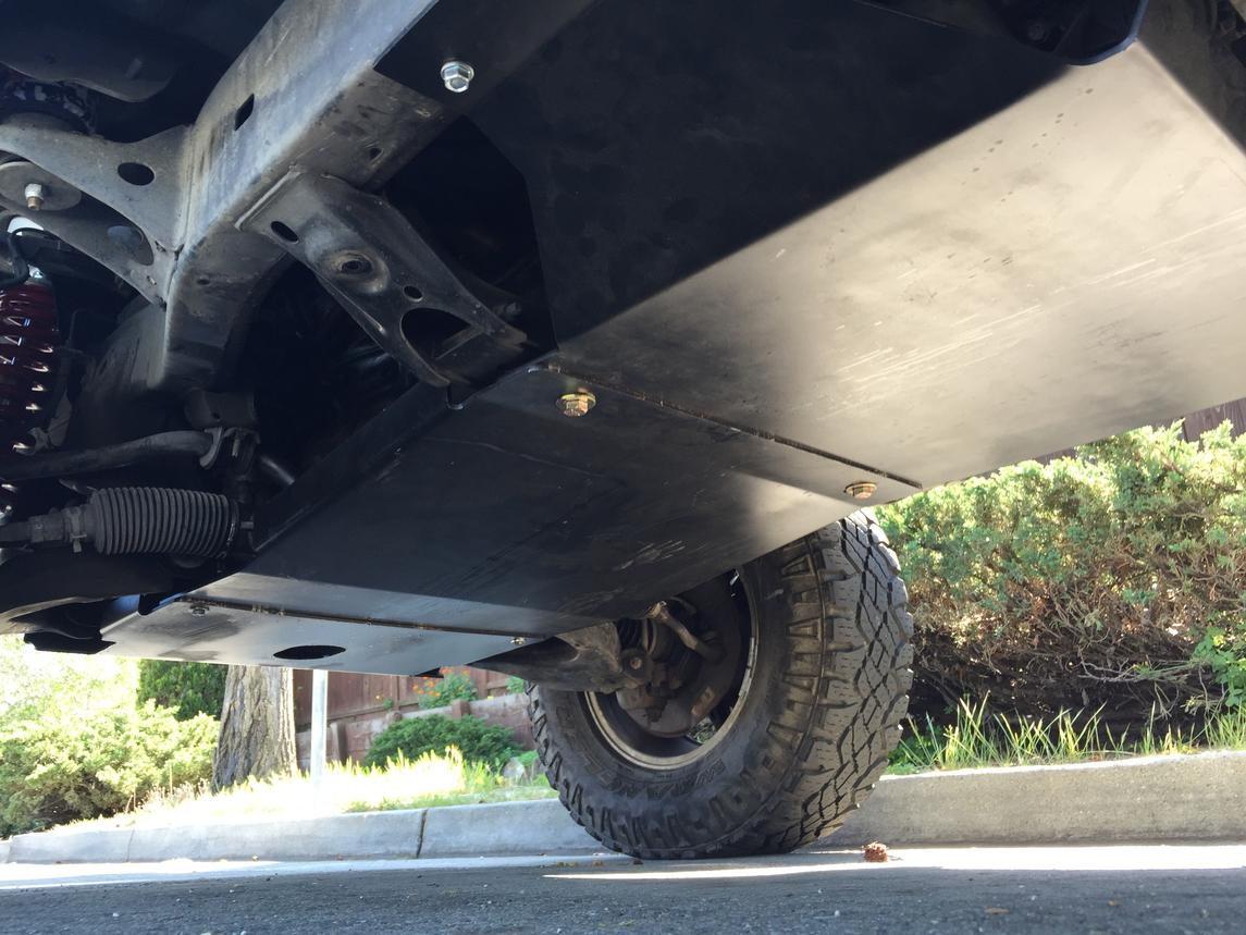

got my armor on... some underbelly skids... 3 piece from a group buy on here quite some time ago now...

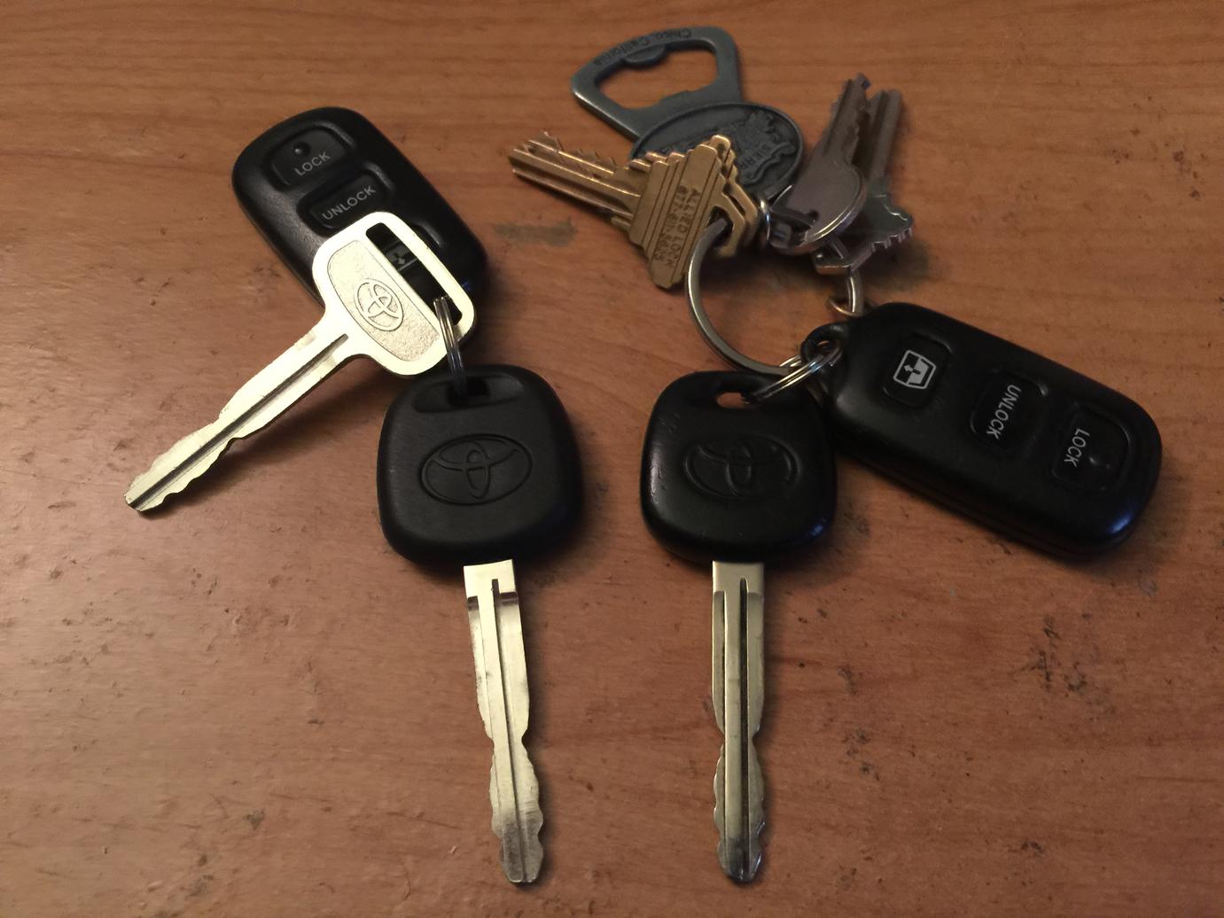

also programming my transponder key which i was pretty psyched about..
i had previously programmed the fob. i did a little write up to help others program their chip/transponder key that i got from a youtube video
http://www.toyota-4runner.org/3rd-g...onder-keys-chip-keys-oem-toyota-ignition.html

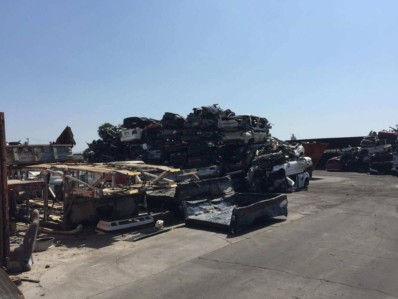

this weekend i drove down to LA to visit some salvage yards and pick up random 4runner parts for a vacation of sorts... lol.
i ended up finding some cool stuff but you really have to get to these types of places right when the vehicle gets there otherwise its picked to pieces.
my main goal was to find some OEM glass which i found... got the rear hatch glass and passenger side glass... mine was some gnarly swirls on it from the previous owner where they washed the vehicle's glass with something abrasive, and being that the glass is tempered, you can't polish it out..
$160 for all that glass wasn't bad though.
4runners were hard to come by and only really found a handful...
2nd gen 4runners are much more accessible but also because they are older naturally

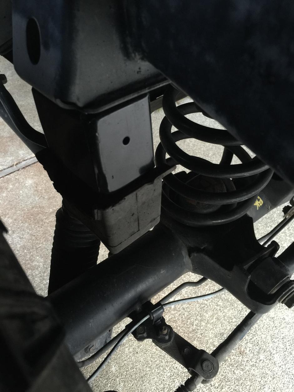

bump stop extensions w/ ARB blocks
took the square ARB steel blocks that are originally intended for a tacoma ARB bumper install (i believe) and re-pourposed them into bump stop extensions (i hope i didn't need these to install with my front ARB bumper). i used the stock bump stops.
With the help of [MENTION=53337]SCRunner12[/MENTION] & [MENTION=100687]Konkordmusk[/MENTION] we meticulously measured and determined that the perfect bolt length was an M8-1.25 x 90MM

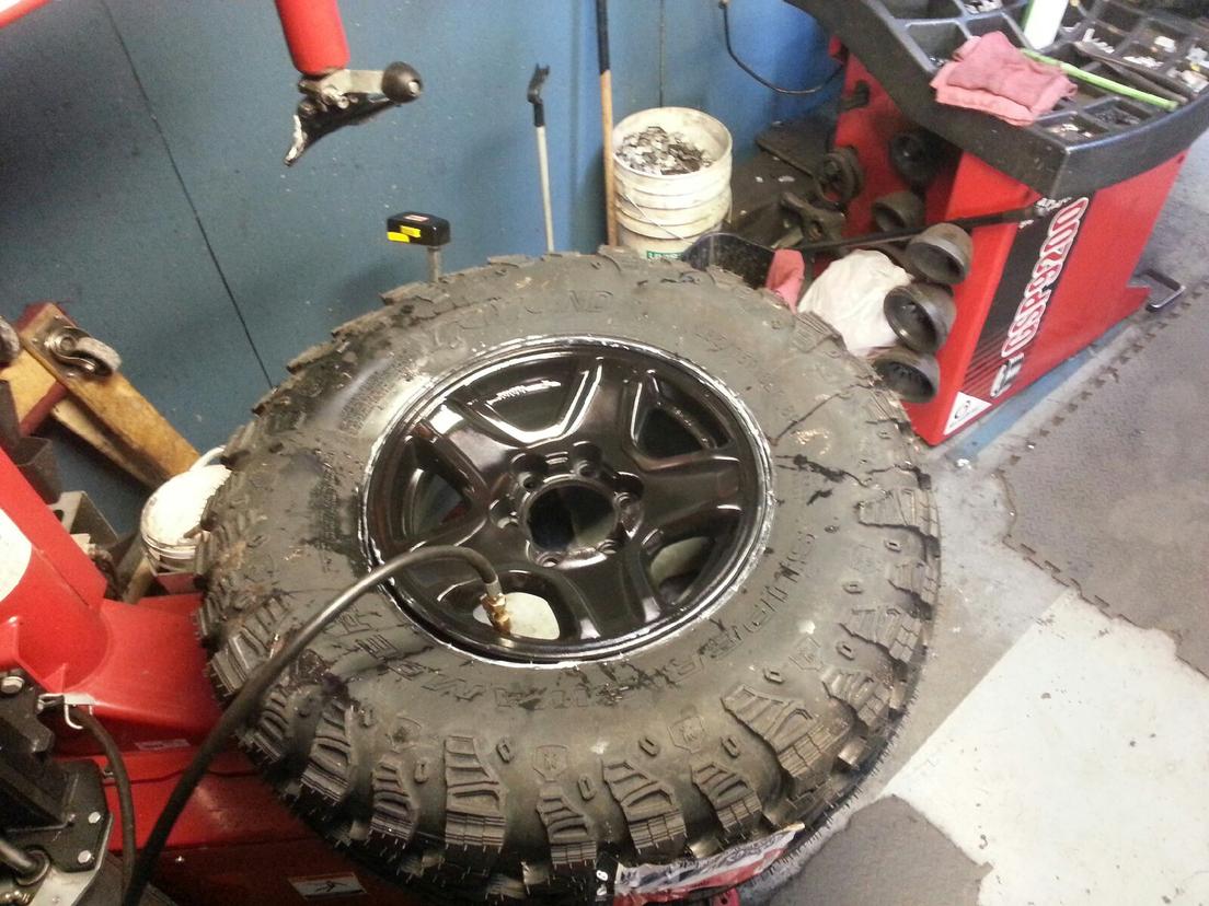

yelling at the tire to come off
struggling with the tire with my work boots , safety goggles & sanitary gloves on
SUCCESS!!!

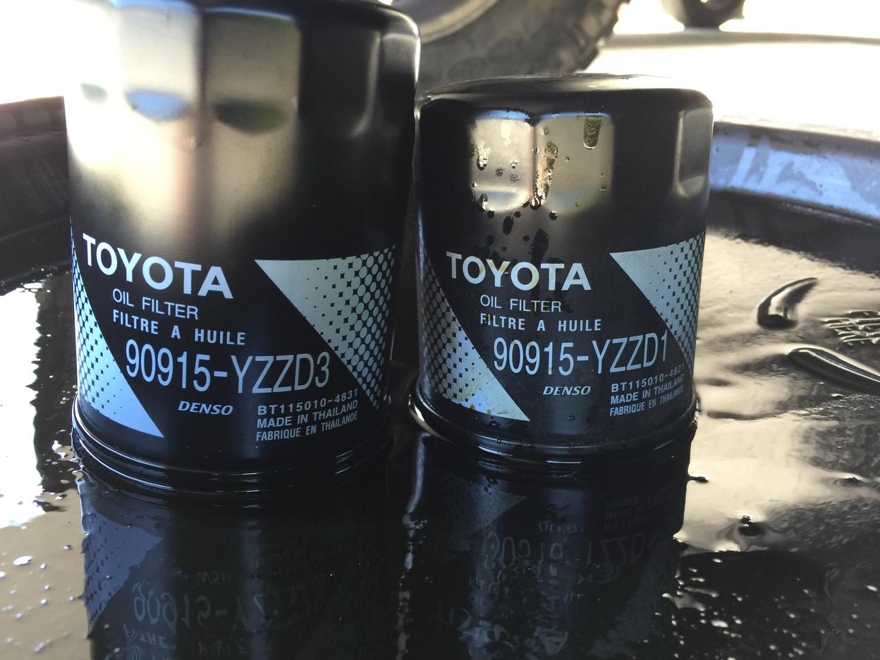

oil change 140,000
changed my oil. pretty exciting i know, but this time i got a larger filter from the dealer. +2 HP
went from a 90915-YZZD1 to a 90915-YZZD3
you can see the size difference.
im glad i got a deal on a crush washer... only $1.13 for a tiny washer.
