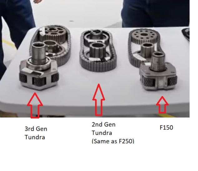

I don't think the Highlander lsd is very compatible with a solid axle. Physically it's pretty big so it would be hard to fit. It probably could be done. Most likely would be a torsen style like the Detroit/Eaton trutrac. Those work really well for an LSD. I had one installed on the front of a Toyota pickup along with a rear locker. Interestingly - functionally it was very similar in feel to brake based traction control. I do think the two would work really nicely together as well.
The bronco system is a Bosch torque on demand transfer case most likely. They work well. But they don't meet Toyota's durability requirements. The engagement is clutch based for the front and isn't able to handle heavy use. That's why it voids the warranty to use a snow plow on any f150 with the TOD transfer case. If you get the plow package it removes the TOD transfer case. To compare how Toyota specs their stuff the new tundra transfer case is a size category up from what Ford uses on the F250. Here's a picture below. I know it's a tundra. But the main takeaway is Toyota uses a higher durability level and the TOD Bosch probably doesn't meet the standard. At least not for a bof SUV.
I have the same system a the Highlander in my RX. Works seamlessly for a highway car. It has a locking center diff you can engage and I've done some snow drifting and can verify it does fully lock up. But the whole system is really light duty compared to what's under a 4Runner.
My guess is that no new AWD systems are in the works or ever well be. EVs are the future. What we have now is probably the last generation of AWD systems that aren't EV drive systems.
Yes, they'd have to beef the Highlander system up a bit to make it suitable for a 4Runner. I should have added that to the section about the changes I'd want in a more off-road oriented vehicle like the 4Runner.
Toyota is fully capable of bringing a system like the Bronco's up to their reliability standards. It might take a couple years to get the bugs out, but they could do it, pretty easily I would think.
On the other hand, you're right about EV's being the future. At this point, Toyota is likely going to skip the Bronco system and go straight to the Rivian system. Put an electric motor at each corner, have it up high and use portal axles, and you'd be invincible.
You also mentioned the Torsen style diff. One thing they could do in the meantime would be to use the Torsen center diff from the Limited in the TRD models. It's strong enough and meets the reliability standards. You have the option to lock or unlock, you don't have that option with the part time system in the TRD models. I'd much rather have the option than not.
I'd like so see a lockable Torsen rear diff as well. But we all know this isn't going to happen.
