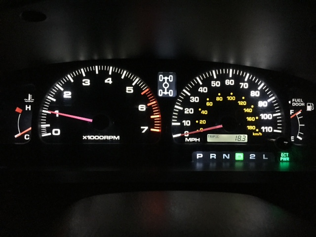

You may get "hotspots" with those #24s. Hotspots are almost unavoidable as I have them too as you can see on the picture below, however in person, they're not that noticeable. The LEDs you are going to use only have top-mounted LEDs so the light dispersion is very limited.
